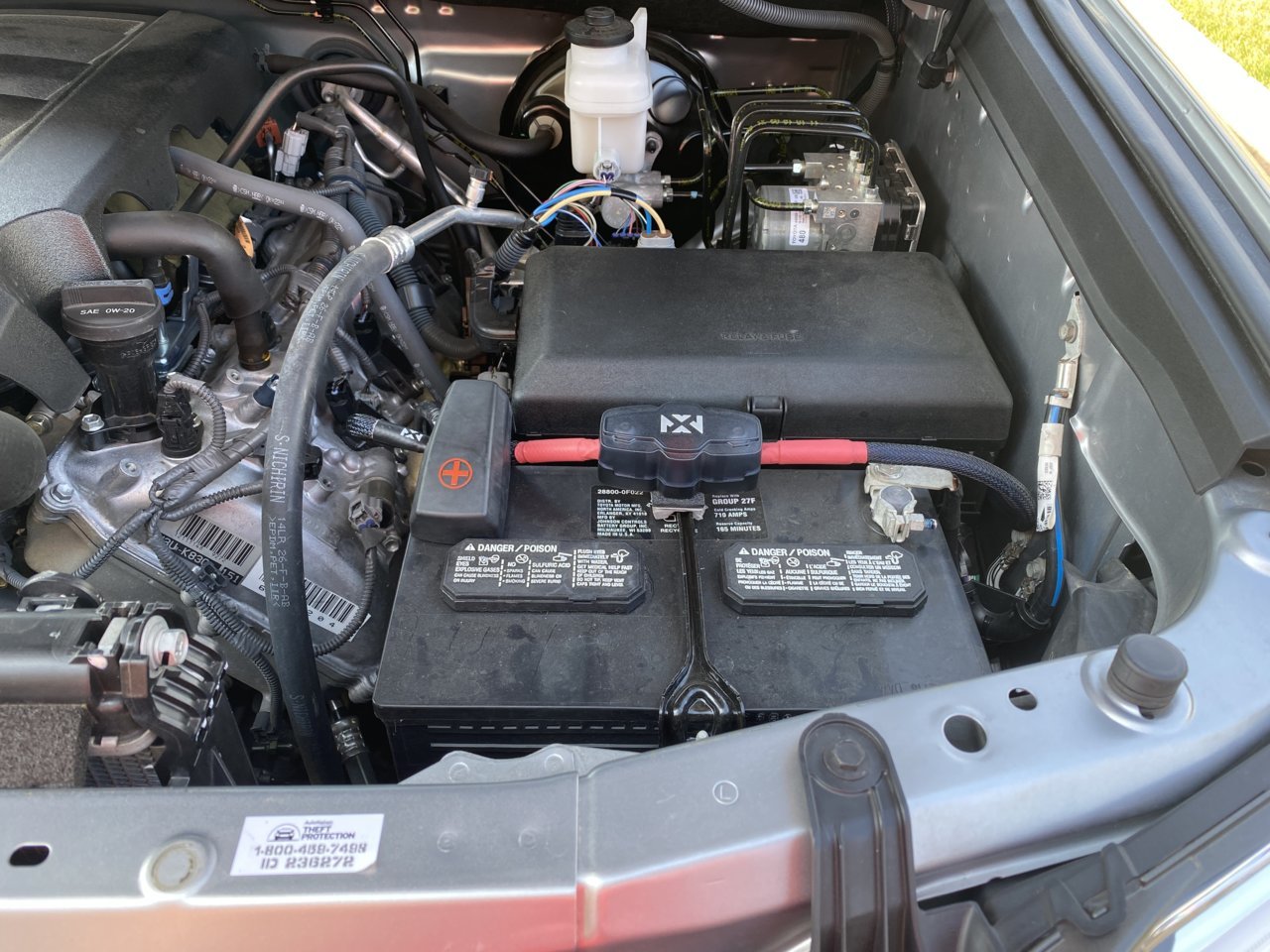

    Made a mount from 1/4" ABS plastic after watching a bunch of Five Star Car Stereo videos on YouTube.

    That’s pretty slick, I like this idea

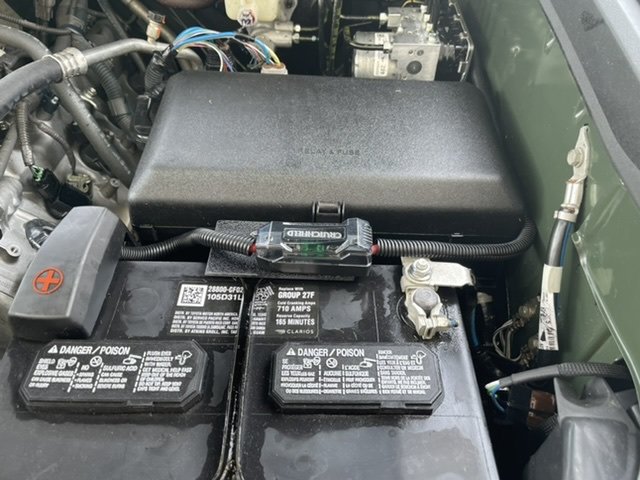

    Here is what I did for the curious. Didn’t realize the Crutchfield logo, going to flip it later.
    ABS sheet, the fuse is zip tied to it and the assembly is held onto the battery tie down with a nylock nut.
