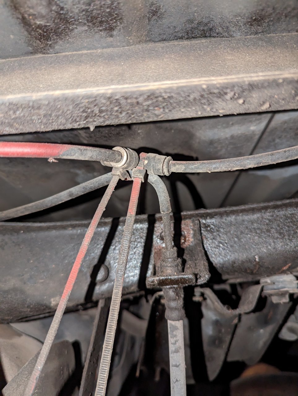

    I don't have the instructions on hand and didn't use the Google machine, but you're telling us that people to don't install according to instructions and T it even though there's likely enough line to do it independently from compressor?
    Wonder how mine were done years ago? They lose pressure over about a day so.i.have to get them back to 10lbs when I think about it. Guessing I have a bad connection somewhere

    Indeed. Your leaking somewhere. Mine are like tires, I only need to top them up a few times a year, or after letting out the pressure on purpose.
    But yes, there are various examples of people who T them together....which undoes most the anti-sway benefits of airbags.

    Well shit, look what I found...so there should have been 2 lines coming directly from compressor? I'll look under hood in am when light..

    I don't use a compressor...my air bags are just plumbed to standard schader vales that I mounted on either side of my license plate.
    They do make on air compressors with two circuits, and you can rig a valve to isolate the left and right even if filled from the same source.
    But either way, air bags work a lot better to reduce sway when the left and right are separately pressurized.
