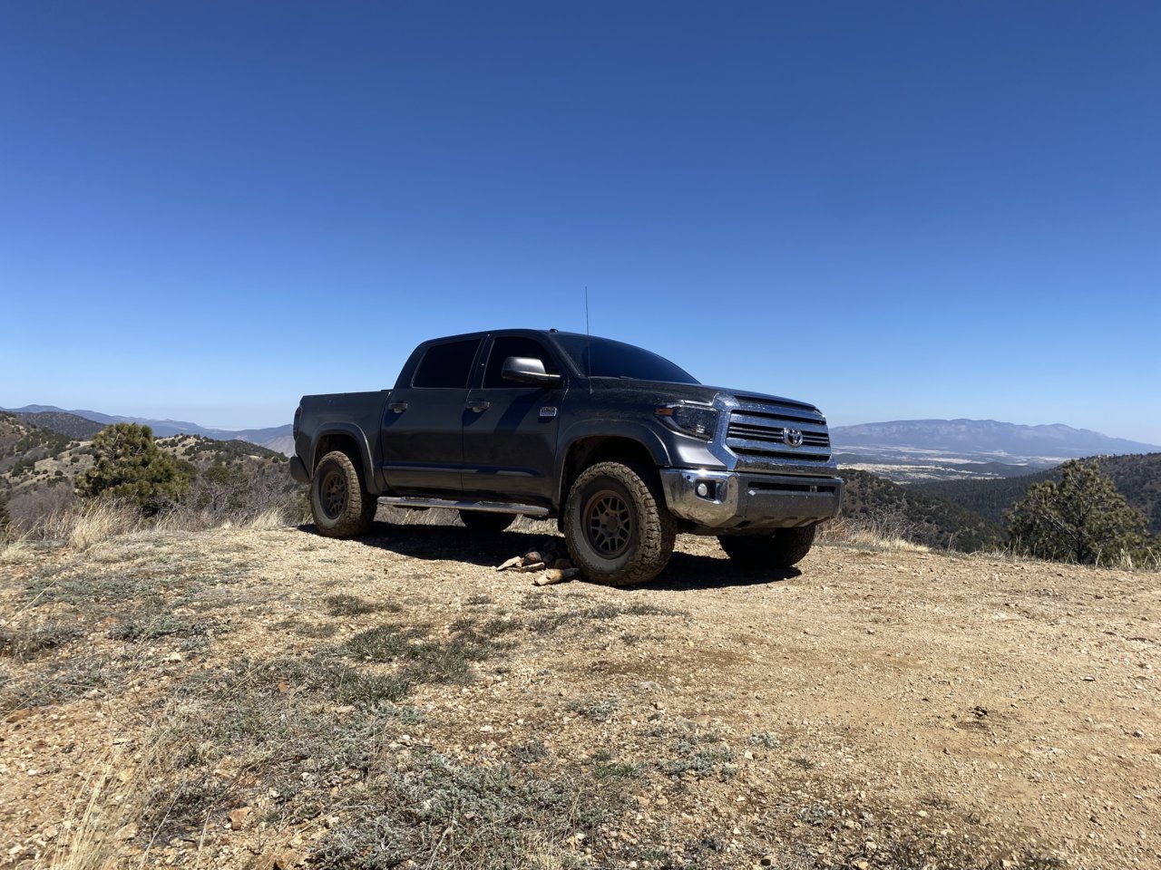

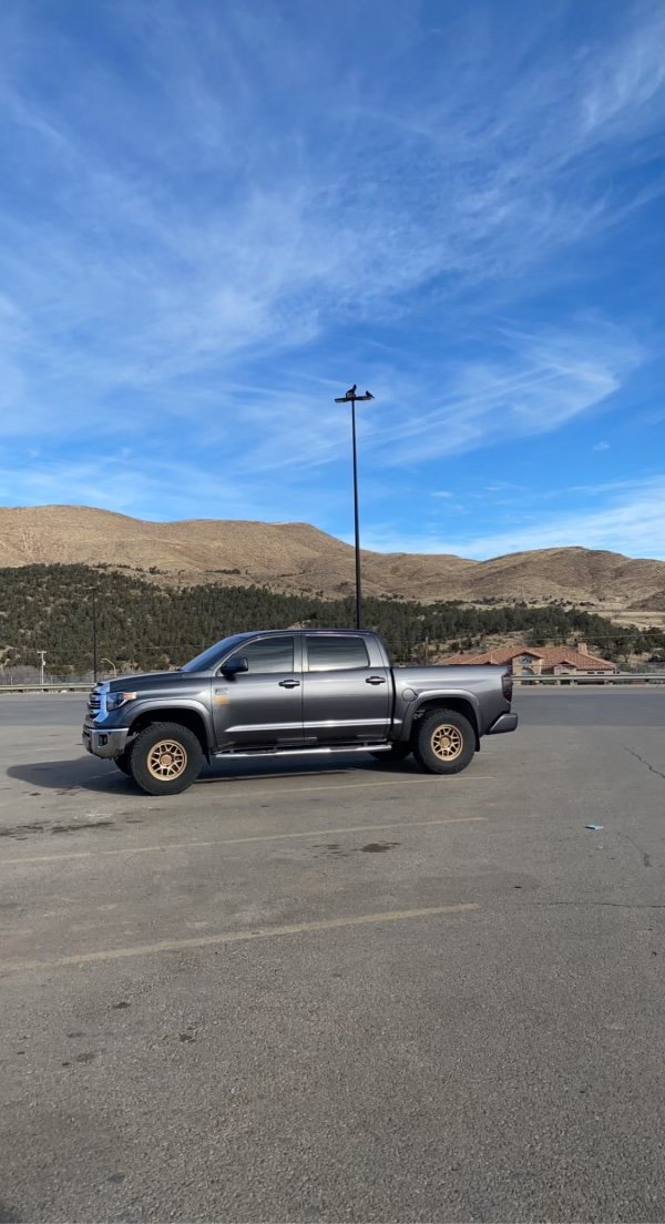

    Here’s what a tundra with about a 3inch front lift looks like with nothing in the back 17x9 +25 offset and 315/70r17 minimal trimming. The first pic is before kings and second is after. For what’s ifs with kings ride 1000x better than a spacer liftB9B93DA0-806D-4CD3-A930-79EBB7F7CE07.jpgF16CC0B7-55A1-4C98-9F3A-221069DCF6E1.jpg
