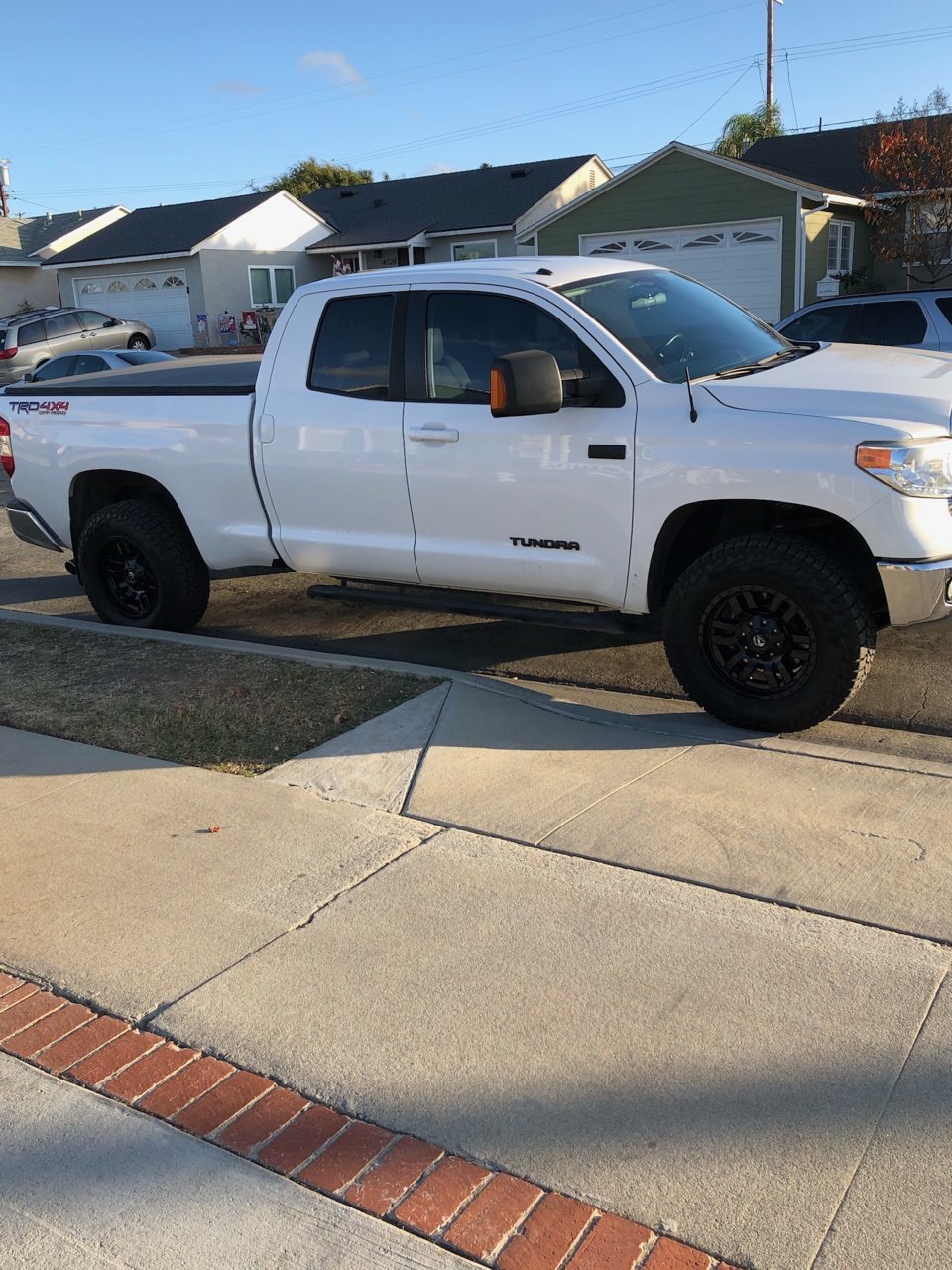

    I run 275/70 18 tires and I’m looking to add some FUEL wheels 18x9 with a - offset. Either -12 or a -1. I want the wheel to stick out a little and I believe the -12 gives me an inch out. I should be ok??

    @mrmisky1969 a NEG -12 is gunna stick out further than an inch my friend. I have a zero offset and im at a 1 1/4 out of fender.

    Thanks hotchops! I went with the +1 and it’s out about 2. I’m thinking I can go with taller tires as I see quite a bit of daylight. Debating on doing Flares.

    @mrmisky1969 Looks Good dude! Yeah you might could tuck some 305's in there.
    If you did a BMC you could do 35's
