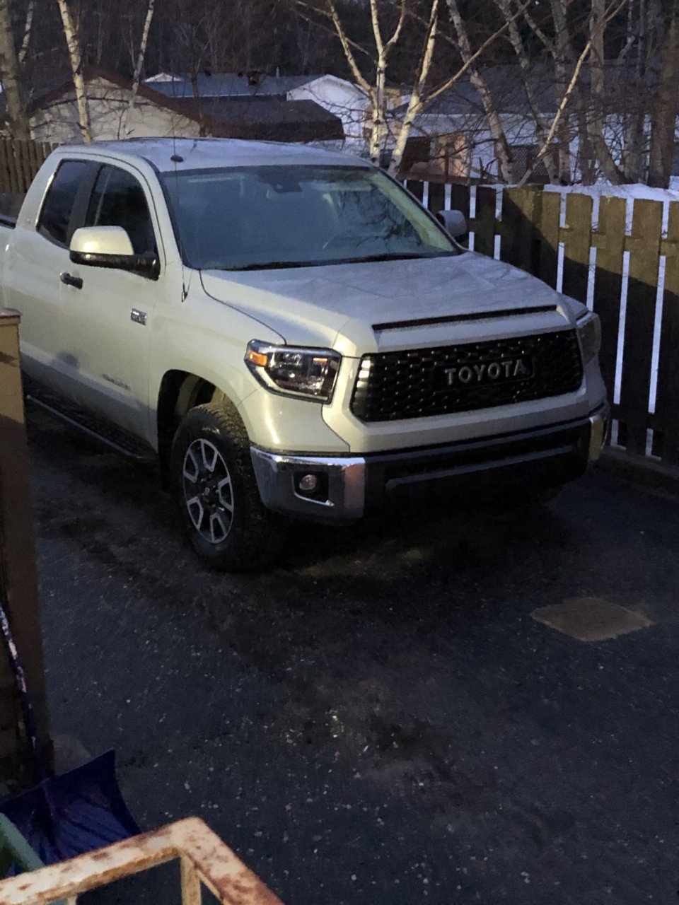

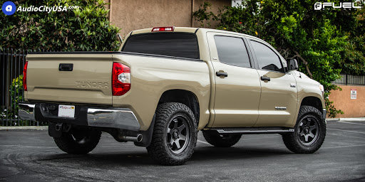

    I guys I have a trd off road 2019 I am looking for a lift and new wheels and tires. I’m looking for blistein 5100 adj and 275/70/18 on fuel d664. So my question is what did you think about this setup, how I choose between 20mm and 1mm offset and what tire did you recommend me?

    I was thinking 2,5 in front 1 in the back and 275/70/18 or 285/70/18. I can put
    +1 or +20 offset with this wheels and I don’t want them to came out of the fender

    The 5100s can def help you do that. I've got a set on our Sequoia and on lowest setting they lift .75"
    Your positive offset will most likely keep you in the wheel wells.
