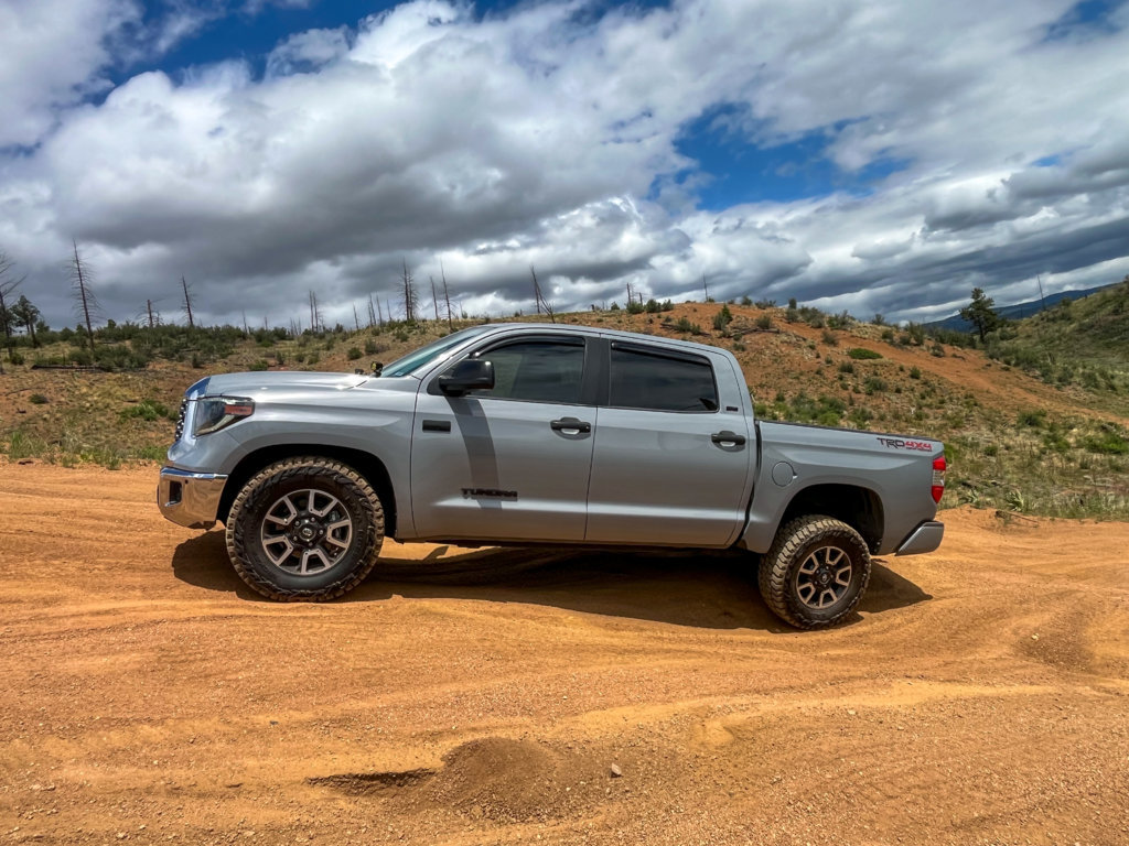

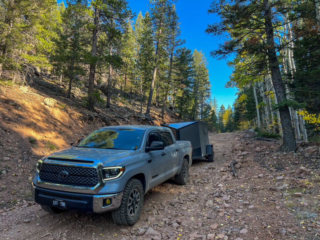

    Here’s my 295/70R18 tires on stock 18x8” +60mm wheels with stock suspension. I wheel around Colorado and I don’t rub at all, on suspension or anything.
    I did remove the mud flap and massage the front fender liner, but I’m running larger tires than you. I also just recently put 1.5” wheel spacers on and that puts me at that 18x8” +20mm offset that’s real comparable to your 1” wider wheel with smaller tires. You should have to do anything to fit that setup, worse case (based on your alignment specifics) you might have some very light rubbing in very specific situations (turning and hitting a bump simultaneously) that a good alignment or light massaging/mud flap removal will fix.
