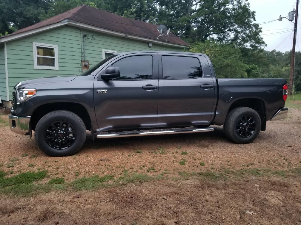

    Gotcha. Thanks folks. The guy I swapped with works at a dealership. The new wheels and tires look great! 418c24c28847b967508d3f0bc4314b7f_2c9c350c256bfab700f6c10b016ba16d075062e8.jpg

    They do look great, good score! Sounds like you two might have an easy solution to this issue then. :thumbsup:

    Yes sir. Thanks for the input. He wanted my 20 inch BFG to go with his aftermarket wheels on his pro. I dig these wheels and tires.
