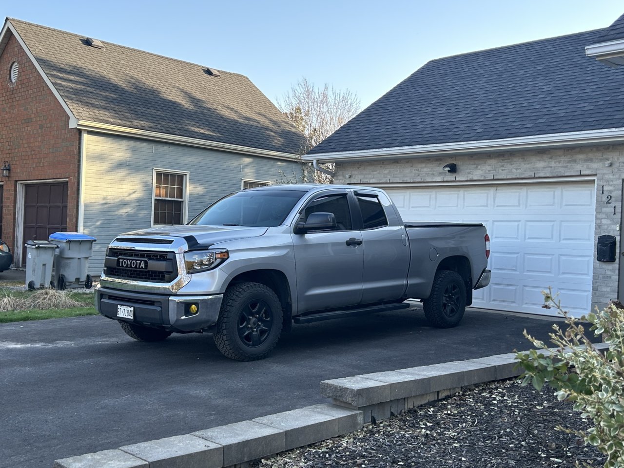

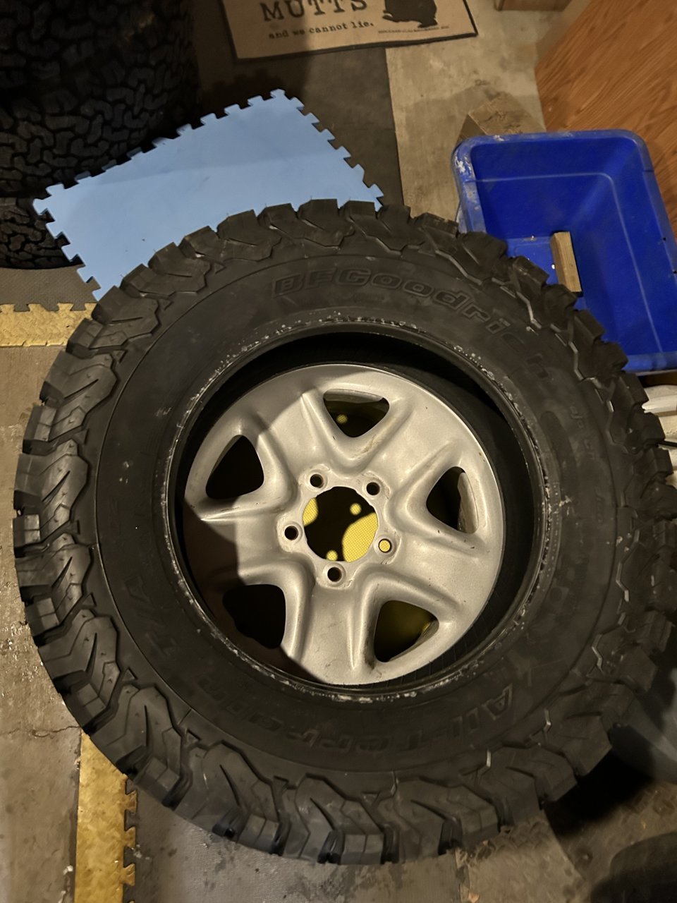

    2014 SSM SR5 DC
    Satin black roof, 18” KO2’s, satin black powder coated steel rims, tri fold tonneau cover. Led lights interior, exterior. Trd pro grill. 13” ryonnair antenna. OEM LED headlights.
    79DB3F2F-526B-4BDB-80A4-80343B861B35.jpg I picked up a set of stock steel 18” rims through a private sale. Also found some KO2’s through a private sale. I powder coated the rims satin black.. definitely a softer ride on the 18’s.. still corners fine it’s a truck after all. I can’t speak to the suspension as I won’t be changing mine from stock.. the KO2’s have been fantastic as well. Lots of co workers run them on their trucks so it made buying them easier, also the price I got for brand new was literally a steal. I plan to run them year round with 5K rotations
