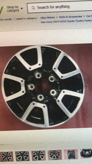

    I am replacing the steel wheels on a 2020 SR with the TRD factory Off road alloy wheel (75157B). Factory tires were 255-70-18 and looks like from threads that 275-65-18 is factory for the alloy wheel. Just want to verify there will be no fitment issue with the 275-65-18 tires that are standard for that wheel for the SR truck. Also will the tpms sensors on the steel wheel work on the alloy wheel?Wheel (2).jpg I'm sure this has been covered but I just don't have time to research threads more right now. Thanks

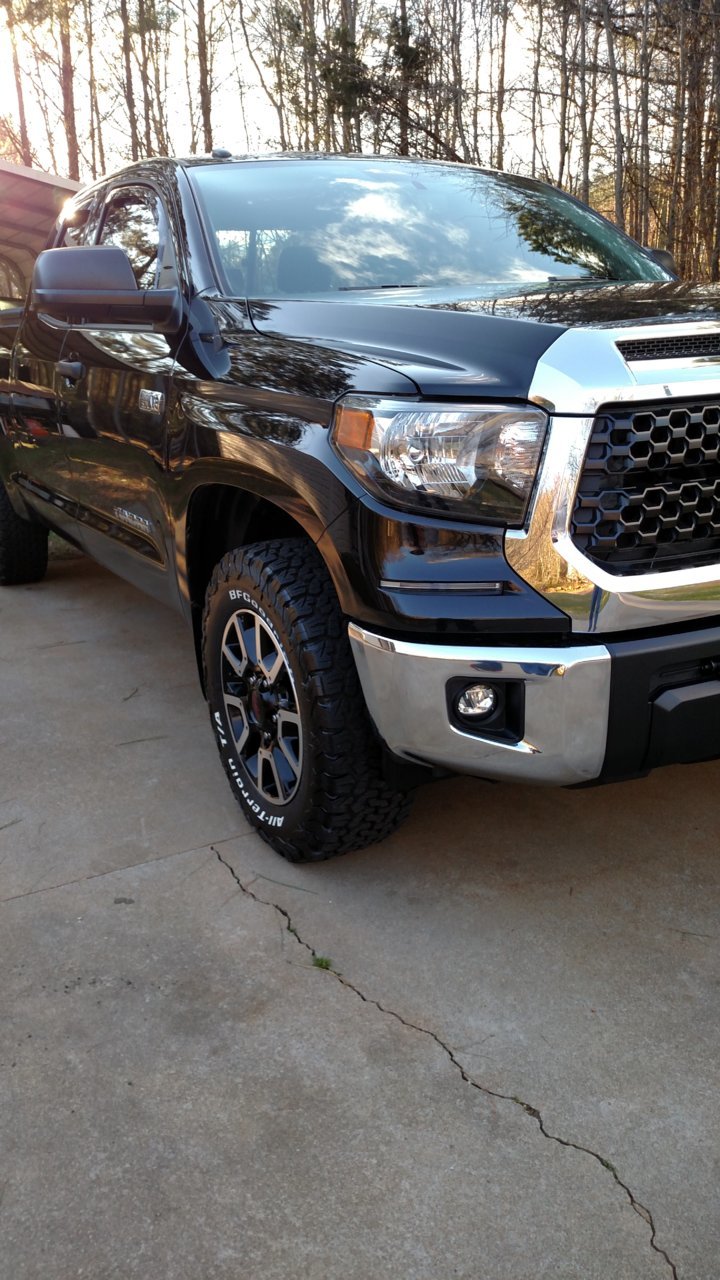

    No problems at all. That's what I'm running.
    I'm also running 1.25" wheel spacers. I've heard the tpms from steel wheels can be flipped around on the alloy wheels and work, I DO NOT HAVE 1ST HAND EXPERIENCE WITH IT. Maybe someone will chime in on the tpms question.
