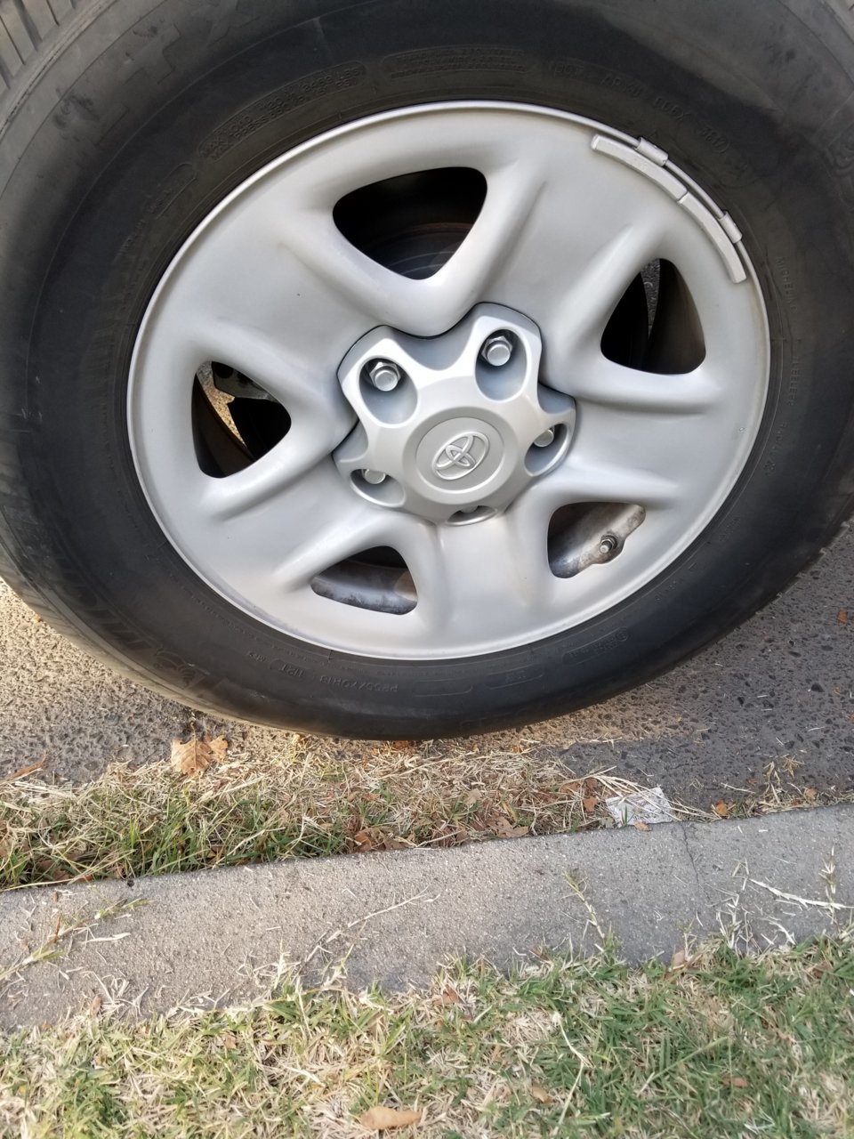

    Do you have steel or aluminum wheels? if you have aluminum then your sensors and lugs can be used with the 20" takeoffs. If you currently have steel wheels then neither will work with OEM aluminum wheels.

    Mine are the steel ones I think (in the picture). Are lugs and sensors pricey?

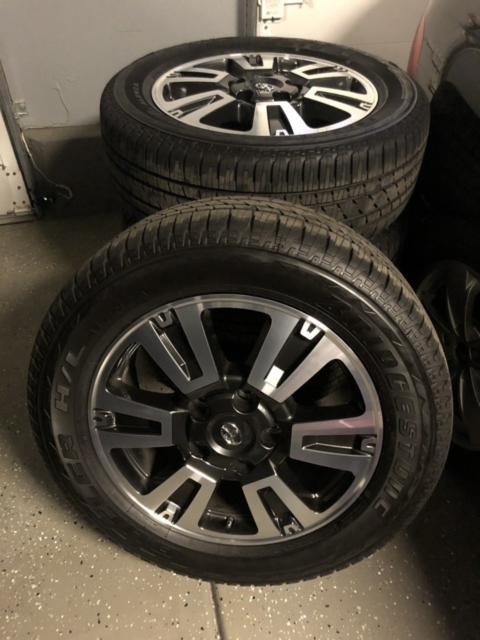

    These are the the takeoffs I plan in getting, I assume these are aluminum.

    Nice upgrade. Bet they're smooth riding on the highway. Yes they are aluminum

    Thanks, I like the 18's just fine as far as ride quality goes but these takeoffs come with almost new tires and I like the look a bit more at a good price. I'm considering powder coating them black, still unsure.

    If the seller is getting rid of their OEM wheels they probably don't have any use for the stock lug nuts. Might be worth asking for them too.
