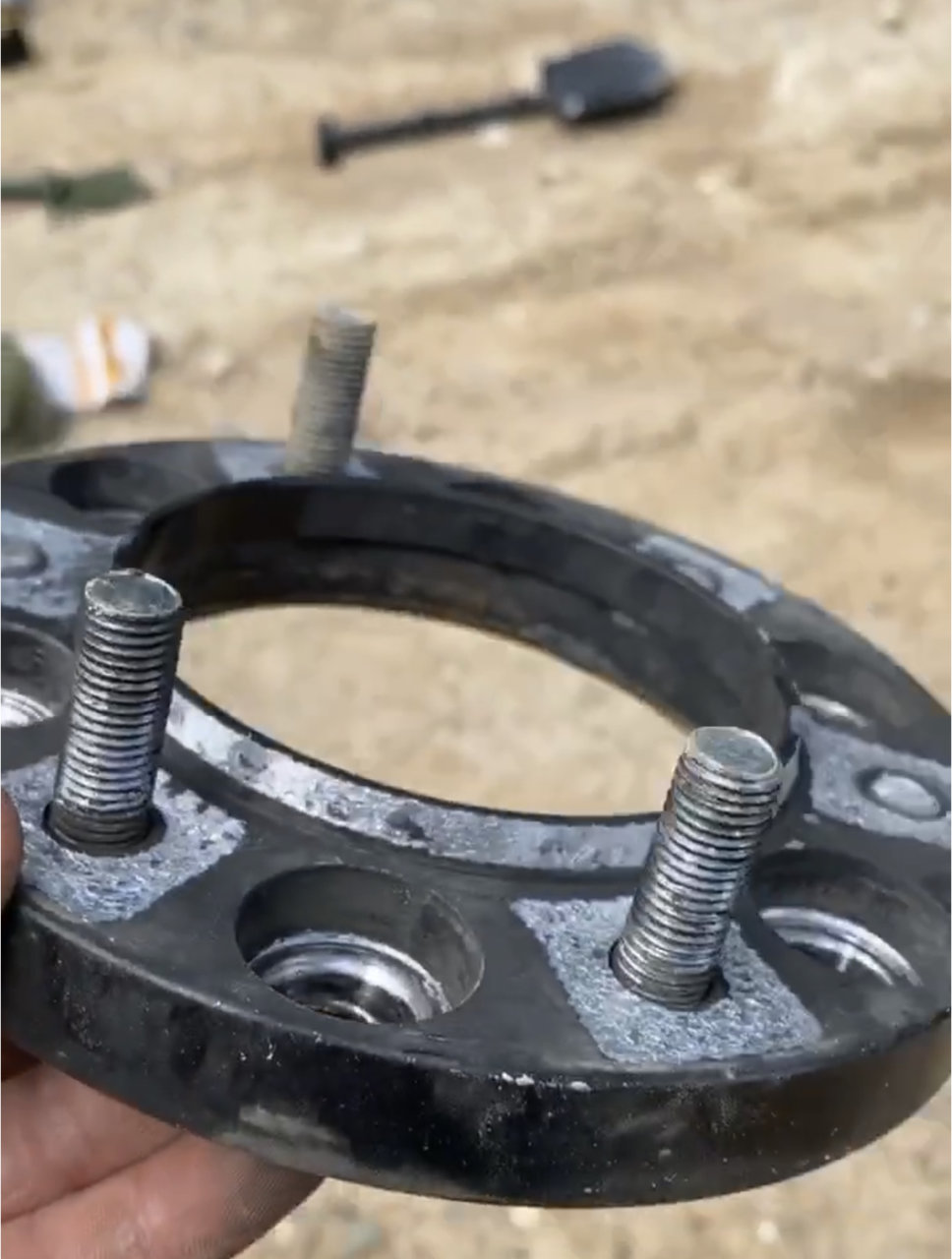

    This can happen
    Mnorris1206 likes this.

    Cheap chinese garbage. Yes this can happen with cheap spacers. If your not scared your factory studs wont snap, then as long as the wheel spacers have the same grade steel your all good. I Saw your post below and we seem to agree. Im not arguing here but I noticed a few thing in the pick.
    1. Those studds are snapped but the wheel didnt fall off. If it did how is it possible it removed itself from the 3 good studs?
    2. THe remaining studs are fine! Which means most likely that when these broke it was not a ctastrophic failure as the spacer and remaining studs are not damaged.
    3. Looks to me like an overtorque situation with cheap steel. Or maybe when they remove the lugs the studs broke.
    How did this happen!
    Really wierd pic. Think about it...

    They are bora spacers.
    .75 version.
    Don’t know much behind it, all I know Is that the owner wheels his truck pretty good. He is competent with tools. Understands torque values. Even put lock tite on both hub side and lug side.
    First weekend putting it on 1 side failed. Other side did perfectly fine.
    He has spidertrax up front for 3+years still holding up.
    You make the call :notsure:
