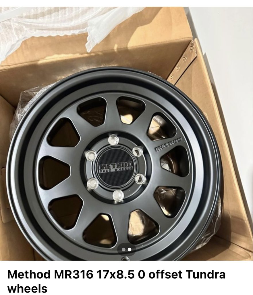

    I have a 2007 tundra going to put in a 4 inch lift and found some rims for good deal. The offset is 0 I’m worried they won’t fit and will be to wide. I want to find 295. IMG_4467.jpg

    I hate to tell you this, but if those are the actual wheels you are looking at, they ain't gonna fit. Those wheels are 6 lug; your 2007 tundra is a 5 lug... You want wheels with a 5x150mm lug spacing.
    As to 295's on a 0mm offset, from what I've seen they will typically rub in some places. You would usually need to remove some mudflats and bend some inner fender plastics with a heat gun. Might even rub on a the body mount depending on your lift, tire tread, and driving habits. I'm assuming you are after something like a 295/70R17? Which would be a tall 33" tire? If so, you shouldn't have an issue with the body mount but will prolly run in to some plastics. I can’t speak from personal experience as the biggest tire I've run is a 275/70R18 which is the same height as a 295/70r17, but on a stock wheel.

    You can technically use those if you get a wheel adapter.
    5x150 to 6x139.7

    Which will push offset even more negative. 0 becomes -24, for example.

    There's so many used wheels and new even to consider adapter just cause 'it's a deal'
