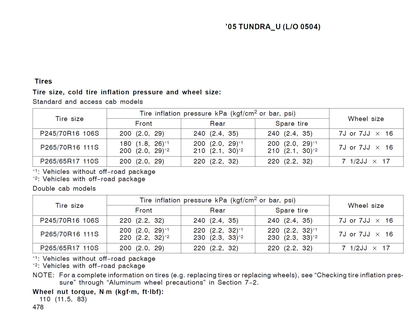

    I'm looking to get 16" wheels so I can get more tire for safer off-roading. I've gone to DiscountTire and 4WP tire/wheel shops and they're all saying that I can't fit 16" wheels without hitting the calipers. My owner's manual says it can fit 16". Some threads on here also mention running 16" but they're primarily AC not DC. My goal is to run 305x70x16 or 285x75x16 with minimal rubbing under flex. I'm guessing there's some trimming I'll need to do, but I'm not sure.

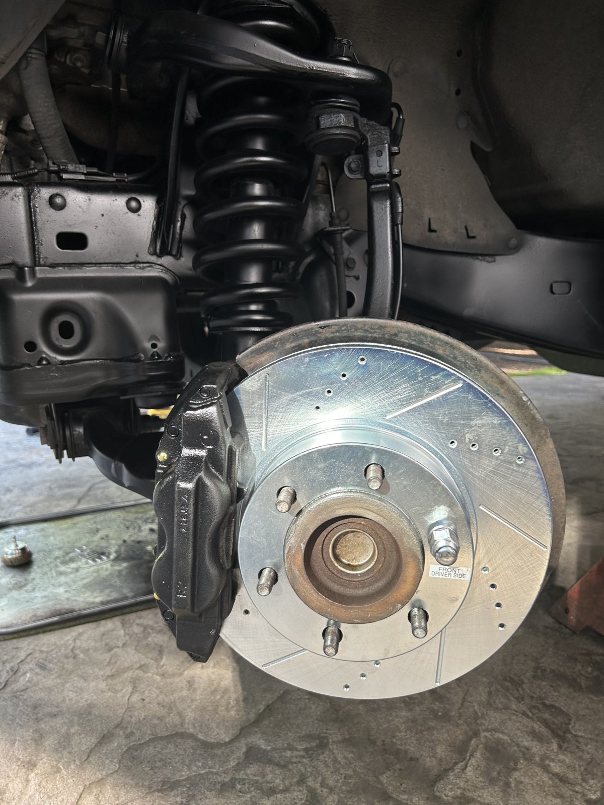

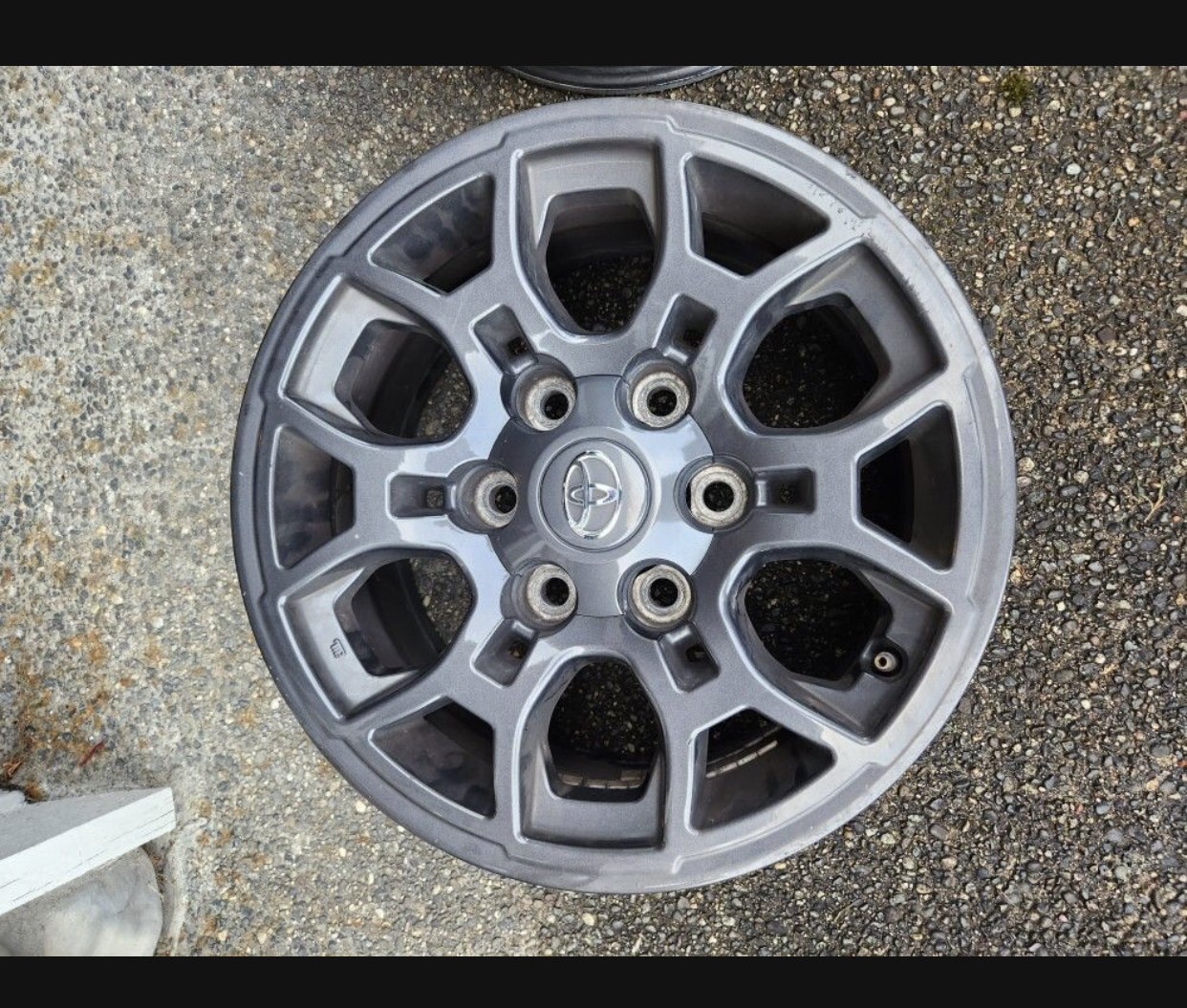

    Those are fj wheels iirc. Different spoke 16"s may fit
    If he ran some 1.25" spacers, as is typically done on 1st gens with wheels off other Toyota's, he would have been fine.
    The DC uses 13wl calipers/rotors same as AC/RC, which have 16's.

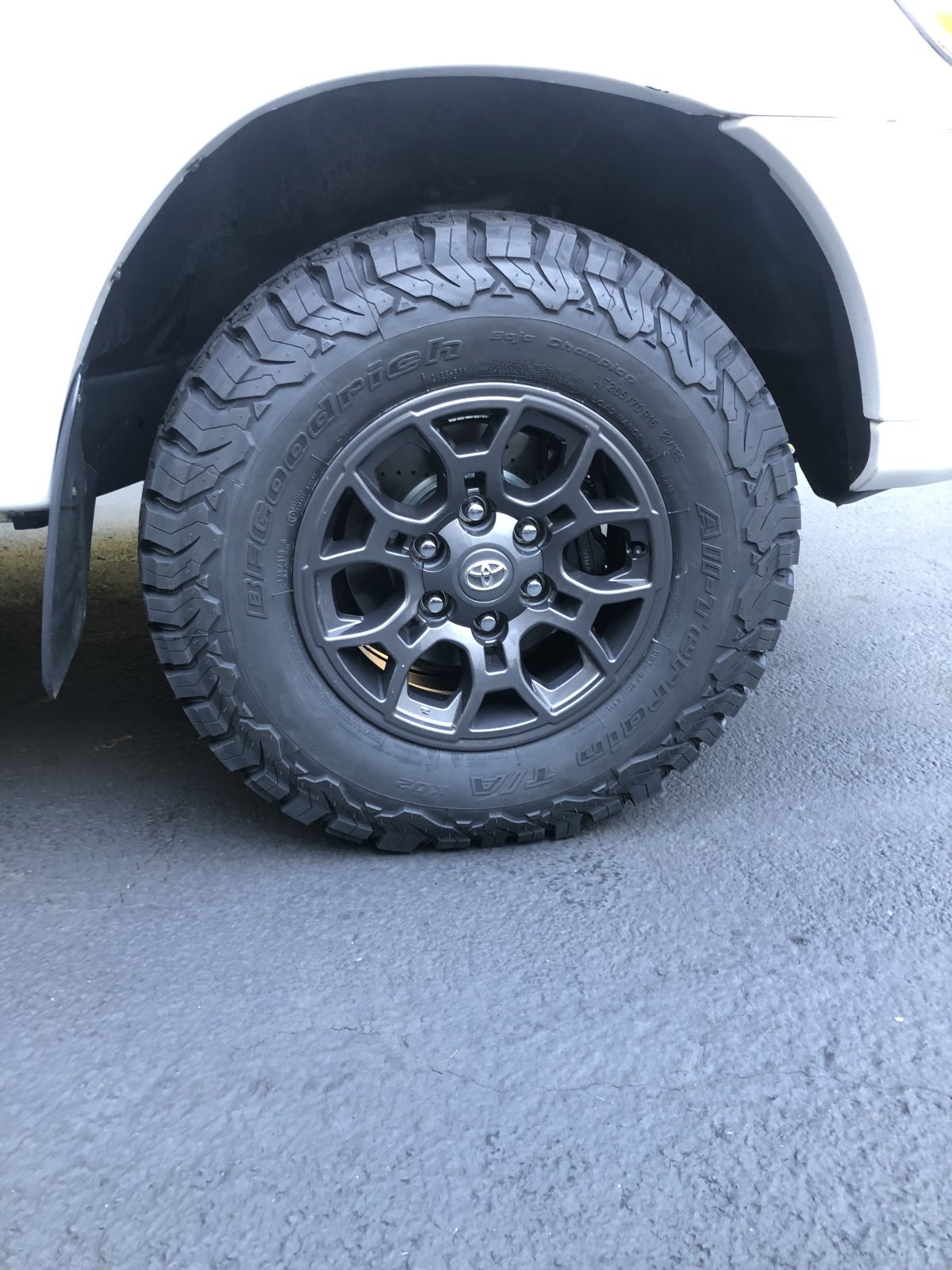

    For my 2004 Tundra DC 4wd with stock, brake calipers and drums, I’m running 16 inch Tacoma wheels with BFG KO2s. No issues with wheels rubbing the calipers or drums. BFG tire size: 265-70R 16.
    PsyGuy[QUOTED][OP] likes this.
