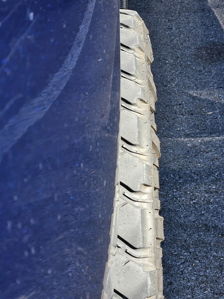

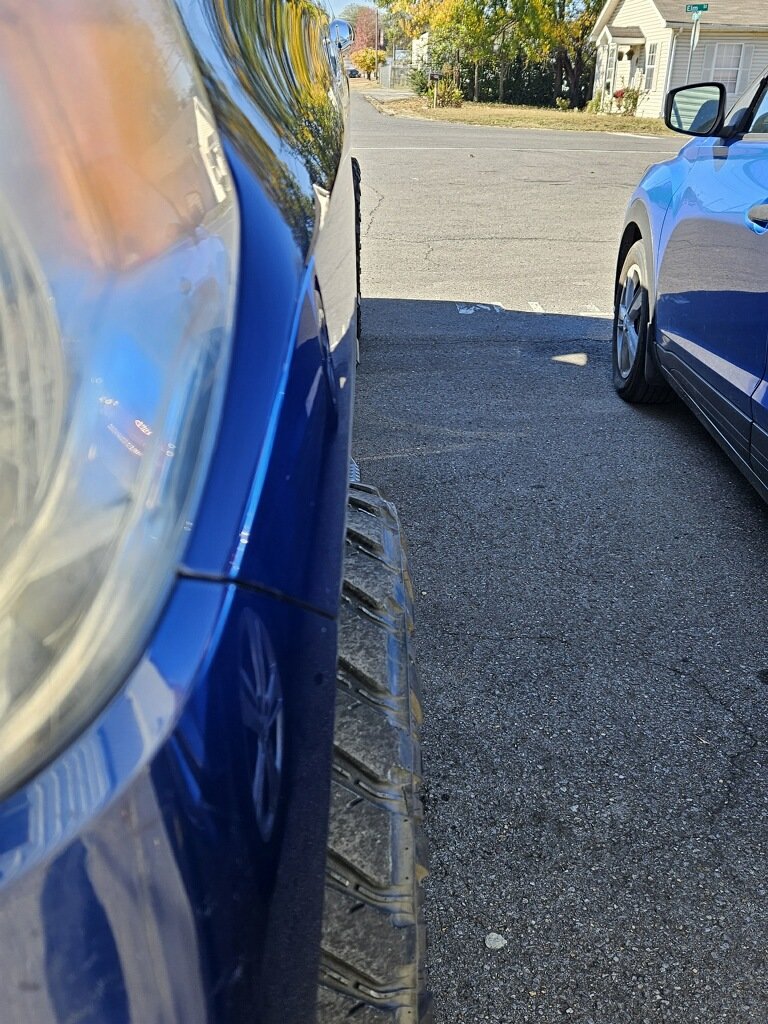

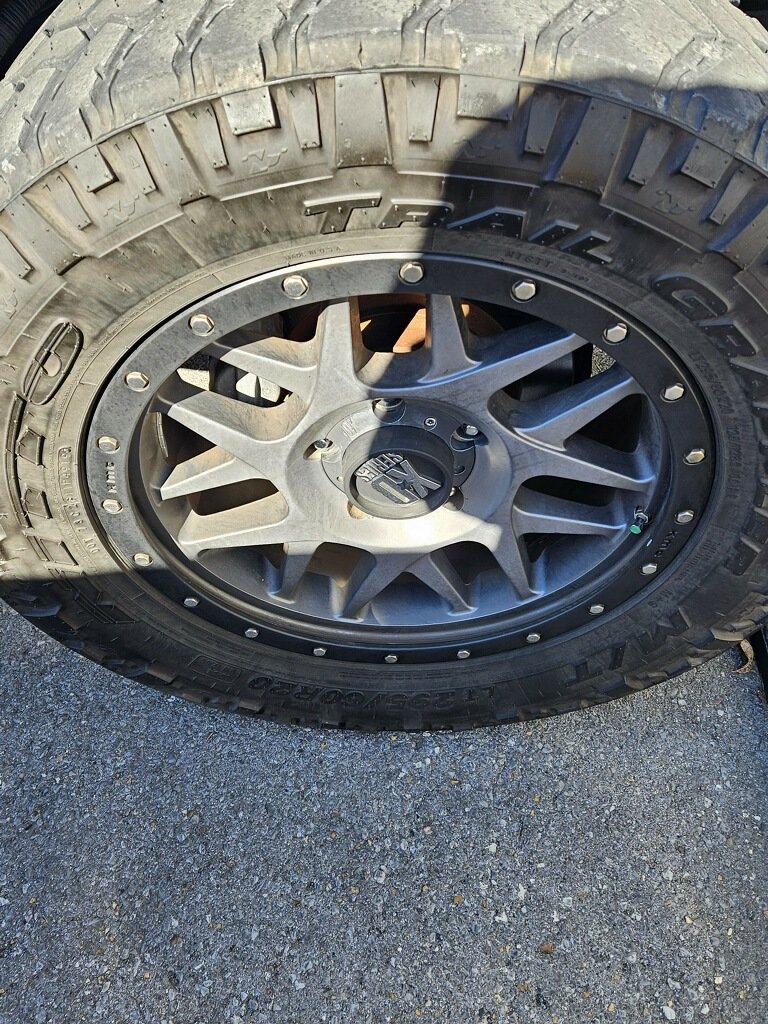

    Can anyone see these pics and given the detail, maybe tell me the wheel model and offset? I have a guy who wants to trade me for my stock TSS wheels. I can’t find them on the XD website.

    Find the exact model, size, and bolt pattern from the manufacturer's site. They will then specify which offsets it comes in. It's definitely not a negative number, nor is it at zero.

    I’m gonna guess +12 to +25

    That’s an XD127 Bully. Looks like a high offset, but all I can find on it online is a 0mm offset in a 20x9. It’s also listed as having a 47# weight!!!
    Sharp looking wheel, but not sure I like the specs that much.
