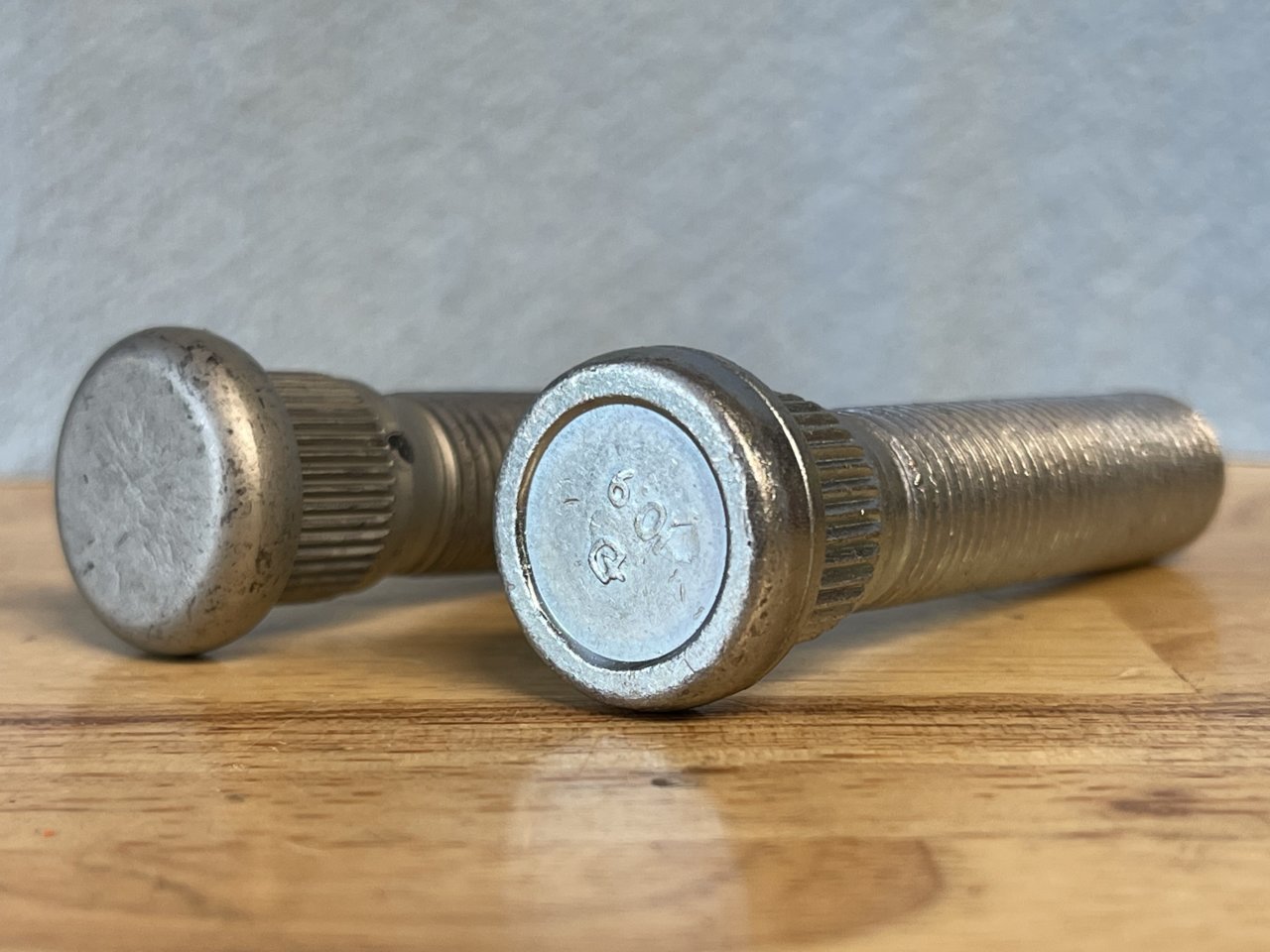

    I cant seem to find anywhere to get longer wheel lugs (studs) for my 2017 Tundra . only getting 4-5 turns with stock lugs. anyone know ?

    I think most opt for extended thread lugs instead of longer wheel studs as they are much easier to source.

    IDK ordered the ET lug nuts. they wont fir the lugs (?) hoping they sent the wrong size or something like that..
    I wouldnt have freaked out but it really dont have much holding these 275/60 R20' I run.

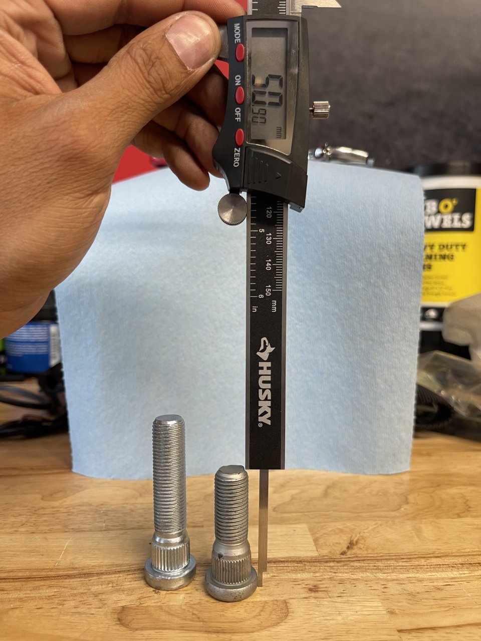

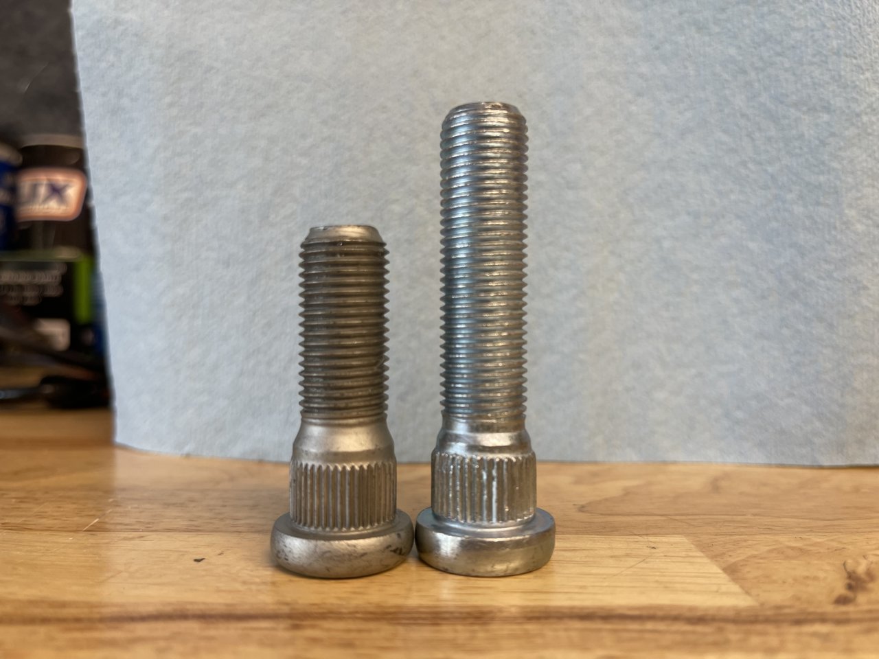

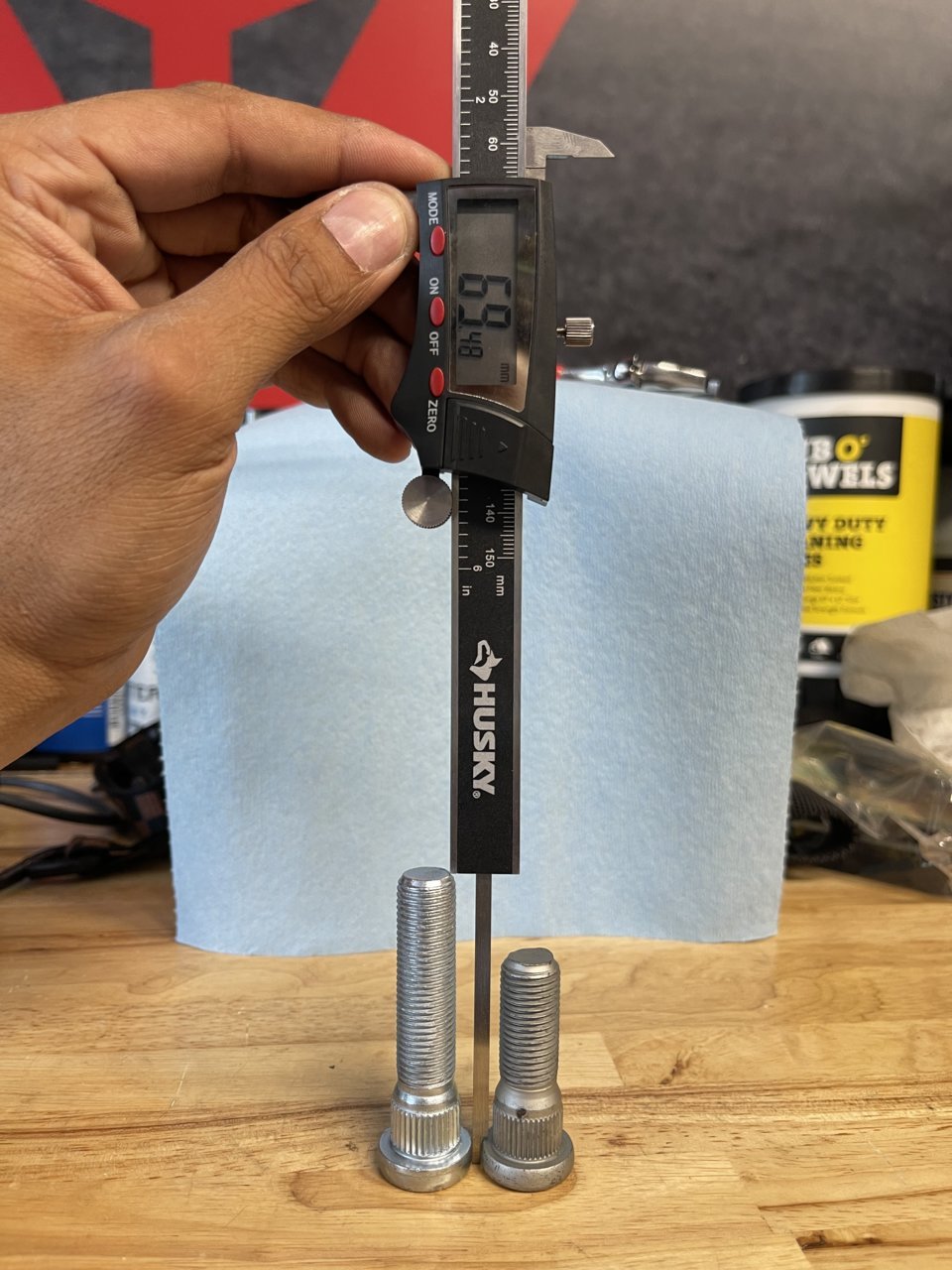

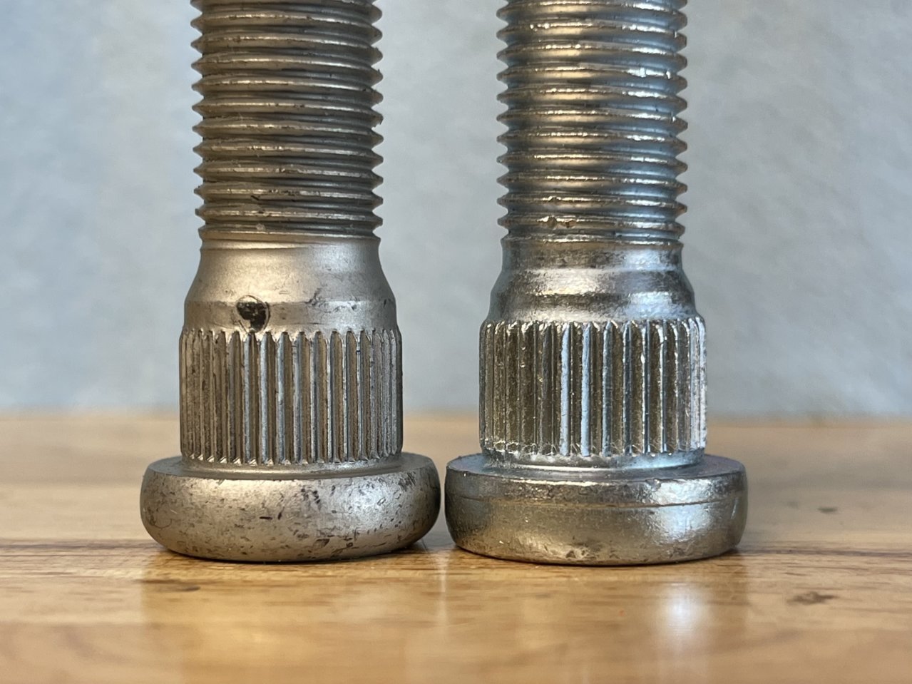

    If you ordered the Dorman then they are 9/16, while the stock lugs are metric 14x1.5mm. You’d need new lugs. Or you could return those and get these metric studs:

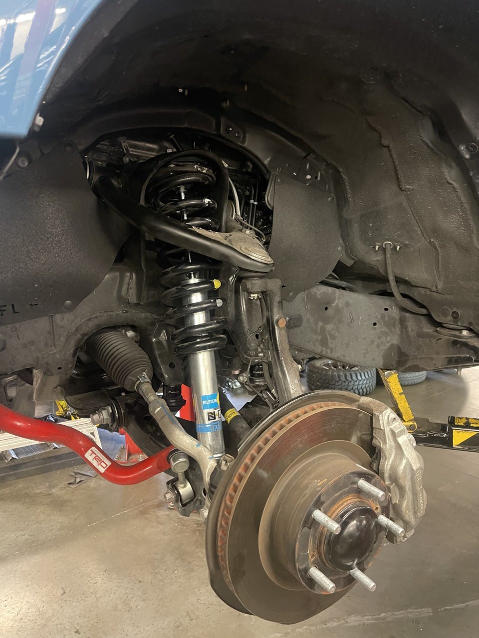

  8. Oct 28, 2022 at 10:45 PM
    Dillybob
    Dillybob [OP] New Member
    Oct 9, 2022
    #84612
    5
    2017 Tundra SR5 extra cab
    Damn brother, even with pics ..... am very happy to have someone like you out there to help...I'll let y'all no
    how it goes..!
    Toe404 likes this.

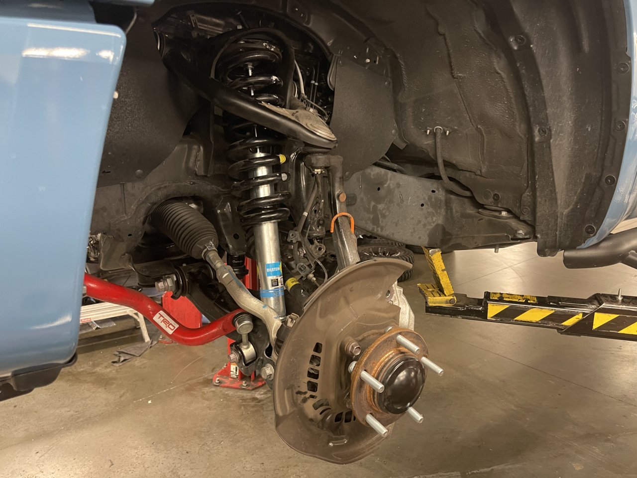

  9. Oct 29, 2022 at 12:49 AM
    Toe404
    Toe404 just a poser
    Jan 27, 2021
    #58285
    561
    Tomas
    Concord ,CA
    '21 Cavalry TRD Sport CM
    heres another shot with the rotors installed
    Tundra Dude 45 likes this.
  10. Oct 29, 2022 at 9:51 AM
    Retroboy1989
    Retroboy1989 'Course it's 4x4!
    Mar 9, 2021
    #60209
    1,337
    Northern Utah
    2012 SR5 TRD OR (prev) 2025 SR5 TRD Rally (now)
    I suppose this would keep you from going back to oe wheels? I suspect the stock lugs would not be deep enough.
  11. Oct 29, 2022 at 10:40 AM
    Toe404
    Toe404 just a poser
    Jan 27, 2021
    #58285
    561
    Tomas
    Concord ,CA
    possibly… I didn’t think that far ahead haha
