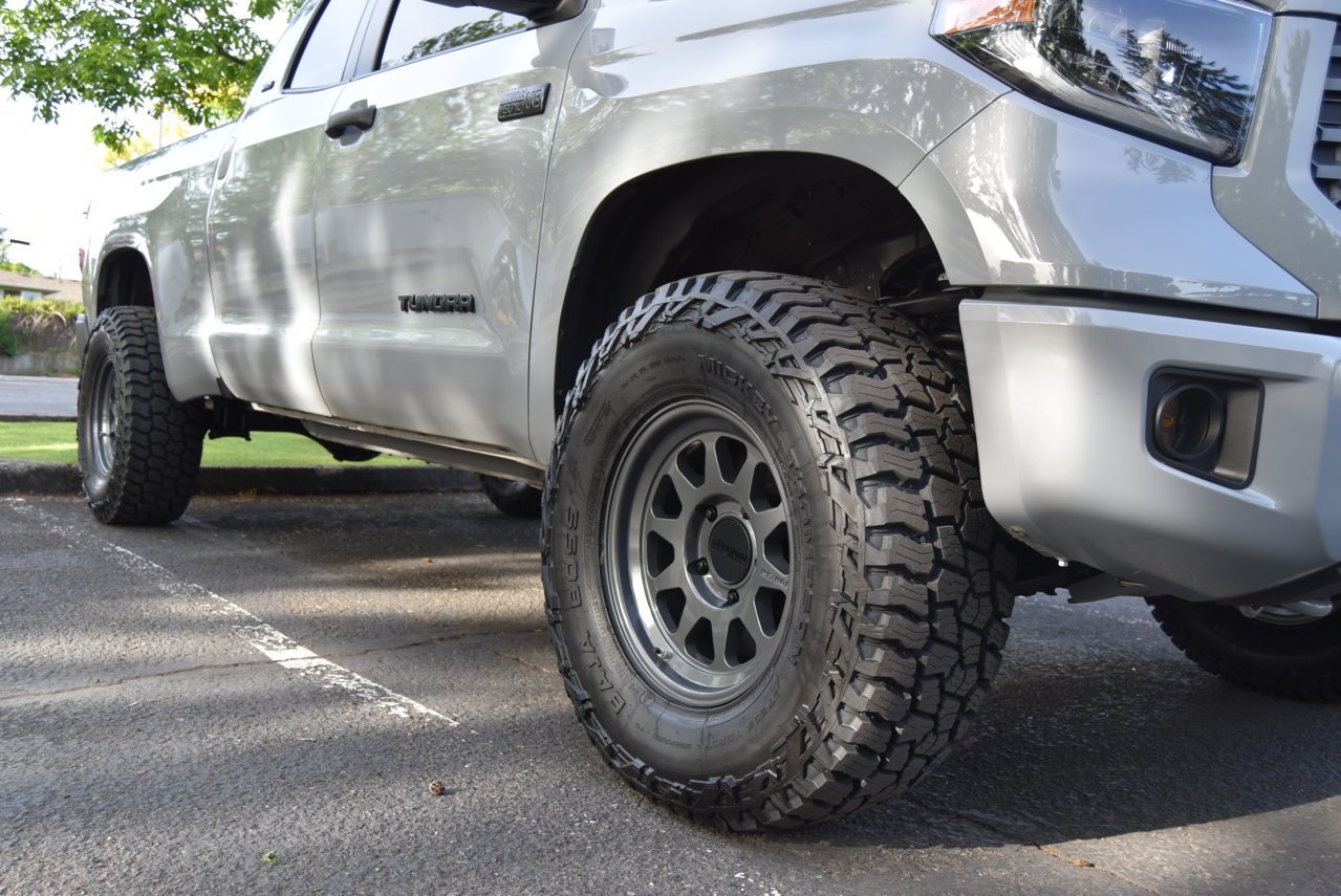

    What aftermarket wheels would sit flush to the fenders like the stock ones ?
    I've read that stock rims are +60 offset but I haven't seen any aftermarket ones even close to that. I currently have the Method Grid's which I love the look of. However with what I believe is +18 offset on them they stick out past the body about 1.5 - 2" which has resulted in some decent rock chips. It's not a garage queen but I'm also not trying to litter it with stone chips. TRD Pro rims are in the mix but at about $500/wheel I'd like to look at other options. Any suggestions ?

    This could offer you some insight http://www.rimsntires.com/specspro.jsp
    But most of the wheels come in specific offsets. lots of choices in the +18 to +25, but fewer rims in higher positive offset, which is what you are looking for.

    Look around for wheels +30 to the stock +60, most of the wheel vendor sites let you filter by offset.

    The majority of wheels for the tundra from what I have seen are 25 and lower. I have the TRD wheels and I am putting on 1.25 wheel adapters which put it slightly outward of the fender. Almost like a 25 offset. Gives it a better stance but avoid rock issues. Luckily I have never had the rock chip issues with any of my aftermarket wheels.

    Stock wheels with a 1.25 is like a +28 offset, 1.5 is like a +22. Anything in the +25 area is pretty much perfect for stance, clearance and concern over fender chips. I dont have any paint chips as of yet.

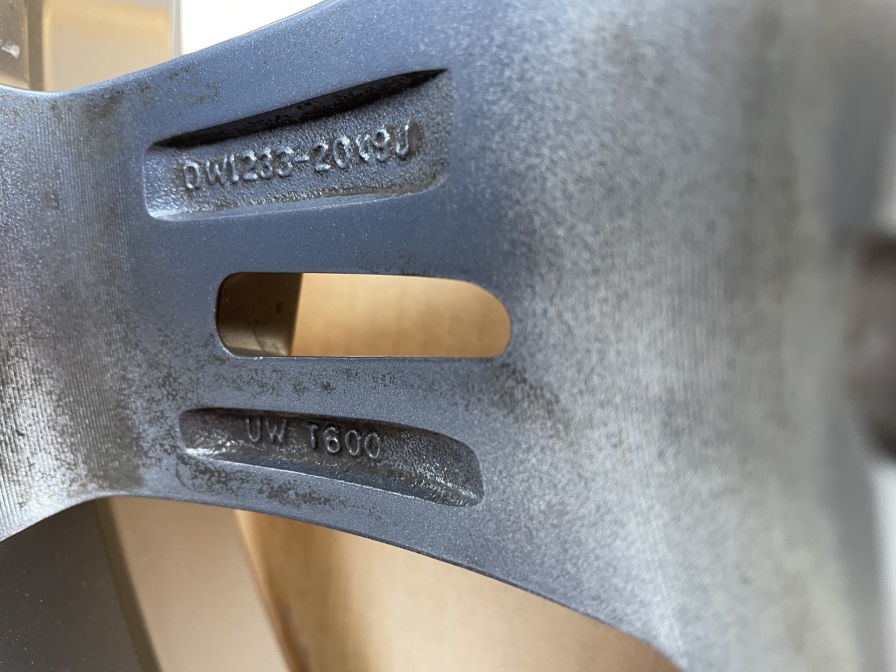

    Yea they stick out 2.25" in the rear and 1.5" in the front so they actually might be 0 offset. I'm going to pull them and see what they're stamped on the back with. I might go with icons that are +25 which should be a bit more reasonable if mine are 0 offset.

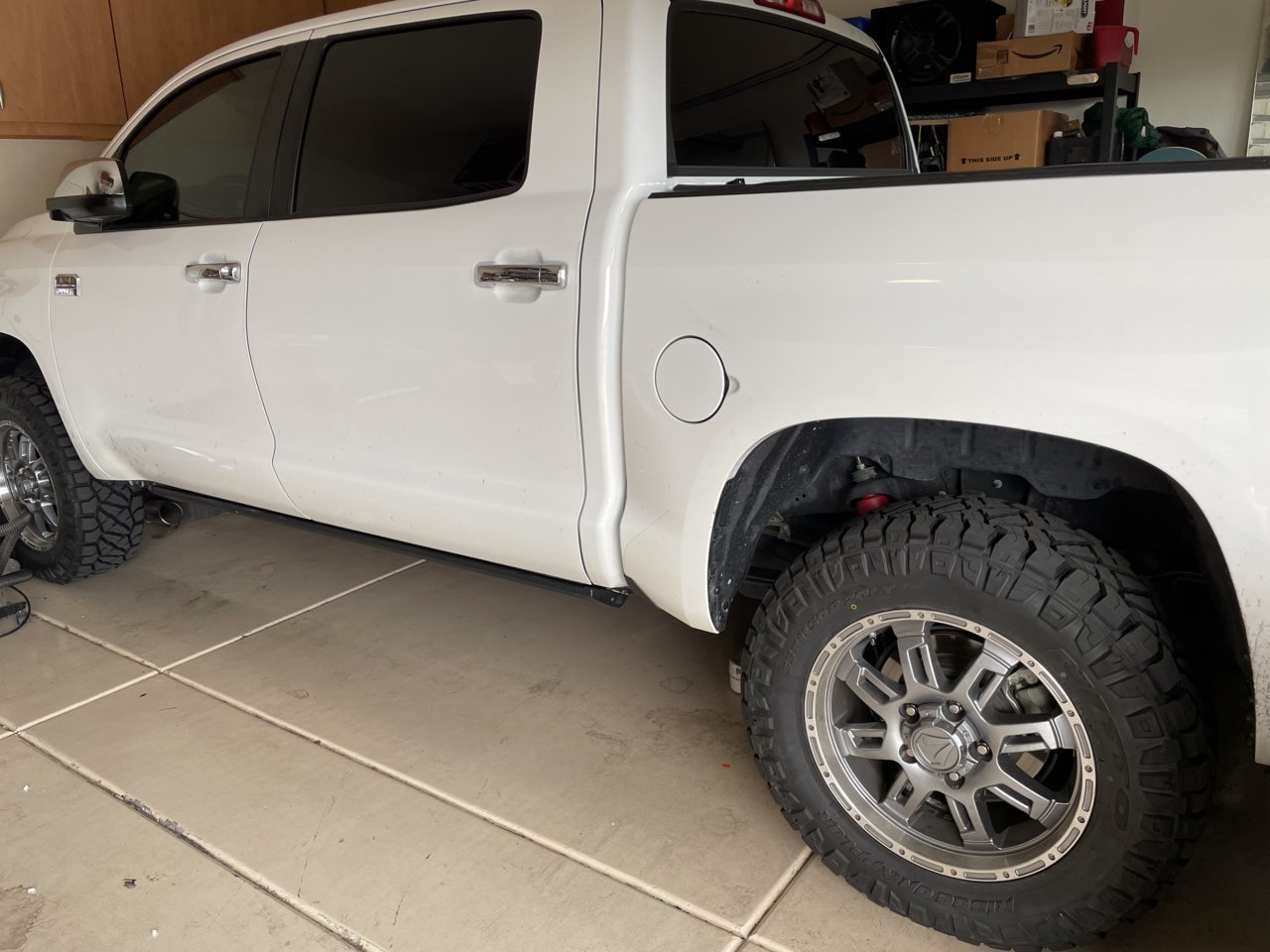

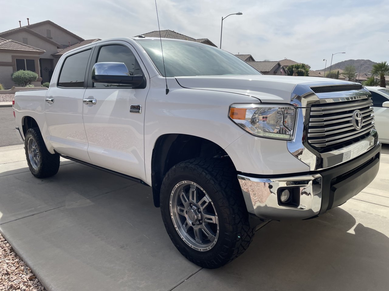

    The 20x9 TSS Tundra wheels are a +50 offset and sit flush with the side with 33” & 35” x 11.5” Ridge Grapplers (I’ve run both sets of tires)

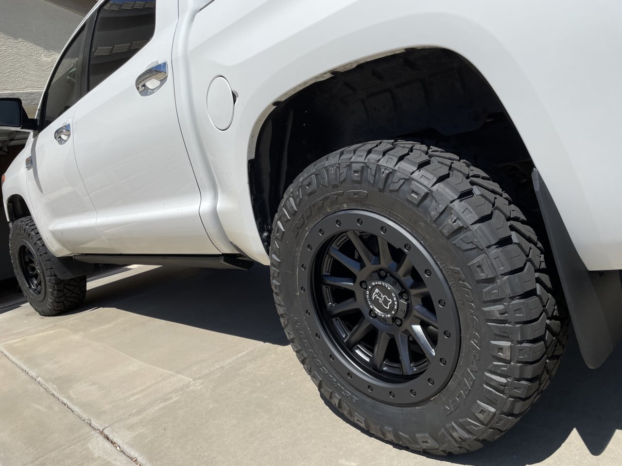

    Just took off the TSS wheels to go to a more aggressive offset (Black Rhino Duggers 20” +10 offset)
