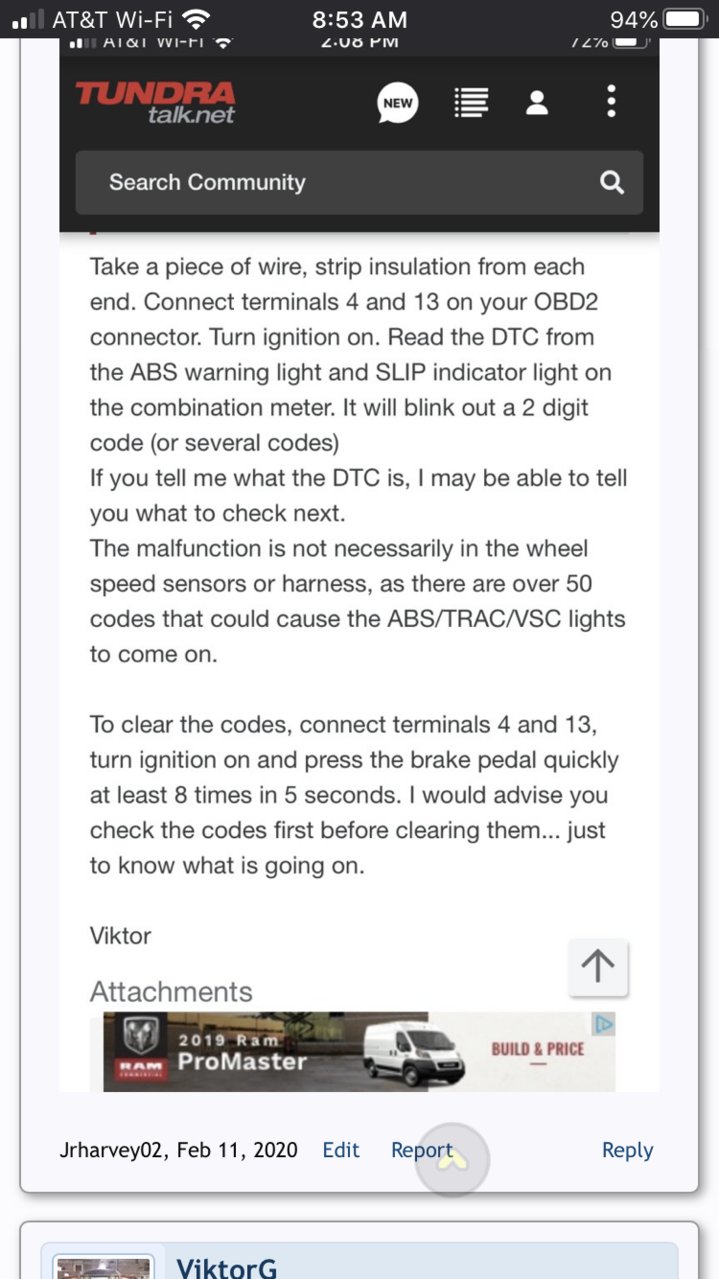

    It’s likely a wheel speed sensor, wheel bearings won’t throw a code. You can jump the OBD port and your dash will light up like a xmas tree, count the sequence of blinks the ABS is throwing, its gonna be a two digit code, repeating over and over. The code will narrow down which wheel speed sensor is bad. I just had this issue and after careful inspection of the sensor, there was the tiniest amount of corrosion on one of the connector pins, I could see a greenish hue on the copper, cleaned it off and have been problem free for 6 months now. 32AE29E1-D990-40F8-AE9C-990DC086D859.jpg
