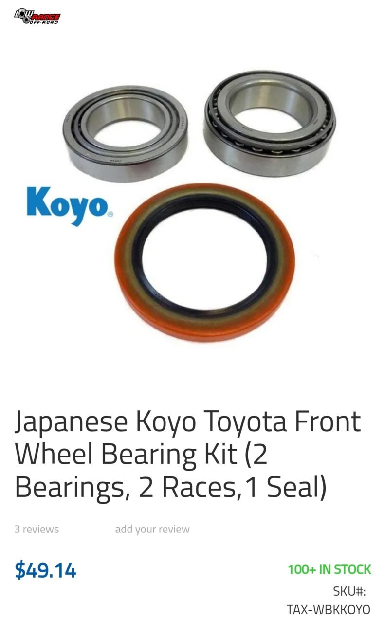

    See build link
    Does it have OEM in it?
    I believe the recommended brand is Koyo and luckily they aren't too hard to find (not limited to paying inflated dealer pricing)
