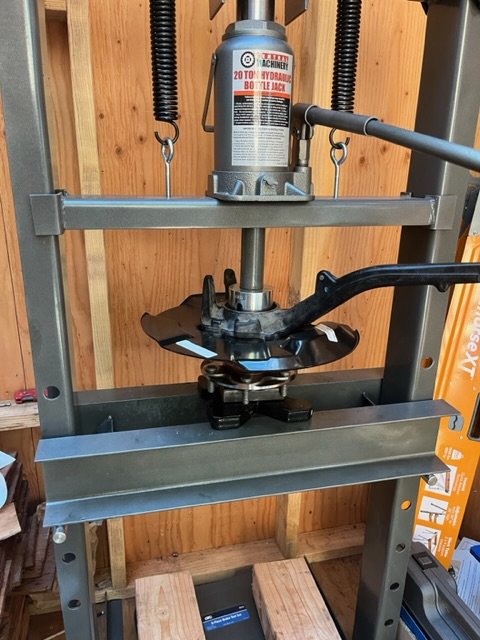

  13. Oct 3, 2023 at 7:20 AM
    mthoodbill
    mthoodbill New Member
    Mar 1, 2023
    #92952
    82
    Mt Hood, Oregon
    2000 Tundra SR5 Access Cab 4x4
    Bilstein 6112, .5" front lift. 5100 rear. 17" FJ steel wheels Gofast topper
    I also used a 20t press to do mine. It’s a fairly involved process. Had the race stick to the hub, so replaced those as well. IMG_4387.jpg
    KNABORES and FirstGenVol like this.
  14. Oct 3, 2023 at 8:23 AM
    KNABORES
    KNABORES Sarcasm incoming
    Jan 1, 2020
    #40572
    13,718
    Arkansas
    These are encouraging posts. I will try with the 20 ton we have and only upgrade if it fails.
