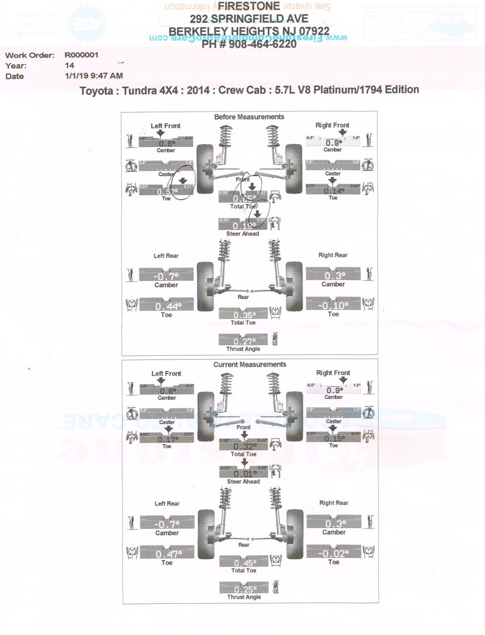

    I've never had a problem with my previous carseat firestone and figured it was time to get one for the tundra. Just installed 6112s @ 2.5" and 5160s with toytec shackle at the top setting. I had to remove the rear springs to install new poly bushings, I'm assuming that's why the rear toe is off.
    How do the specs look? My Bfgoodrich k02s are near the end of their life and slide all over in the rain, firestone didnt touch the camber in front due to being within spec. And no caster readings?

    You really want camber down to 0.0 or 0.1 if you can. Where are the caster numbers?
    If you do a search on here for "alignment" you will find some great threads with tons of info to get you heading straight.

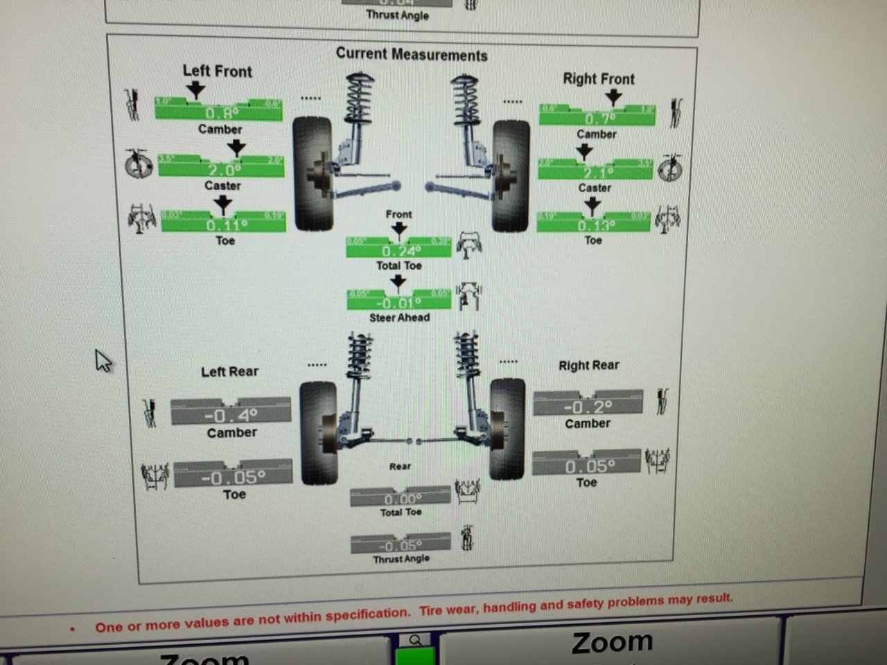

    He is mine after 6112 at 1.9” and cb +2 in rear. I started a thread about it, but didn’t get any responses. My tires look tilted in. Going for my 10k service soon and will ask Toyota about it.

    I agree with @nowayout. Camber should be close to 0*. Caster = as much as you can get and it looks very low. Optimal toe is about .06 for a total of .12 which is exactly half of what you've got.
