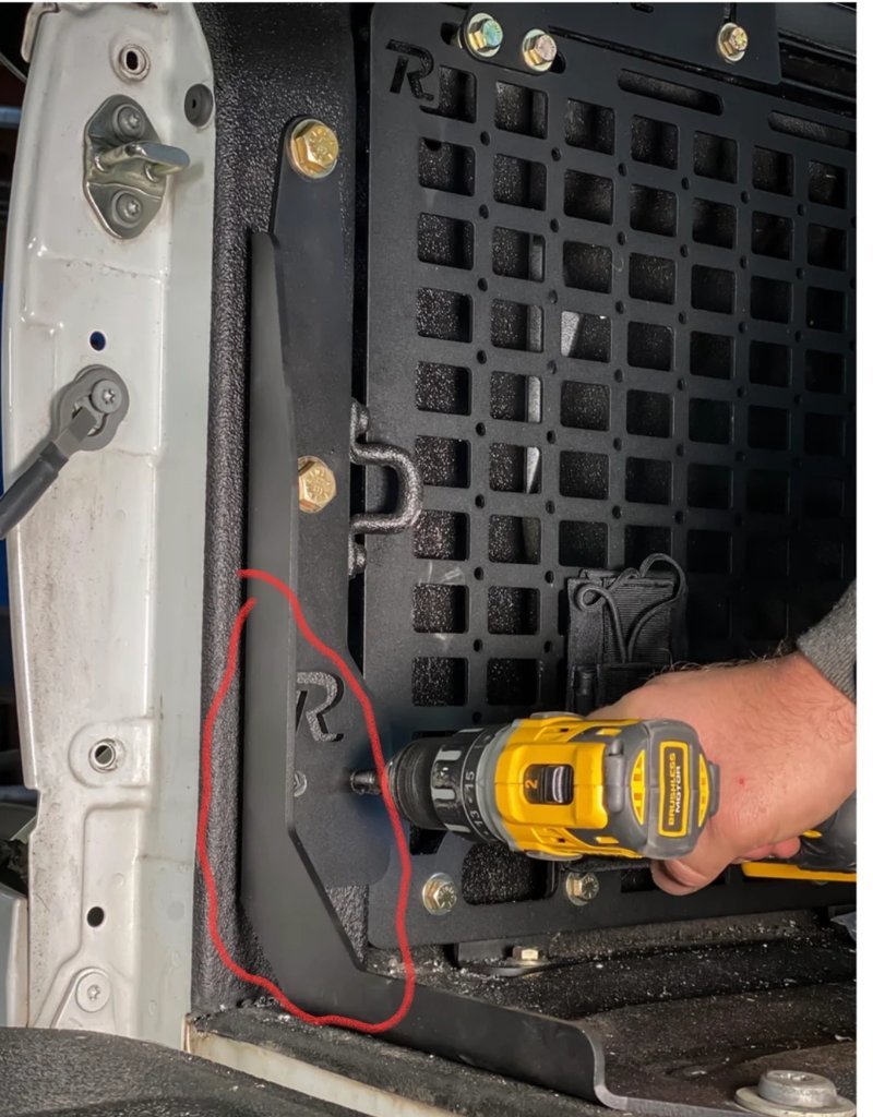

    I think removing what I circled would work.

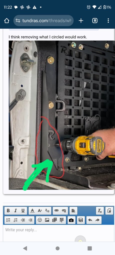

    May work to fit, but once you cut that corner marked in green, it loses the ability to stiffen. I think you might be able to go with the flat bar "L" though. Really need to see what it looks like with the bed extender properly mounted, but you might not be able to provide a photo if you currently have this stiffener in the way. Maybe there's a photo online???

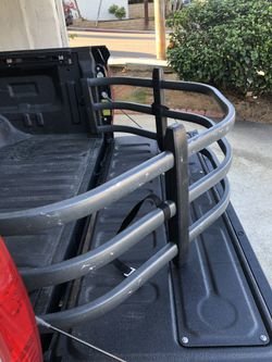

    Not great, but it might help ID it.

    A flat L shaped would be perfect. I'll take a picture in a little while.

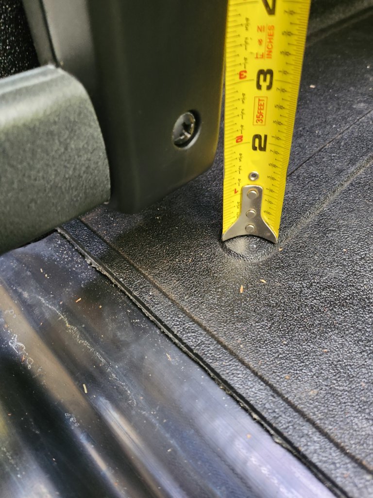

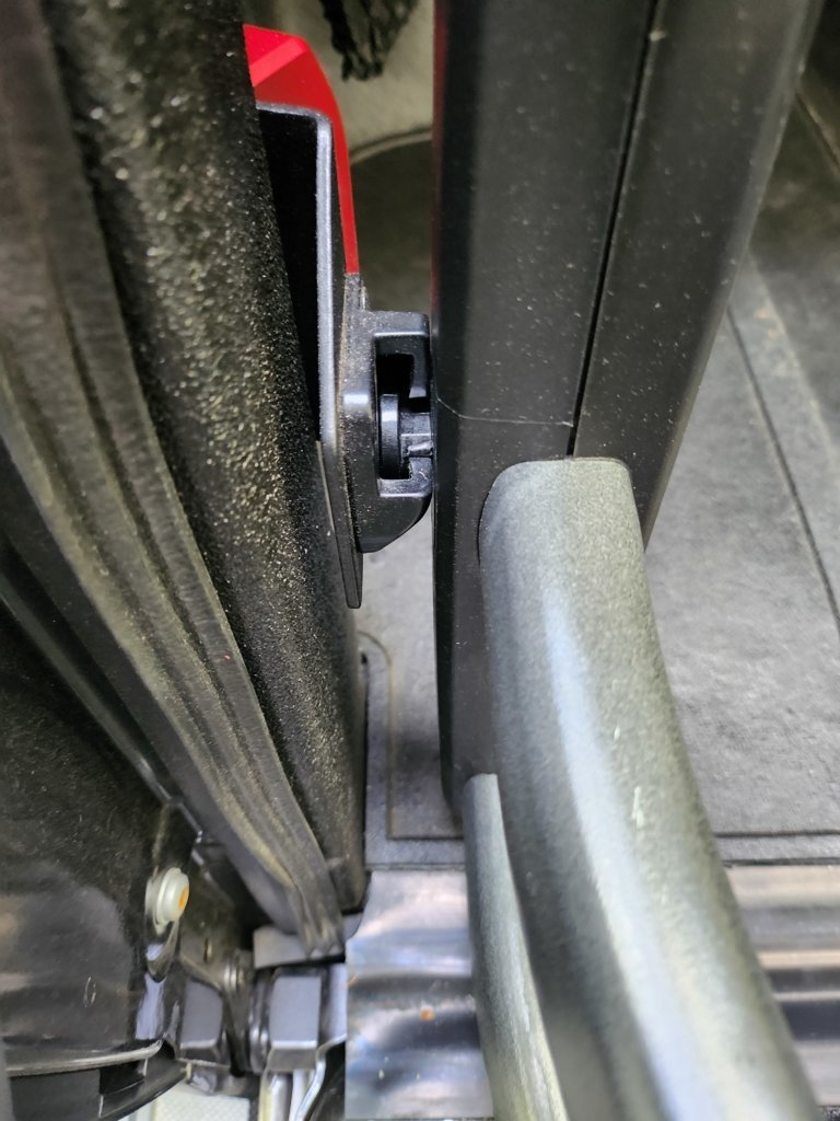

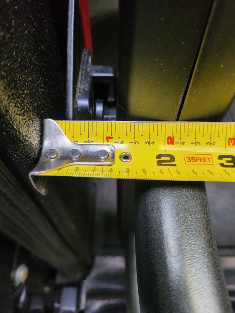

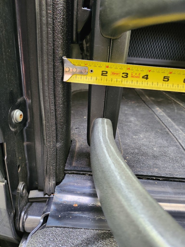

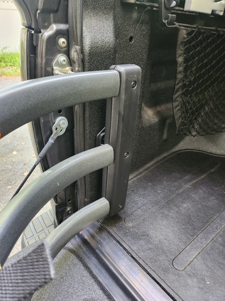

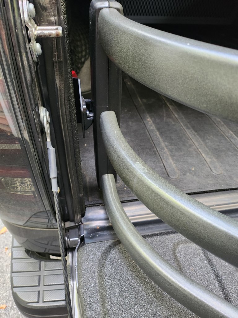

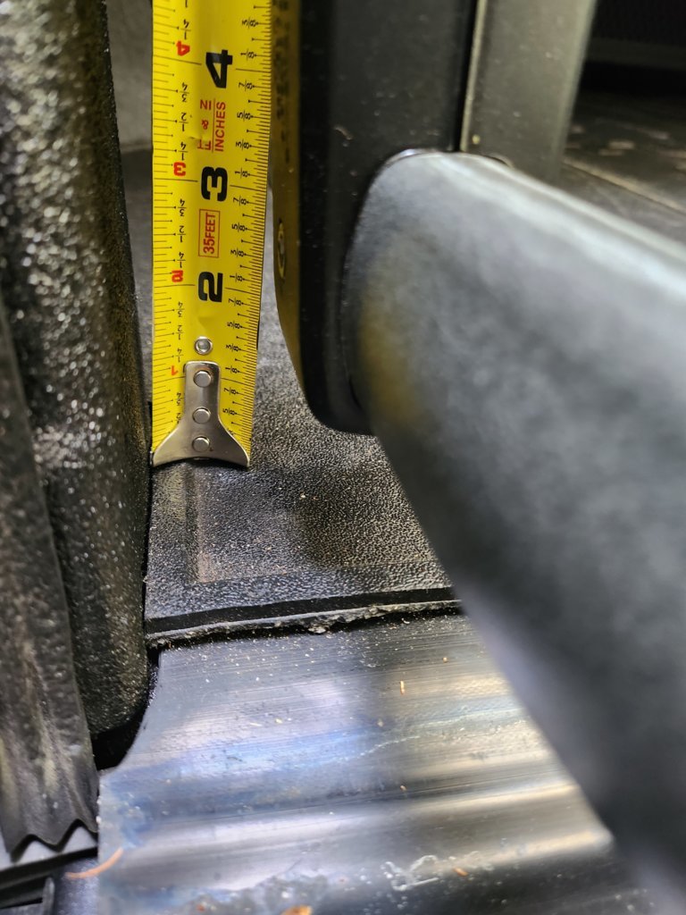

    If the tie down circles were removed those would probably work. I think they would be in the way.

    If OP isn't interested in this, you should be able to share some of these photos with just about any machine/weld/custom fabrication shop in your area and have a solid pair made for a fair price. If it was me, I would use 3/8" steel plate welded at the 90 deg. with stainless countersunk mounting hardware. For coating, I would just prep and prime with cold galvanizing spray followed by Rust-Oleum textured bed liner spray. Shipping would be expensive as they would be on the heavy side.

    The best option for that looks like it would be the thickest plate as practical, and as big as a gusset as I can get away with. Something that would be easy to add on is some sort of folding tie down. I've had a few situations where i needed to tie something down and the factory tie downs are just too high to do anything. I'll look into this one. Is this something people would want to see?
