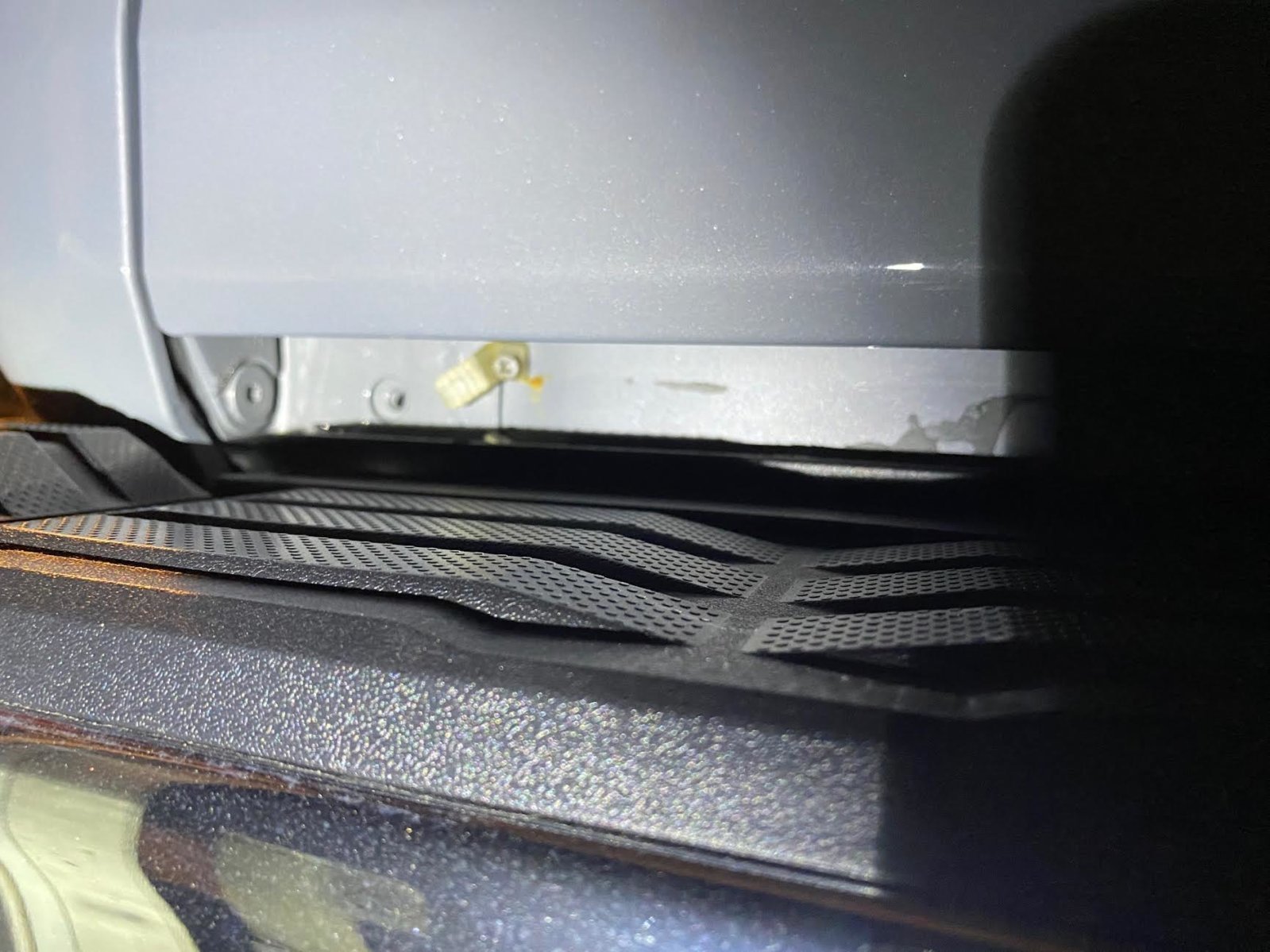

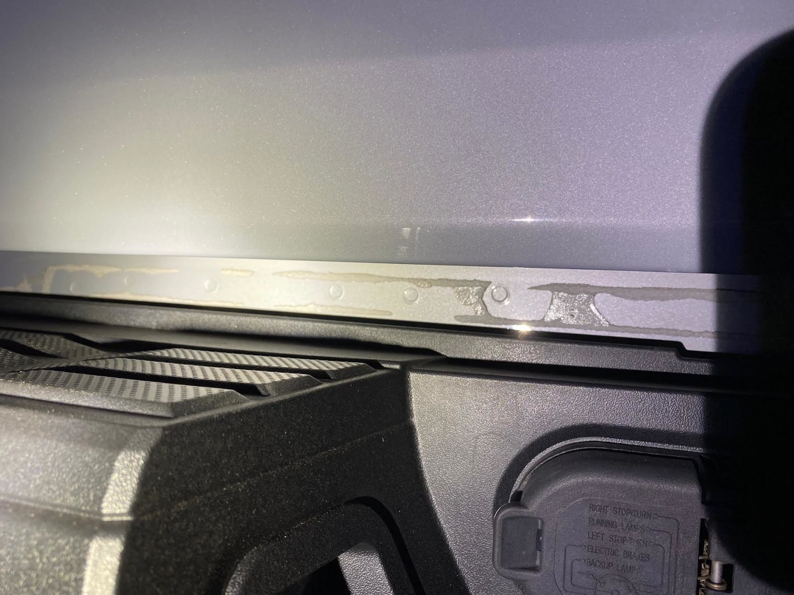

    Just picked up a 21 Tundra.
    Noticed tonight that it looks like something is missing from right under the tailgate area.
    What is supposed to be here?

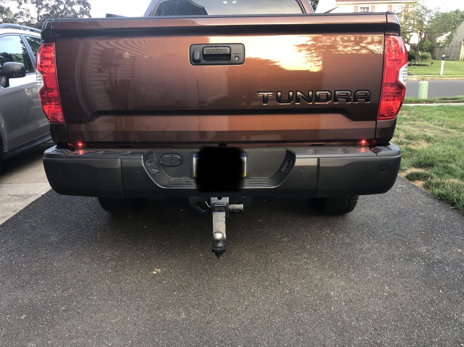

    Nothing is supposed to be there. Perhaps the previous owner had one of those tailgate light strips and that is the leftover adhesive. Here is a picture robbed off google, there is just a gap under the tailgate and bare metal

    Thank y'all so much! I was so confused.

    Not sure why they didn't put a ground screw under the truck.:rolleyes:

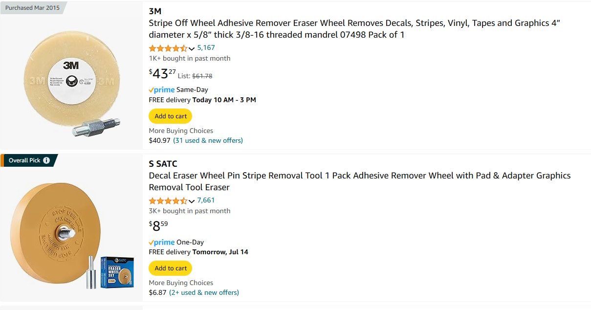

    I'd pull the tailgate and either thumb that residue off or use a 3M eraser wheel or equivalent on a drill..
    Clean it up what's left with Goof Off..

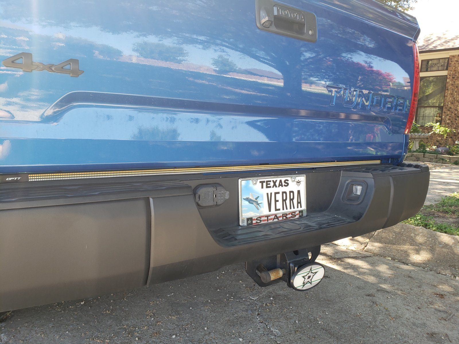

    Yep, I'd say they had a lightbar. Many company's have it installed with double sided tape so that looks like the correct size from what I've seen.

    With that light bar I hope you have your spare in the bed.

    Mines not attached with doubled sided tape. I have velcro so I can remove it. But in the 6 years owning the truck, the spare has yet to be needed.

    Once you clean off that residue you could always mount two small LEDs in the thread holes.
    I have mine wired in as “always on rear DRL”
