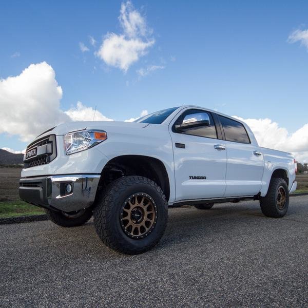

    Thanks. I am confused though cuz the three videos I watched all say that if I want to poke out I need a negative offset.

    They will poke with a +25

    Not my truck this is from the Method site..Tundra with methods with a +25

    Yeah, I like the pics, looks like a little poke which is what I want. I just don’t get the negative versus positive thing. The sites say negative causes more poke yet LogCabins and Squeaky above say for more poke I need positive (+). I am just missing something and trying to figure this out. Thanks to all for your help...sorry for being such a dumb-ass about this
