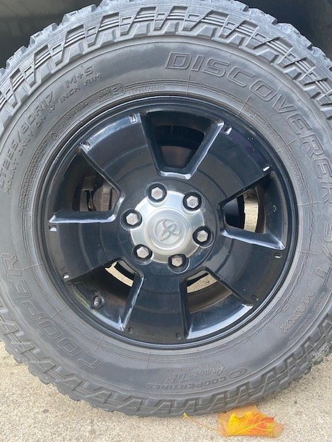

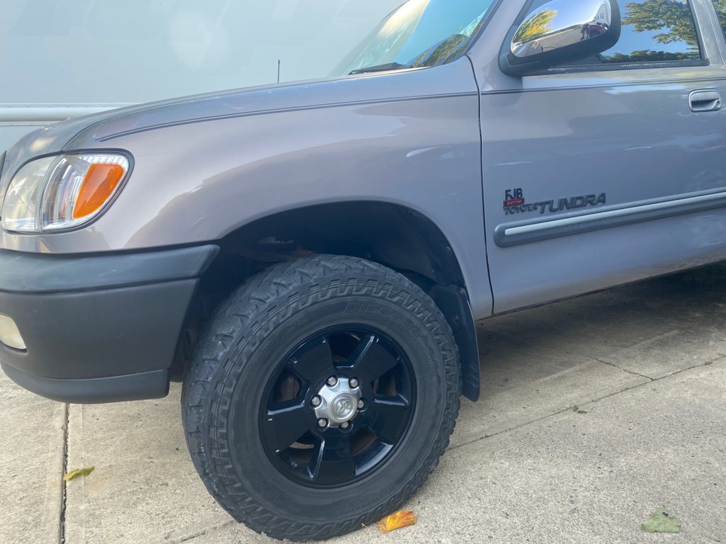

    These are the 17" wheels I currently have. They came with the truck when I bought it in 2016. When I added the bigger tires I had to use a spacer to clear. I think it was approx 1/4". Maybe from a Sequoia? The reason I ask is I would like to know the backspacing. I would like to replace these with 18" 6 lug take off wheels from a newer tundra. I believe the back spacing on them is 60mm. Can I make the 18" wheels fit?

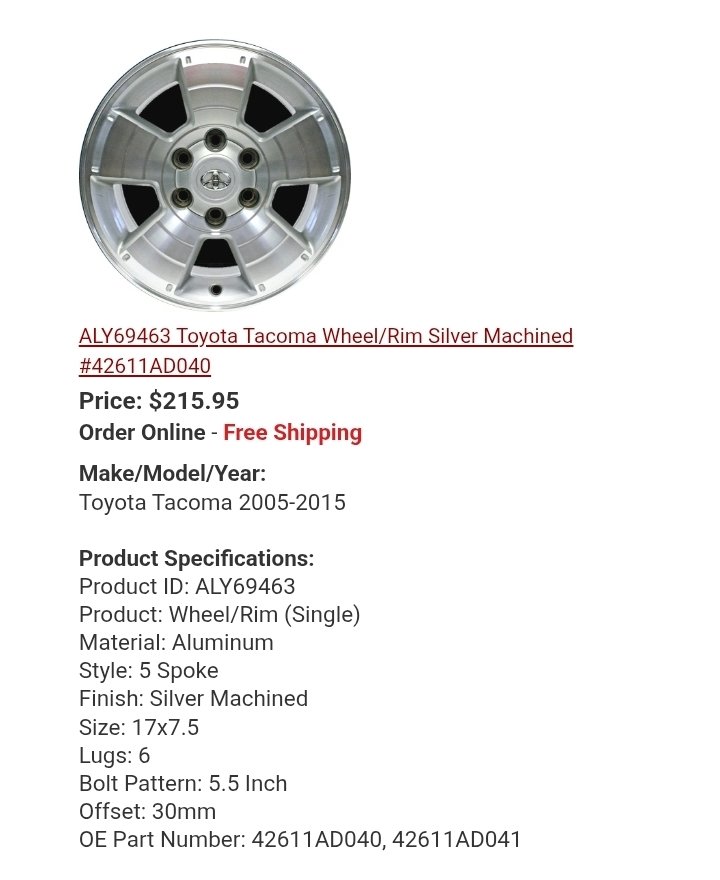

    They are Tacoma wheels possibly powder coated / painted black (silver cap gives it away), search ”2010 Tacoma Wheels.” You’ll find plenty of hits / links to their specs.

    Yes, I had them powder coated. Thanks for the info.

    Those are the 2nd gen Tacoma 'sport' package wheels. Someone painted them.
