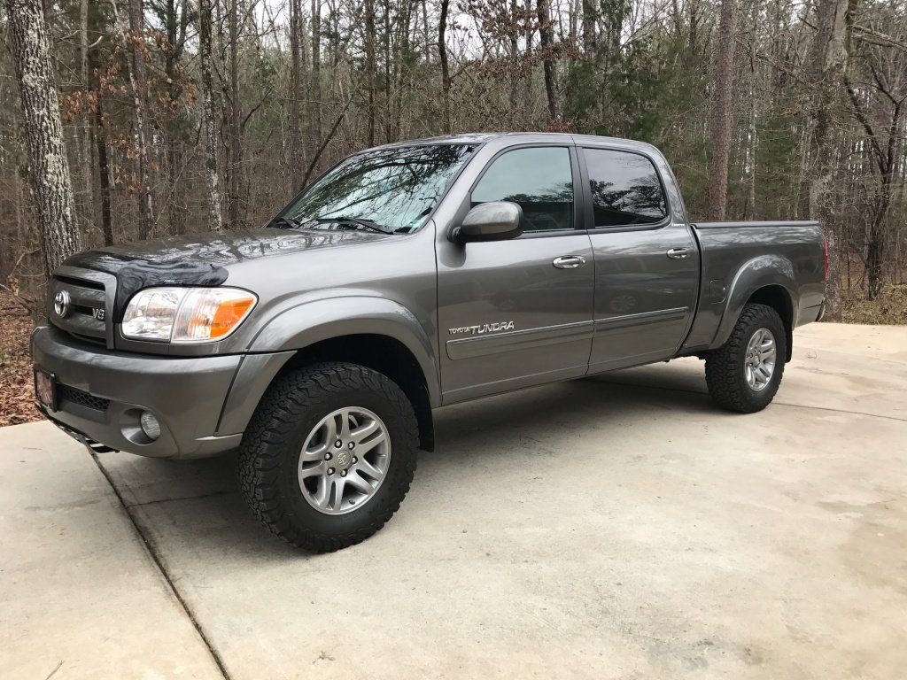

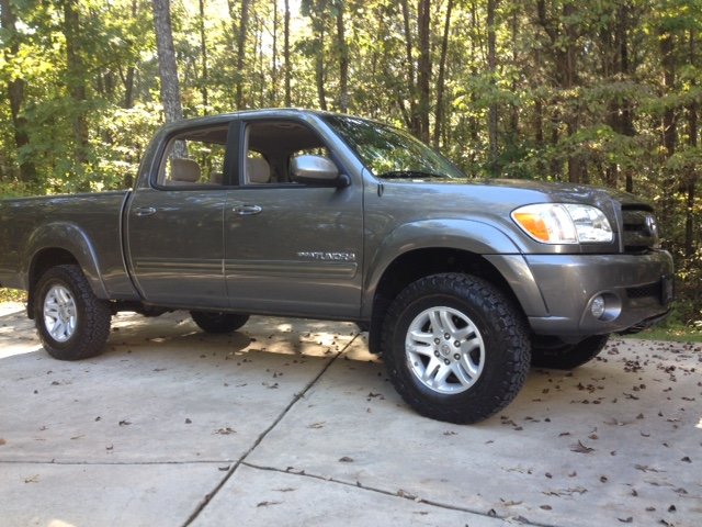

    Pic is my truck with 2016 Tacoma TRD wheels and 1.5" spacers before upgrading to the 18" BBS. The spacers helped bring the wheels just flush with the fender flares.

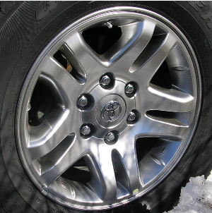

    Sometimes you gotta give other people a chance to answer. This isn't "shifty's 1st Gen section", and I hope it never comes to that :rofl:
    @Jack87 as was so eloquently articulated above, there are two versions of that wheel: One that's bright metallic silver ("hypersilver") that came on the Tundras, and a slightly smoked one that came on the Sequoia. I am finally saying sayonara to mine as soon as I get tires mounted on my new wheels, but haven't thought about how much I'll ask. I love 'em but ... no room to keep an extra set of wheels unless I unmount the tires and throw the wheels in the attic.
    There's someone either here or on TacomaWorld selling them at an exorbitant price. I've seen folks give them away. But the average price seems to run about $60-100/wheel used. The only downside is, with the width and offset only offering about 4" of backspace, running anything larger than a 32.5" tire without spacers will have you rubbing suspension. But they look damn nice!
    Mine are in pretty damn mint condition, only 75k miles, no curb rash, and never seen salt roads which will eat the finish and pit the alloy.

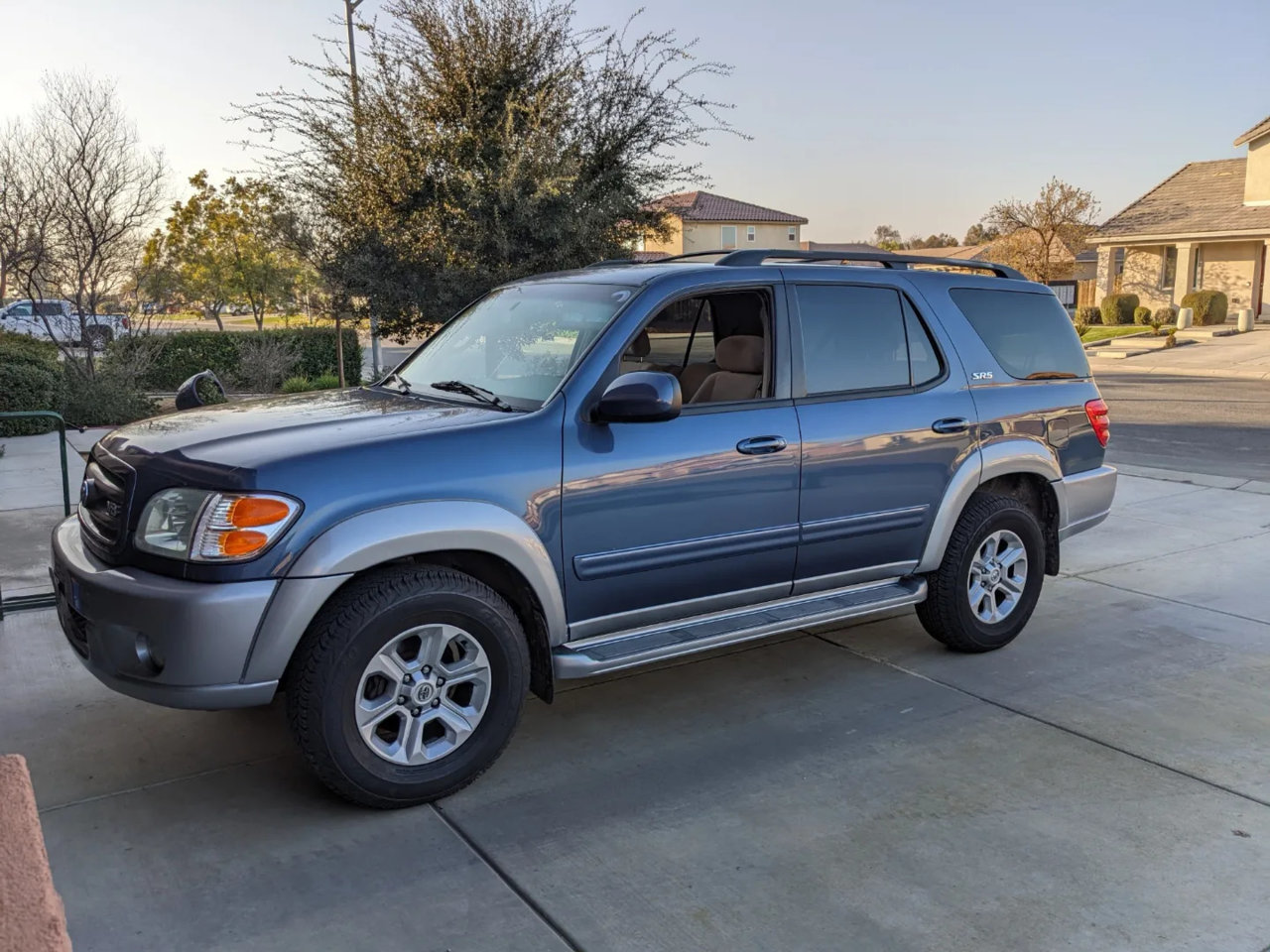

    I had the limited 17s for a long time and they're very nice. I picked up these take-offs with tires from a guy with a new 4runner for 200 bucks. I didn't bother swapping the wheels. I think they look nice, the offset lines up well and they're everywhere on the trading apps

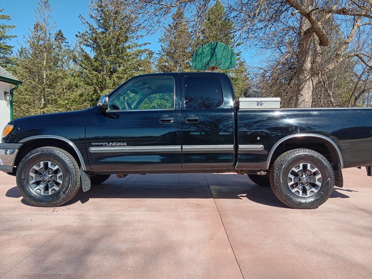

    I scored a set of 2021 Tacoma TRD wheels/tires on CL.

    These are a win. Ultimately this is what I want but I want to make sure it doesn't mess with the suspension geometry.
    What size are these particular wheels. How much did you end up scoring them for?

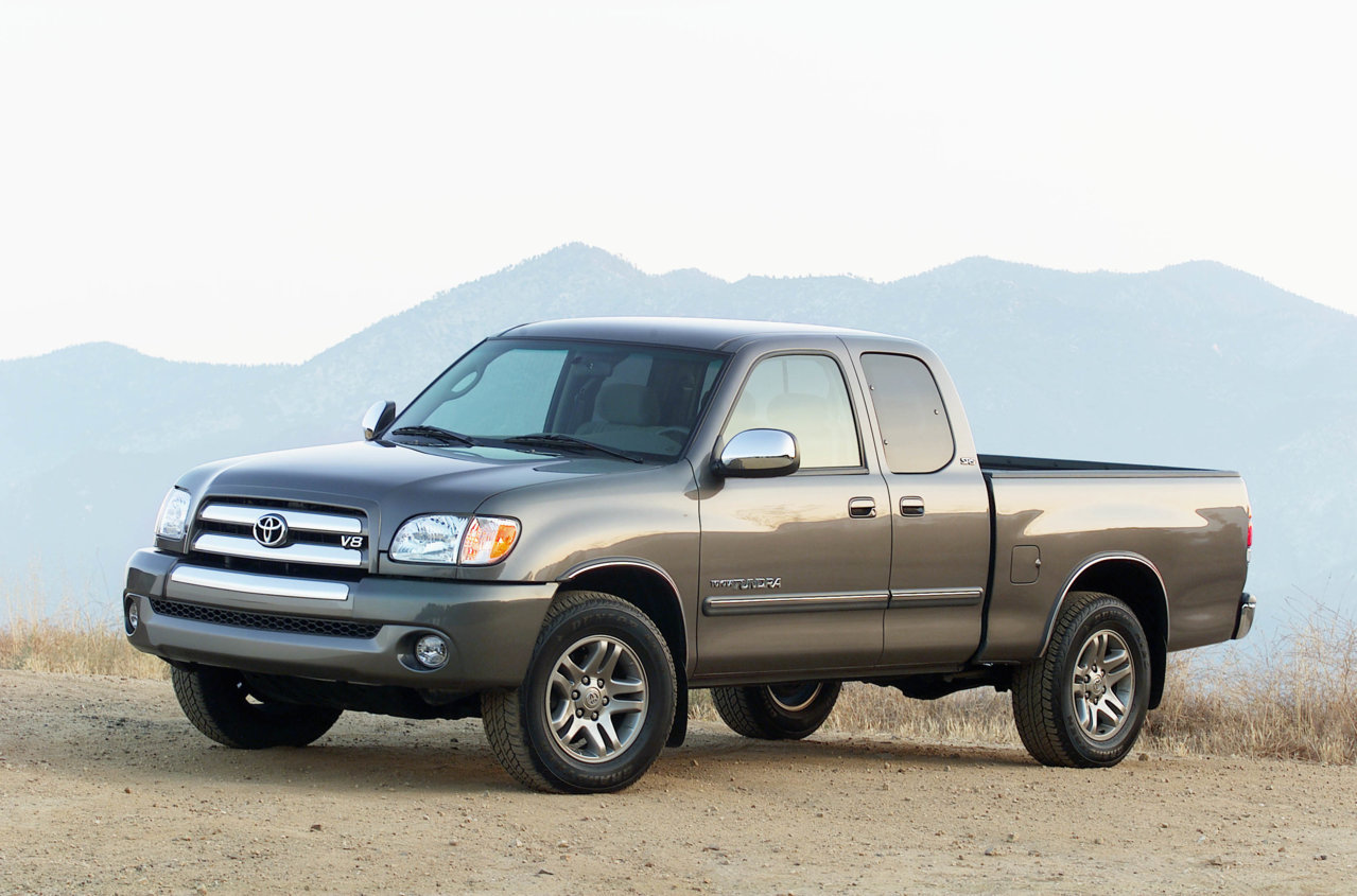

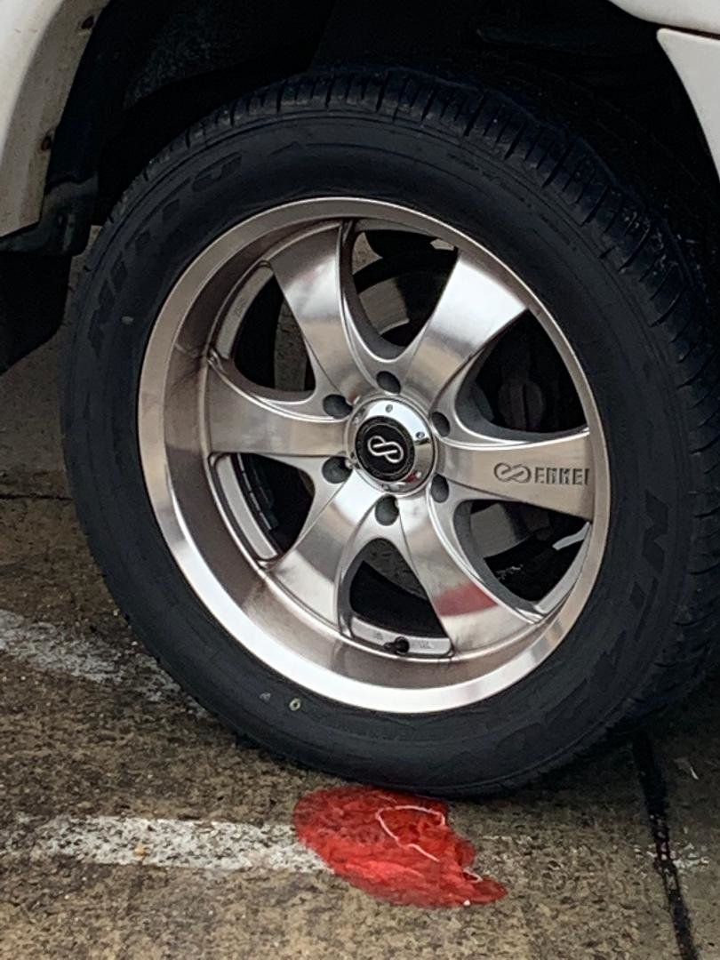

    Original 16'" Enkei Wheels with Michelin 265 70R16. Sadly, no longer available. Hard to find in good condition. The center caps are basically non-existent now. For me this is the best combination for the early Gen1s. For a time I tried an 18-inch aftermarket wheel with a high quality sport truck street tire and it made the ride too stiff and uncomfortable. Switched back pronto.

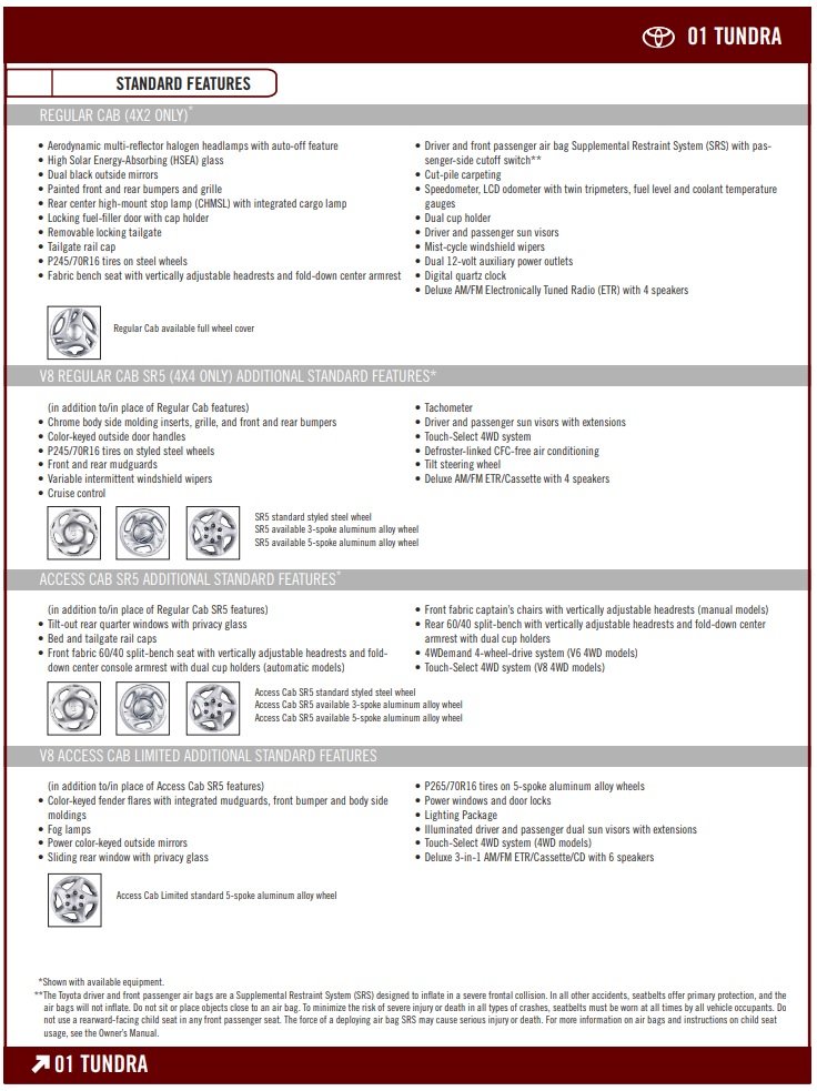

    Each years brochure shows the wheels offered.
    Your 01 MY came with 16" as only option and 2 colors, standard style steel and aluminum alloy wheel. 2003 was the first MY they offered 17" wheels.
    MY 2001 choices....
    1st Gen Tundra Brochures, Owner's Manual and Maintenance Schedules | Toyota Tundra Forum (tundras.com)

    They are 16x7, 6 lug, 5-1/2"
    I got the wheels/tires for $1K, the guy was upgrading his wheels/tires on his Tacoma. These do not mess with the suspension geometry because the offset is very close to OEM and the truck drives great with these. I personally love the machined look.

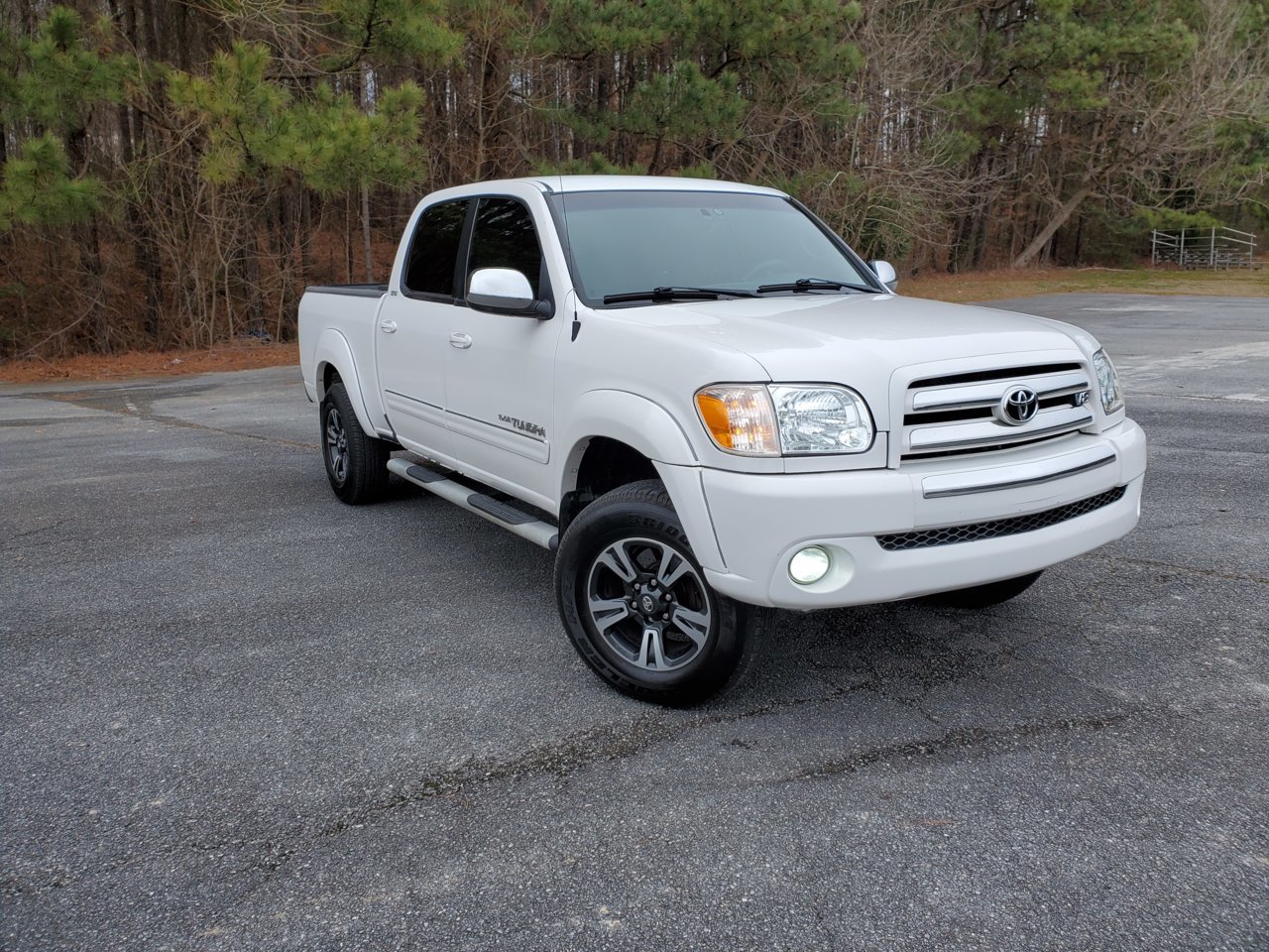

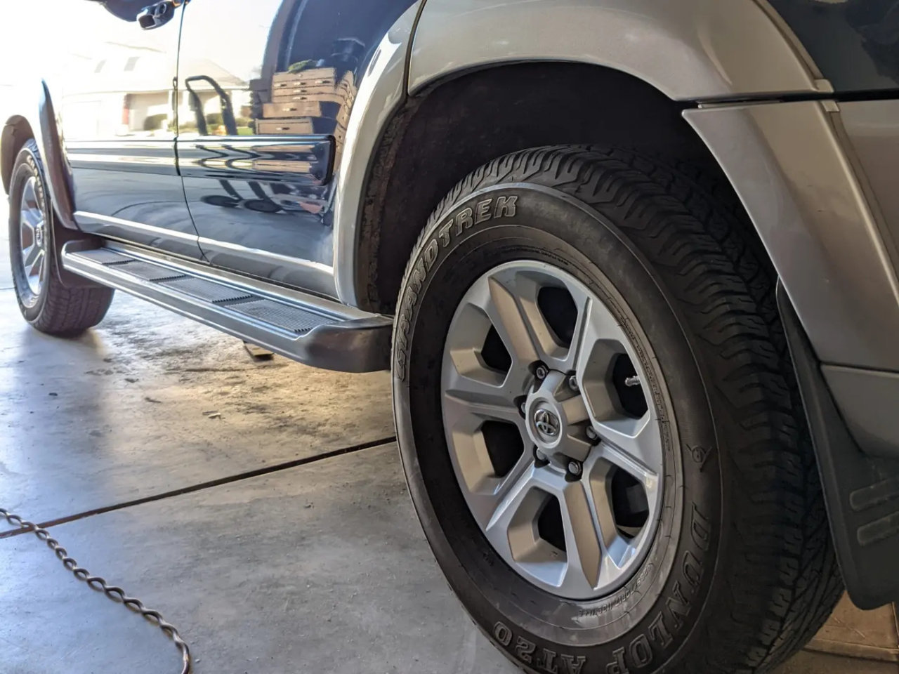

    I put on 06 XSP 4runner wheels. Specifically they are Enkei WT4 wheels that came on the "southern US" package for 4runners. No spacers used. 20x8.5"

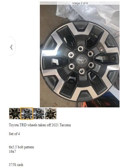

    This is what I am finding locally. These seem like what you have... These should work? No tires though.

    What did you have to do to make these 17" wheels work correctly?

    Those will work, get em and then get some meaty tires to put on them:)

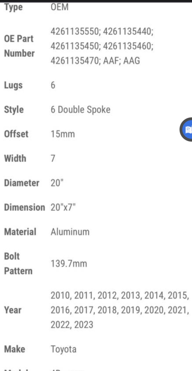

    I keep coming across some nice looking 4 runner wheels for affordable prices but are 20". I imagine those may not work?
    Specs attached.

    The larger diameter the wheel, the skinnier the tire you'll need to wrap it in. All depends on the look and purpose you intend for the truck.

    Remove the old wheels and install these. Nothing else needed.
