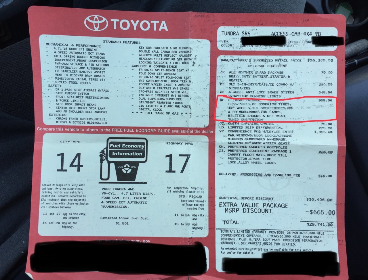

    On his build sheet it looks like he has the limited slip

  15. Oct 25, 2019 at 6:01 PM
    Baller
    Baller New Member
    Jul 22, 2018
    #17275
    809
    '05 Tundra SR5 DC
    That's what got me scratching my head. I don't know a whole lot about the details but, my truck has overfenders/mud flaps, fog lamps and a limited slip rear end and it's not a TRD. It's got me thinking, what would the TRD get you that you otherwise couldn't get?
  16. Oct 25, 2019 at 10:31 PM
    bmf4069
    Sep 1, 2018
    #18880
    9,489
    Beau
    TX
    02 AC sr5 4wd v8
    I'm not 100%, but I think the trd package is just shocks and springs. I have the flaps, flares, and fogs as well. No lsd on mine though.

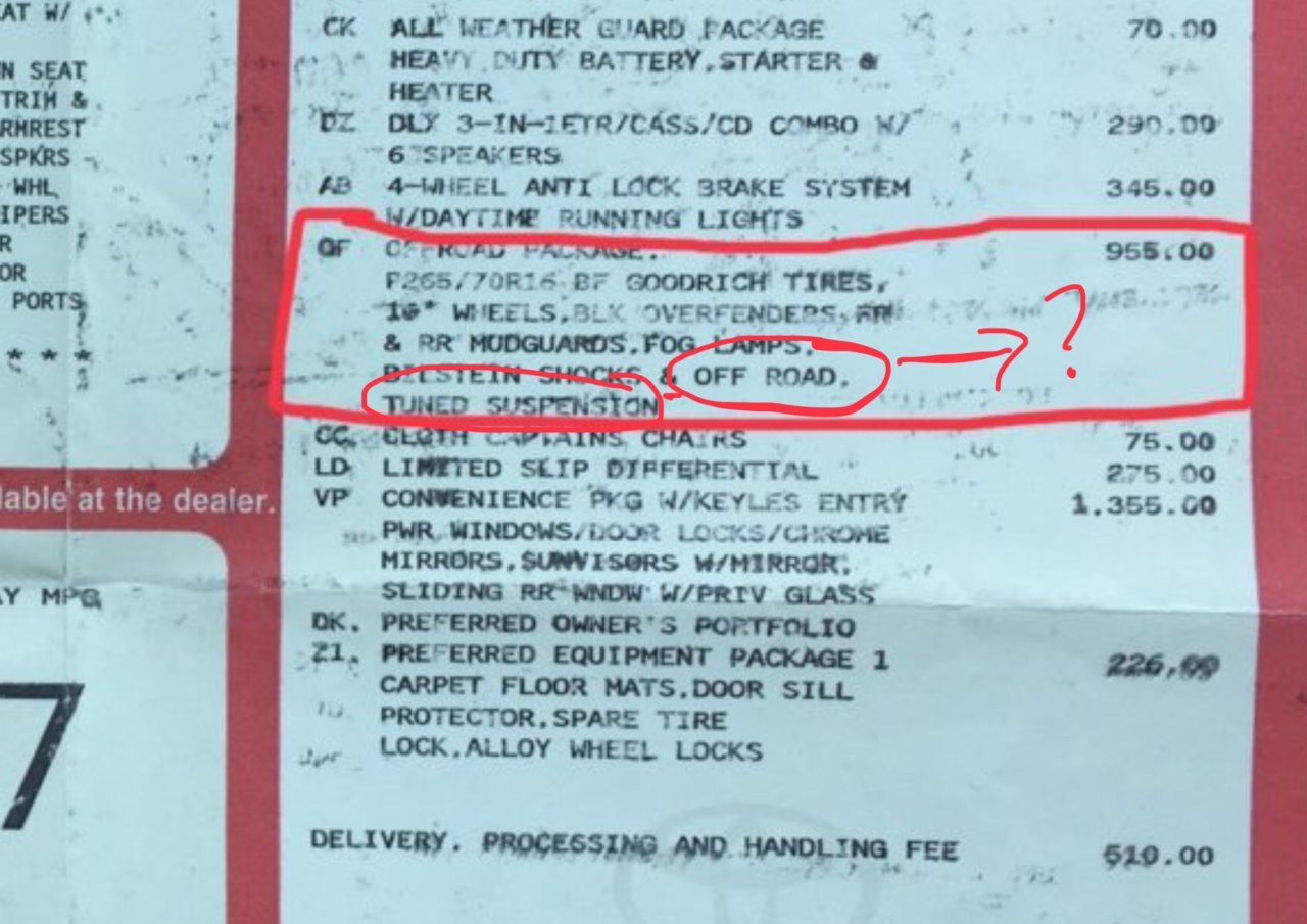

    The water is getting muddy. What comes on a TRD and what can you only get on a TRD (not on SR5) are different questions.
    TRD exclusives:
    Sticker & emblems
    coils (heavier spring rate but all were progressive)
    TRD included but also could be had on SR5:
    Forged alloy wheels
    265/70/16 tires
    Bilstein yellow/blue HD shocks
    Fender flares
    LSD was not included as part of the TRD package. Neither was the tow package. Totally separate upgrades.
