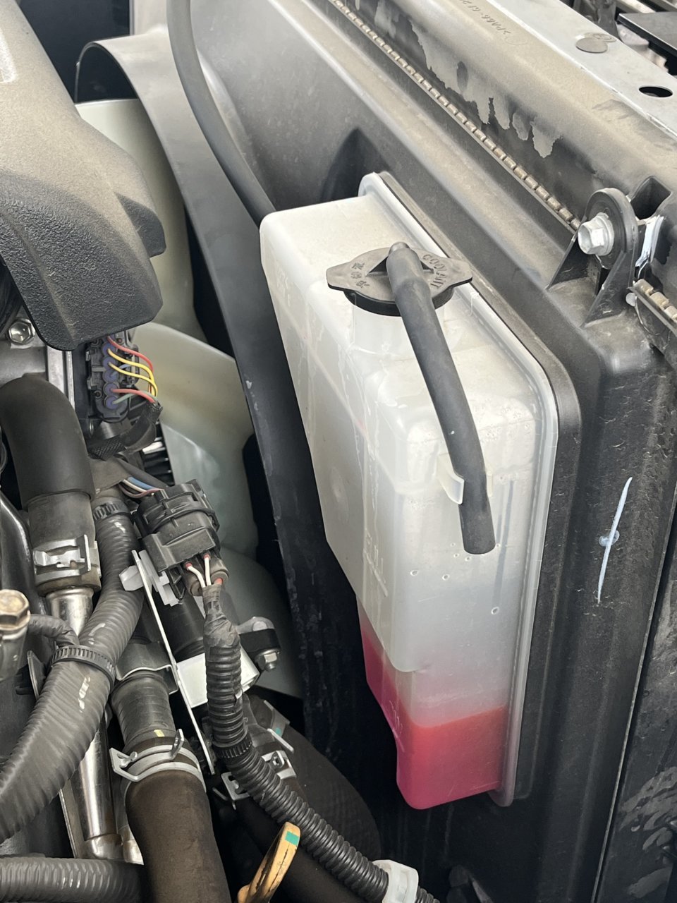

    Looks like it could be coolant overflow.
    you have a pic of the coolant container?

    2019 Cement Limited CM 4x4
    Coolant container is low. WTF!!!

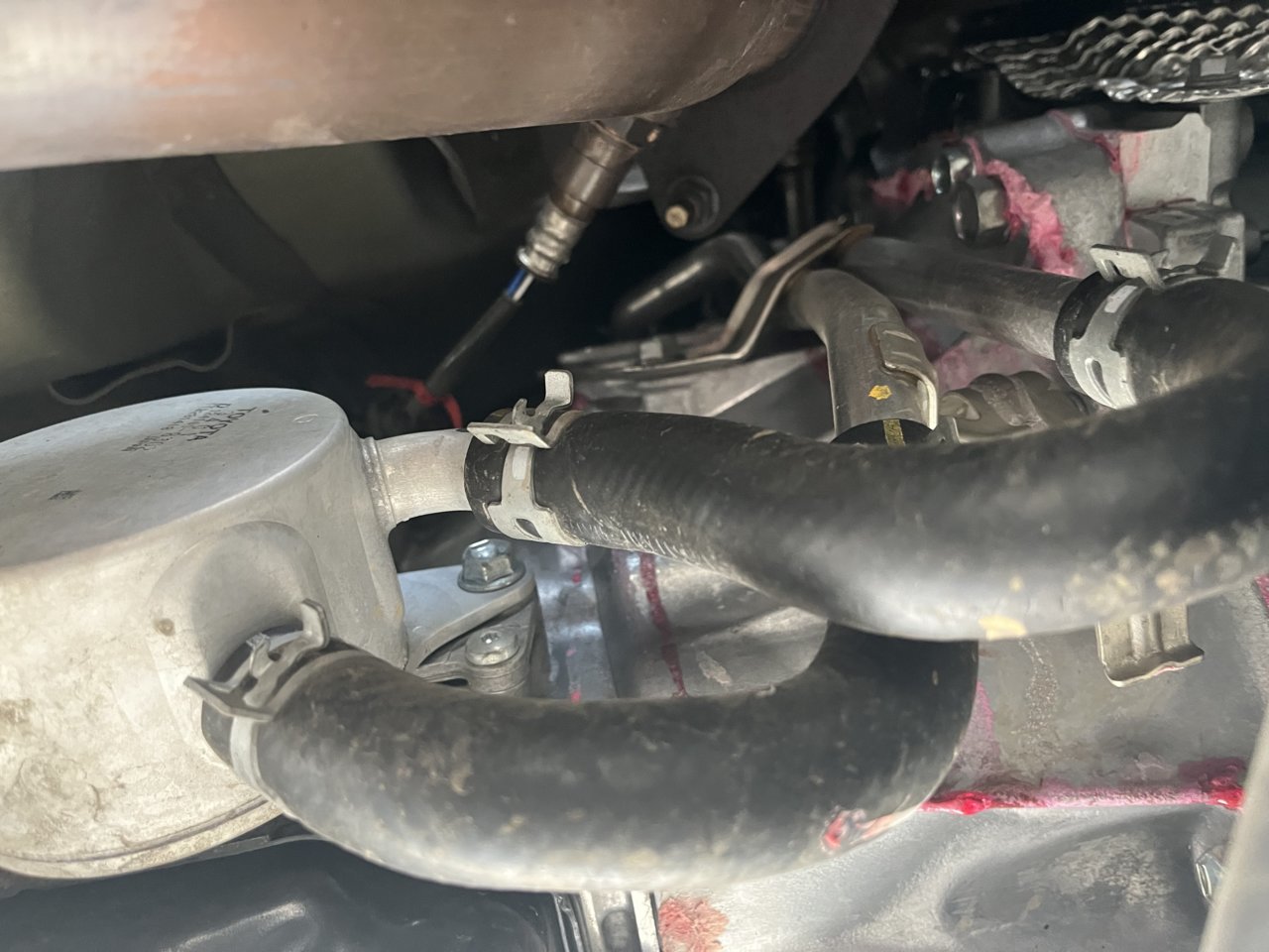

  15. Apr 3, 2022 at 11:19 AM
    29,522
    There's your leak.

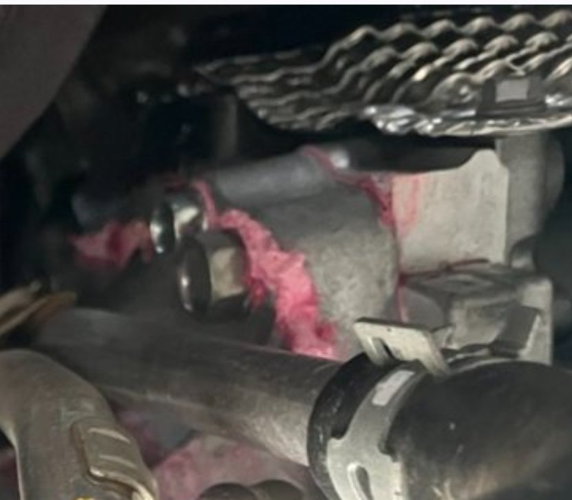

    There is a lot more buildup in that area. It seems to be coming from higher up and running down and collecting around that area. I just turned on the truck to see if the coolant levels rise and if I can see anything.

  17. Apr 3, 2022 at 11:52 AM
    Toyotech170891
    Toyotech170891 New Member
    Dec 28, 2018
    #23627
    17
    2021 Limited Tundra 4X4 Magnetic Gray
    That’s leaking from underneath the intake manifold. Heat exchanger plate more than likely. Uses silicone sealer.

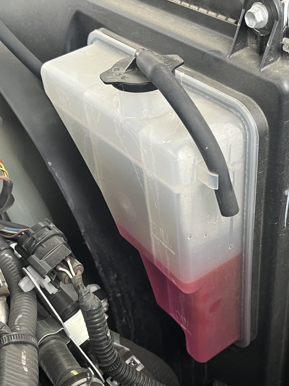

    I just idled the truck for about 15-20 minutes and the coolant container started to fill. Not all the way full but much better. Would you suggest I just let the dealership deal with it @Toyotech170891 ? Thank you all for the help.

    Just a side note: Did you check the oil level after the oil change? I'd make sure they filled the oil and that's not what might be causing overheating. Not that it's leaking oil, but hopefully them not adding oil is not the cause of your engine overheating condition. Way way outside chance but I'd check that. to rule that out.
    Online mechanic advice .... "So, if your car is low on oil, possibly due to an oil leak, it can lead to engine overheating. Oil lubricates internal engine components and makes sure they move smoothly. Lack of lubrication causes friction, which will generate excessive heat, and potentially cause the engine to fail."
    It does look like there may have been some long term coolant leaking going on and you didn't mention the overheat idiot light coming on or temp gauge getting pinned.

  28. Apr 7, 2022 at 9:33 AM
    #28
    TwistedTad
    TwistedTad [OP] TRUCK GANG “T”
    Apr 24, 2019
    #29598
    639
    Tad
    Canyon Lake, CA
    Service advisor called me back today and said the leak is coming from underneath the intake manifold. They took the plate off and re-siliconed it and let it sit for 4-6 hours. They conducted a pressure test and it failed. Service advisor said the shop foreman is involved and may need a new engine block. Craziness for a Tundra with 27,000 miles but I understand that all Toyotas are not perfect. This is my 3rd Tundra but first time I have ever had something like this happen. Picking up my loaner car today. I’ll keep you guys posted.
