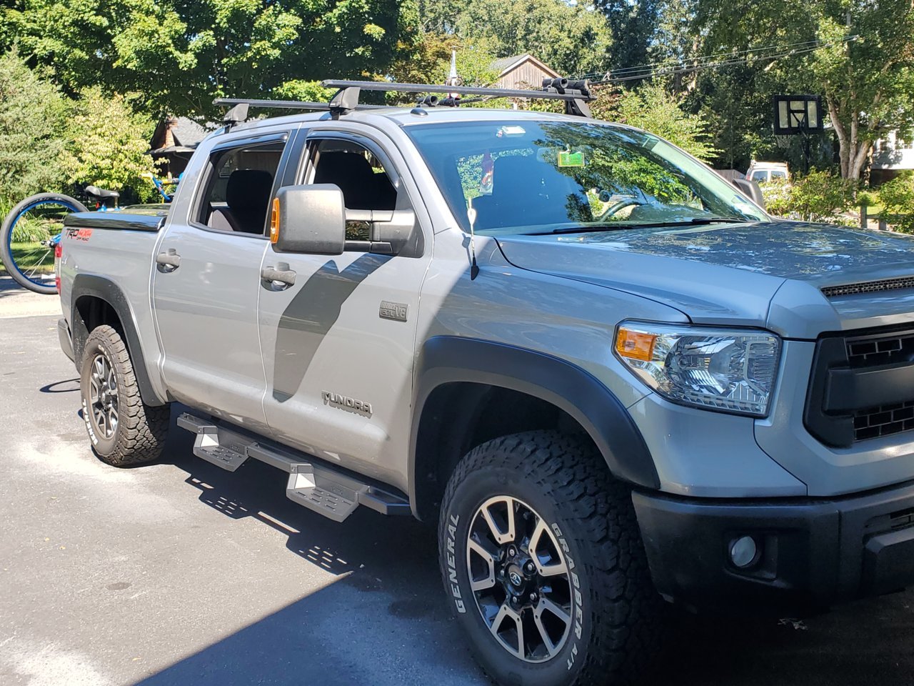

    Can’t you measure the gap that the fenders overhang the tires and then just use that size spacer?

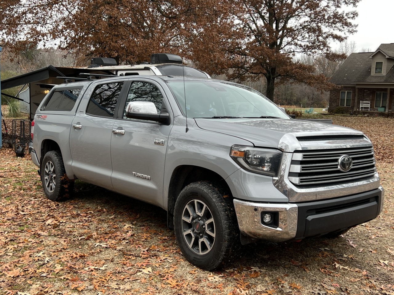

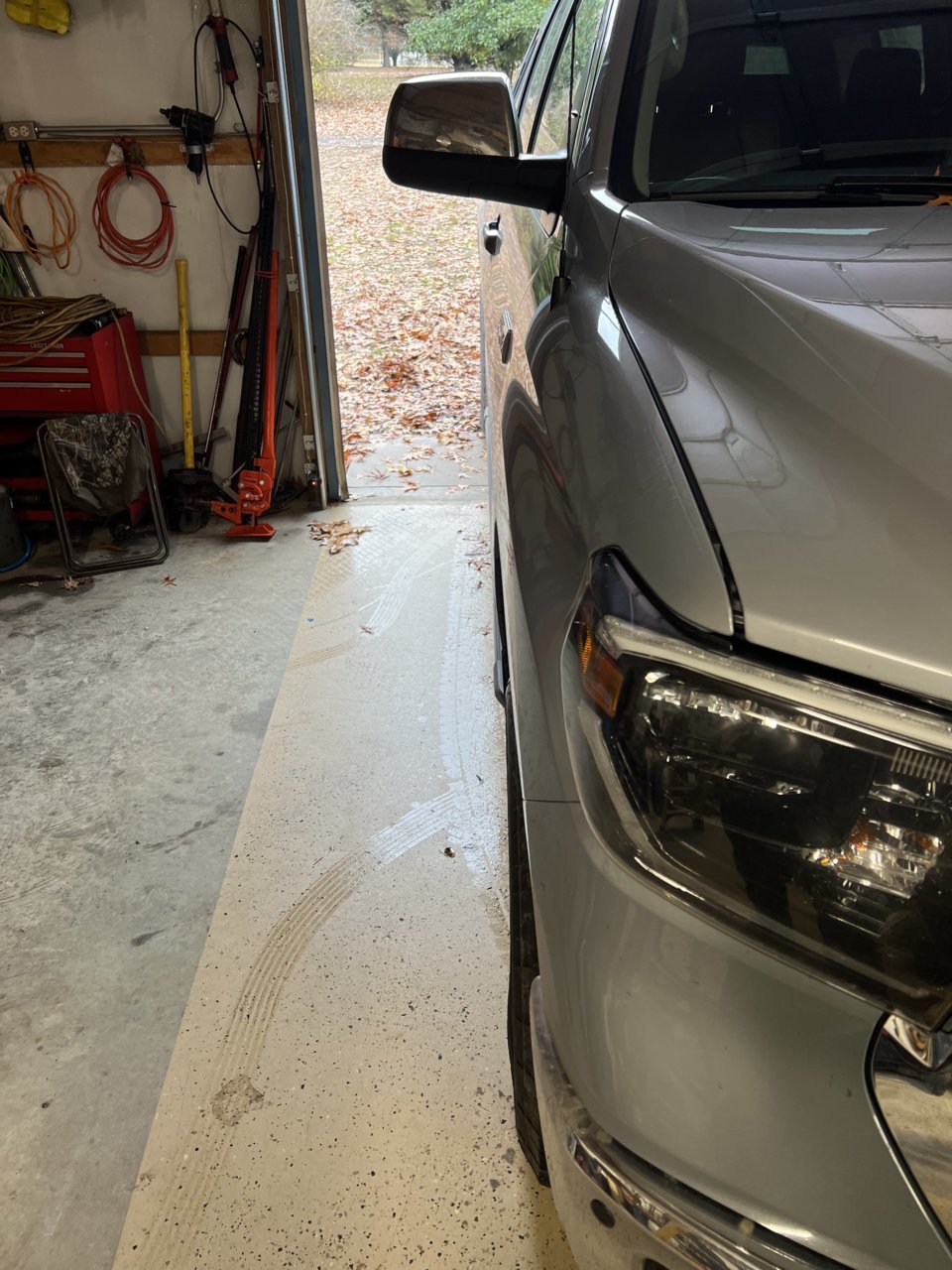

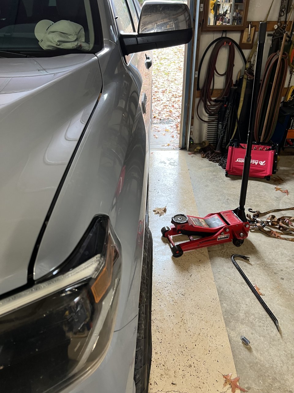

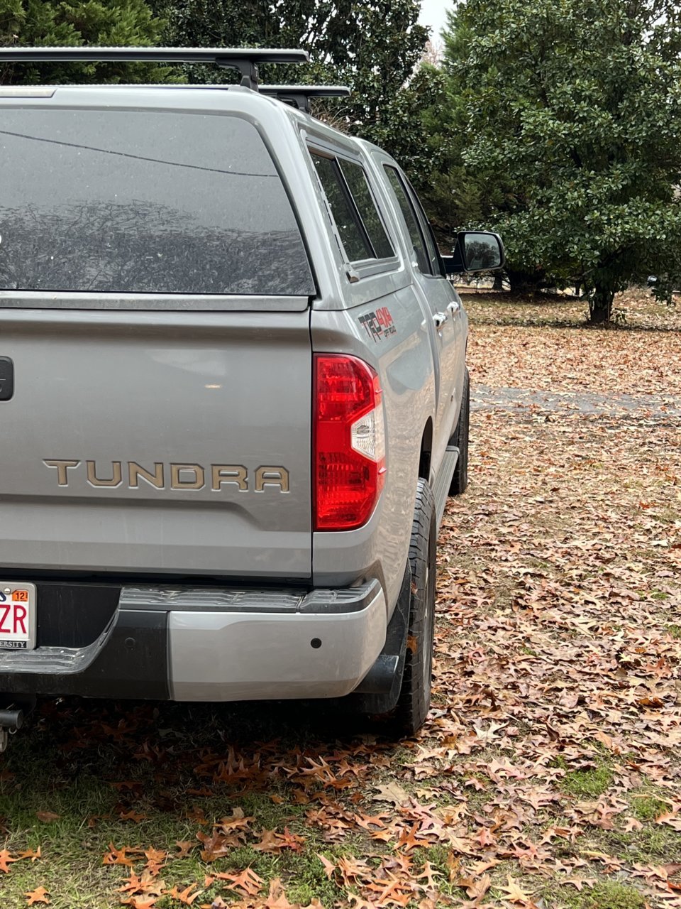

    1” spacers I got from a forum member here.
    Before:
    After:
    side shot:
    Without the running boards:

    I’m thinking the 1.25” are the sweet spot for getting you close to the flare edge without creating more rubbing problems or slinging the rocks and debris all over your paint.
