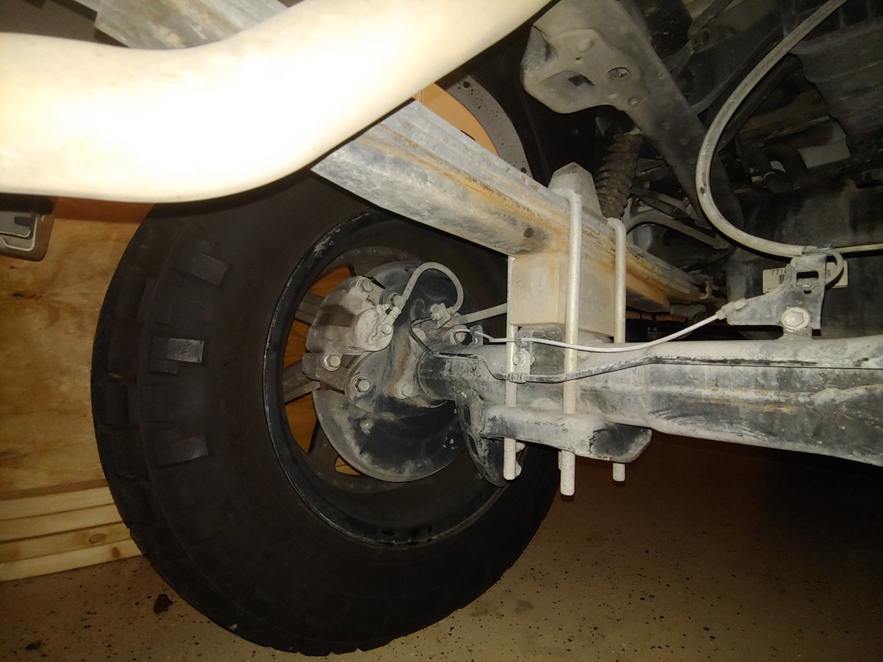

    The 5” bracket won’t tell you. The 3” block tells you your rear was lifted 3”, but your leafs could have sagged since the install. For current actual lift, measure from the center of the wheels to the fenders. Someone here will have stock numbers.

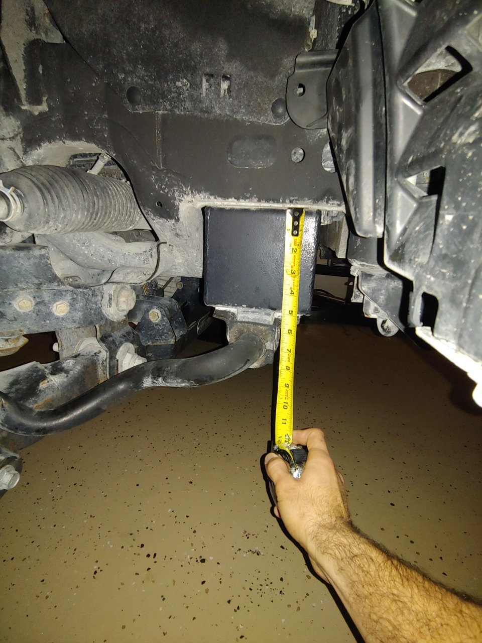

    Tundra2Yak [OP] New Member
    Dec 21, 2021

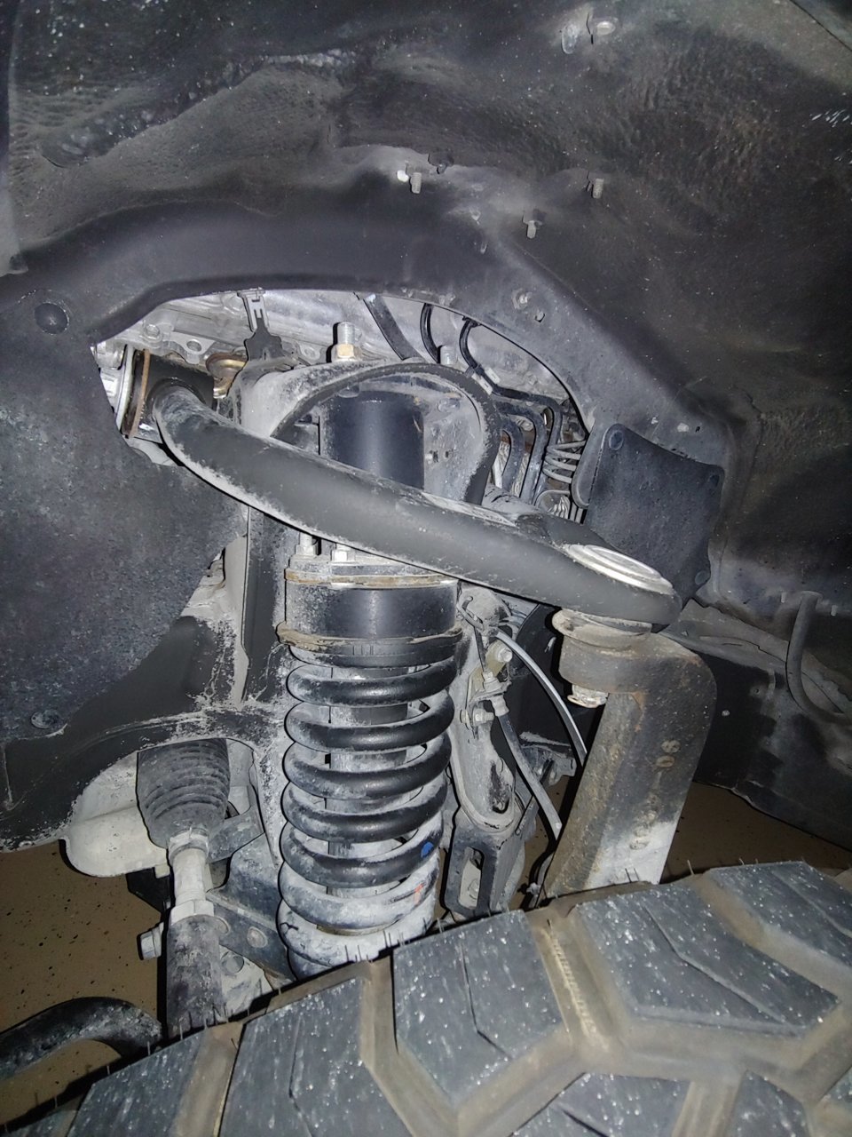

    Thanks @joonbug . Front looks to be around 28.75" and rear 28.25". I did see a thread comparing heights from stock, I'll try to find it again.
    The in-coil spacer is 1.25" thick and the above coil is 4.5" inside flange to inside flange, ~5" outside to outside.

    2015 Sequoia Platinum, Eibach Pro, Bilstein, Tandem Off Road, 12Deg Rock Sliders, RCI, Sherpa Rack
    Looks like the 7 inch kit.
    And it looks scary, that's a lot of spacers.

    The 2 things that I see......I don't know if having an in-coil spacer and a lift spacer above the coil is correct, and those rear blocks highly increase the chances of axle wrap.

    Thanks @Tundra234 . Does the bottom leaf look stock or aftermarket? I'm assuming a new leaf pack would be the ideal setup in the rear?

    That is a stock leaf spring. With that much lift, a custom built pack would be the way to go. Alcan springs are pretty popular as they can build them with the lift. Some of the guys use Deaver as well.

    It seems like a typical pro comp 6" or 7" lift based on pics I've seen of their kits. Is the combination of in spring and above spring spacers the main concern?
    What components would you target to improve concerns. Sounds like a leaf pack would improve the rear end, what about the front?

    Holy :censored:! Just crawled under the truck and saw the sub frame cut. I still don't know what I'm looking at but it definitely does not look reversible.
    Anyone have pictures of what a normal sub frame cut looks like that I can reference?

    A competent welder can weld it back together if you ever need to. But in your case I’d just leave it and enjoy the truck. You’ll be fine.

    @empty_lord you were right. Sub frame is definitely cut. No idea how they certified it although there is a standard exclusion for mods not performed by a manufacturer authorized installer that meet mfr specs so that gives an out for them.
    Will report back with what I learn after first trip to the dealer.
