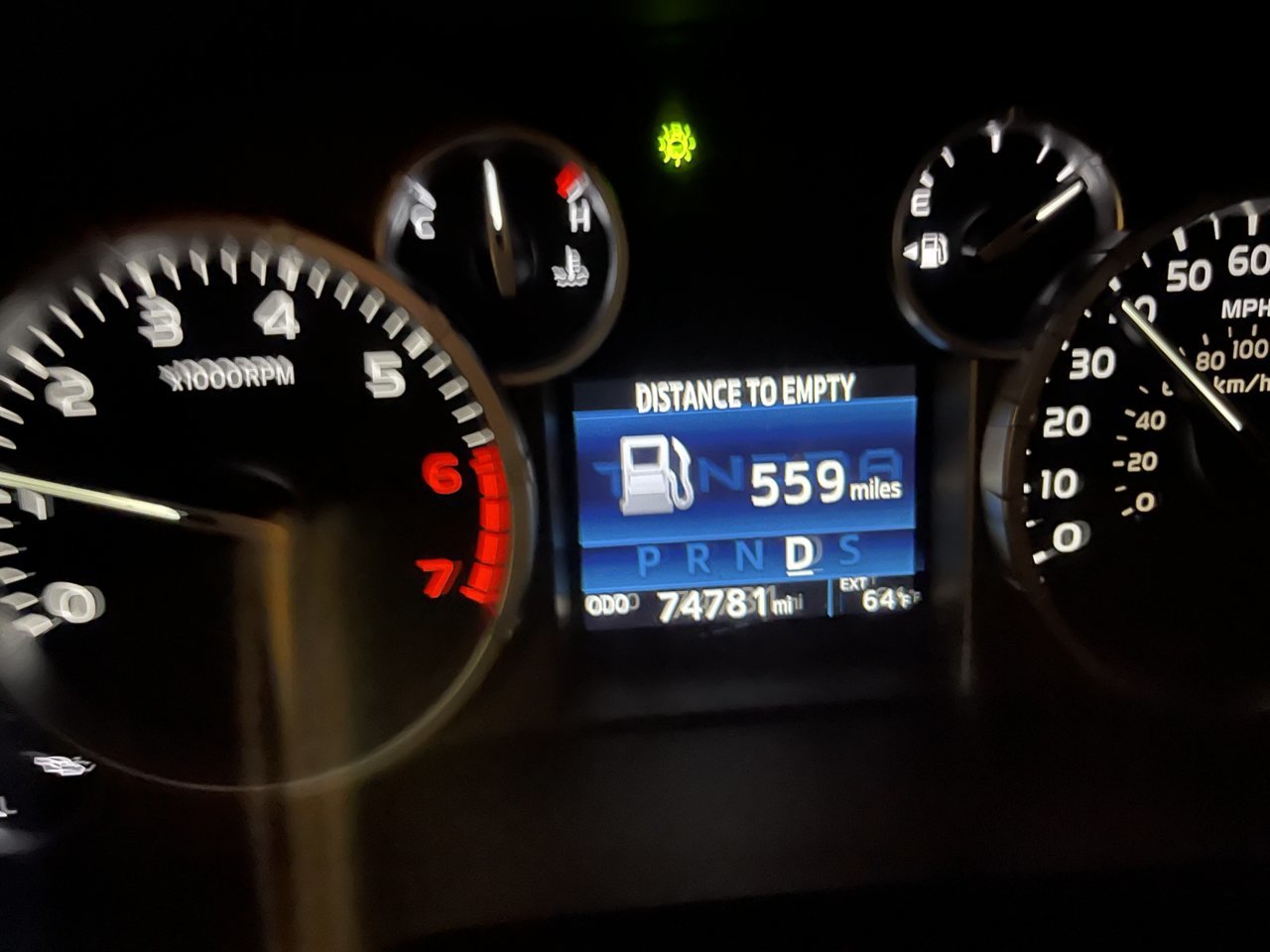

    I have checked the specs via VIN on Toyota’s website. No mention of gas tank at all, so I assumed it was the standard 28 gallon.
    But twice now I’ve filled up to 31 gallons. Is that a normal amount of variation for a 28 gal tank? Both times were at Costco, so I doubt it’s a sketchy pump that’s fudging the numbers.
    thoughts?

    Thanks. I saw all of the threads discussing the calibration and reserve. I assumed that was for aftermarket 38 gal tanks.
    Is there any way to test or verify? When I look up the brochure for my year model, I can’t seem to locate anything that says 38 gal tank comes on the trd offroad.

    Thanks. I was just confused because I expected the spec sheet to show the tank. I guess it doesn’t show that as an option. Lucky me.
    Yeah I know you’re right regarding the 38 gal tank. I was saying I thought all of the threads about the mis-calibration of the digital gauge related to the aftermarket upgrade to the 38 gal.
    It’s so weird the the digital gauge is telling me 0 miles remaining when I have 6+ gallons. I’ll search the other threads and see what you geniuses have come up with for this one.

    The 2nd Gen were 26 gal and filled up full at 20-21 gal after showing 0 on range and E. There is a 5 gal reserve. The newer model I currently have 2018 with TRD off road package is a 38 gal and same thing if I run bone dry on range below E it’s 32 gal to fill up the 38 gal tank. So there’s a 6 gal reserve. I’m assuming Toyota did this to keep fuel pump submerged.

    Says right there under options, SR5 Upgrade Package includes the 38 gallon tank, then in your spec sheet it shows you have the SR5 Upgrade Package, so thusly, you have the 38 gallon tank. There is a big reserve in these tanks, so 31-32 gallons is about what you'll be putting in if you run to 0 miles on the range.

    Yep, you gotta 38 gallon tank. Just for reference, I just recently ran mine down to 0 miles on the range and filled up with 32.6 gallons.
