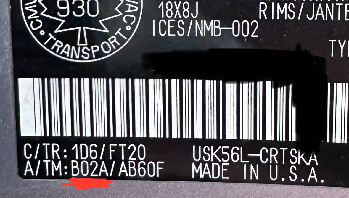

    Look at your VIN card in the door jamb. Google the alphanumeric code underlined in red. That’s your axle code.upload_2024-2-15_8-32-51.jpg
    For example B02A = 4.30 gear ratio, thus 10.5”

    Thanks when I get home I will look that up and make sure mine is the 4.30 10.5 rear

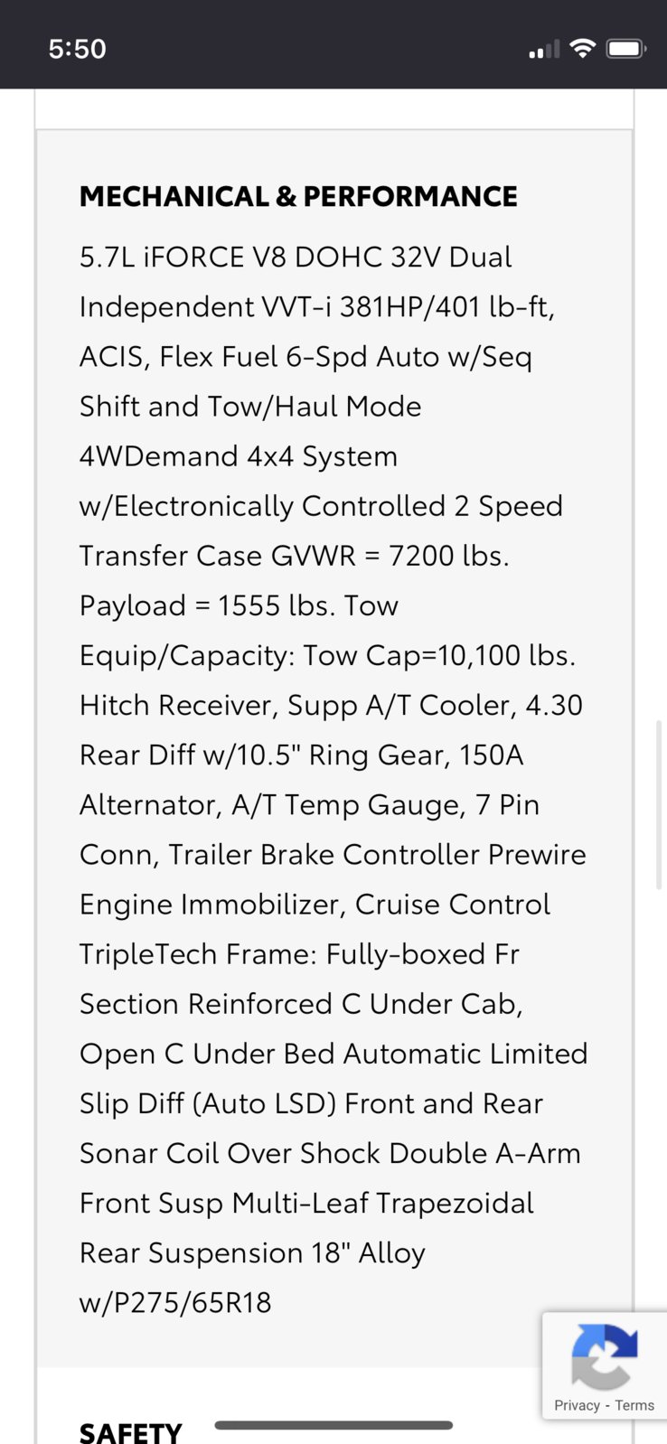

    If you create a Toyota owners account and plug in your vin, there’s a section where it will tell you what your truck came out of the factory with…including rear diff size. https://www.toyota.com/owners/vehicle-specification/
