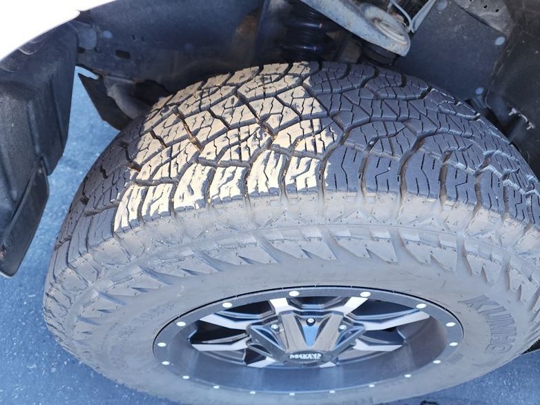

  9. Mar 11, 2025 at 1:10 PM
    mtucker
    mtucker New Member
    Feb 7, 2023
    #91639
    138
    Escondido CA.
    2008 Double Cab
    Listed in my build thread
    I have those exact same tires on my 2008 DC. Kumho AT52 265/70 R18 I did the chalk test and found the rear liked 38PSI and the fronts had even chalk wear at both 42 and 40PSI. At 42PSI on the rear, the outer edges of the tread were not in contact with the road well (lots of chalk left).
    All chalked up and ready to roll.
