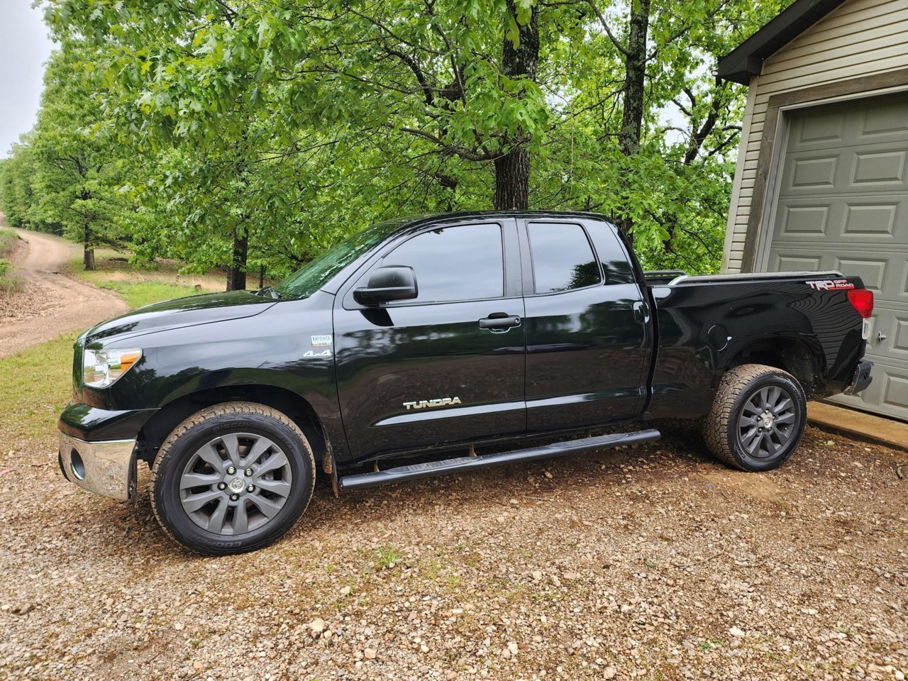

    My 2010 Tundra TRD that I bought a couple months ago. It came with the OEM 20" rims.
    One question for the forum: The driver's side rear rim has a very small crack in it (that the previous owner found and marked) so I'm going to replace the rim. I can get a replacement but I'm not sure of the color. I'm thinking that what I have is the machined dark charcoal. Do ya'll think that's it?

    That’s an oem wheel but not original color/finish.

    Agree, OEM limited 20” wheels from Tundra and Seqouia.

    At the link in the post there are two colors listed (charcoal and dark charcoal), neither of which is exactly what I have; I'm thinking the color is a custom powder coating that I won't be able to match off the shelf.
    The crack is very small and is holding air pressure fine. I'm thinking it might be repairable to use as a spare, since the spare that came on it is 18". Either way, its going to be replaced.

    Spare or not, I wouldn't send my worst enemy down the road with a cracked rim because it could be someone I actually like that becomes a victim. You can purchase some Magnaflux cleaner, Magnaflux dye penetrant, and Magnaflux developer if you want to confirm the crack. Might be able to find some YouTube videos on dye penetrant non-destructive testing to see how it works.
