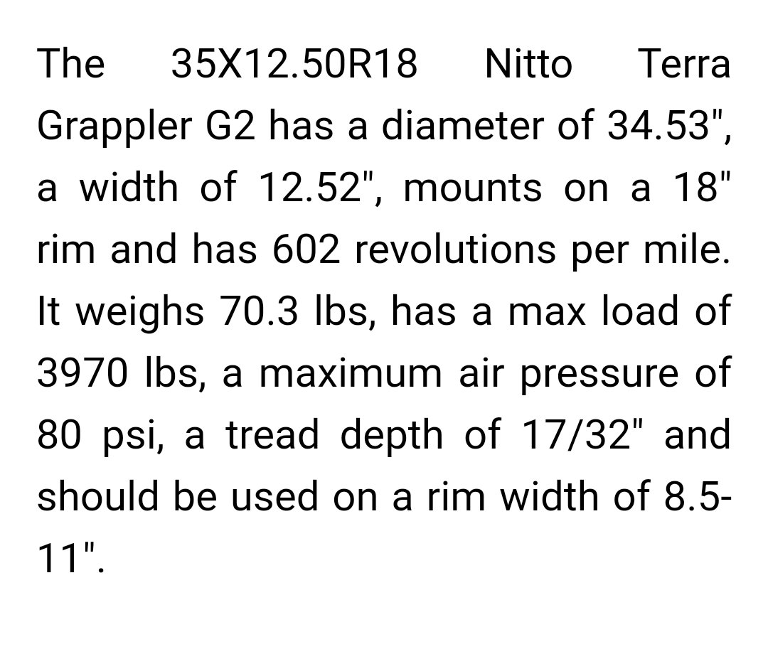

    I've had these for over 2 years. 50 psi seems to be the sweet spot. Tried 40 and 45.Screenshot_2019-11-13-09-04-01-1.jpg
