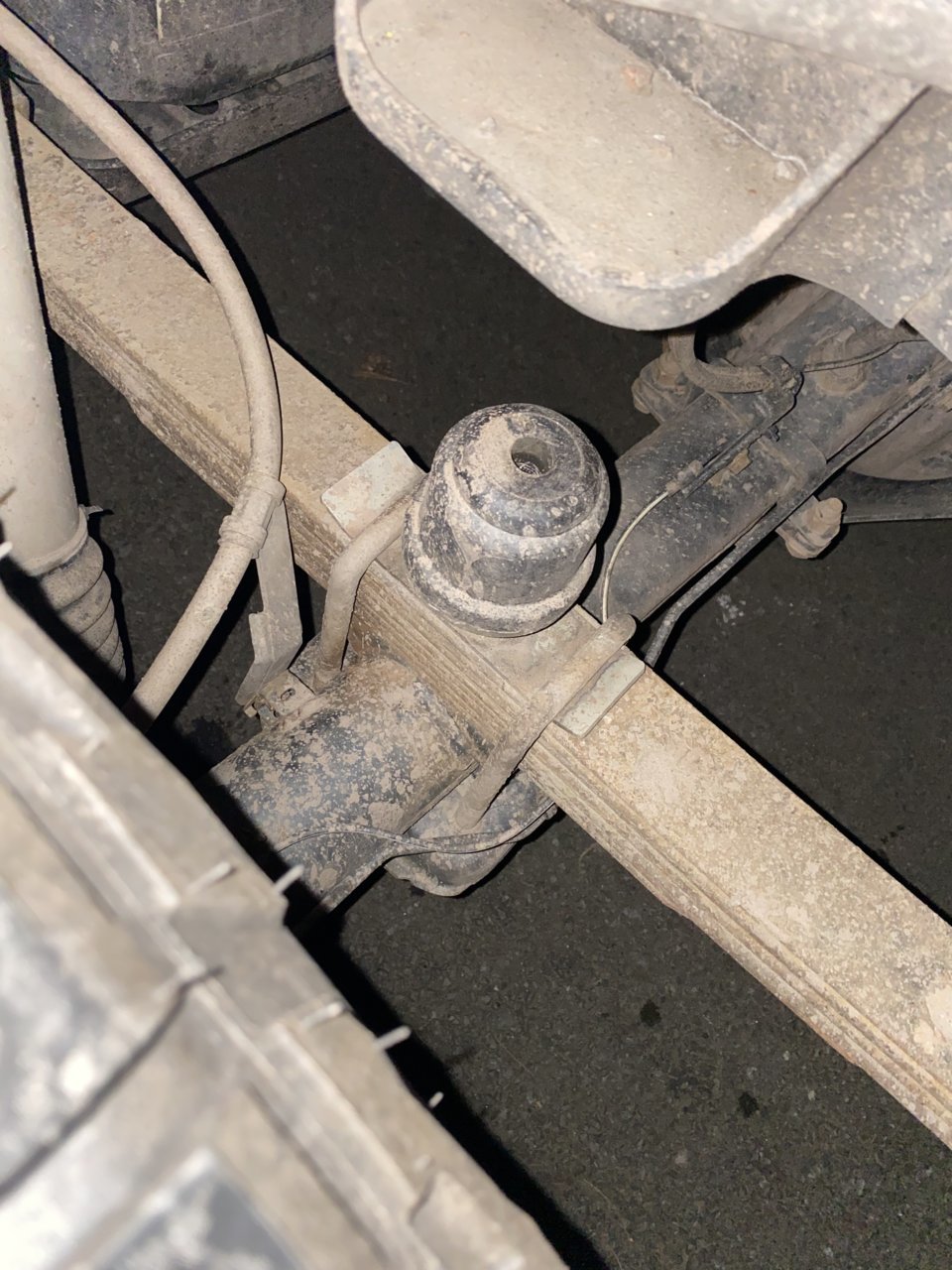

    I run the rxt leaf pack on option two. Coachbuilder plus 2 and icon shocks with resis. A few times a week I load up with over 1000 lbs of material and it works awesome. That being said if you want it level when unloaded and level when loaded. You neee airbags. 1FDD748D-6F38-4901-B7A4-341DCF2554E3.jpg

    This is what I'm looking for. What shocks and are they adjustable? When unloaded, how's the ride as compared to stock springs? Is option 1 too soft? I have airbags and cradles. The center pin where bags replace bump stops seems long. Am I wrong? Many thanks.

    I’ll take a pic when I get home at the bolt. I don’t remember it being much different then stock. Compared to stock springs is amazing. Especially when I have the recommended weight in it it’s so smooth at any speed I feel comfortable driving. Unloaded it’s a little rough not anything bad. I have icon rxt shocks with remote resis and adjustable

    Sdhq might still have Black Friday sales. That’s who I went through. An Very helpful Sorry took a quick pic it was cold and dark. If money isn’t a issue check out the icon rxt pack and the icon rxt shock designed specifically for the leaf pack. I’m sure they work well with other shocks but I went with all icon
