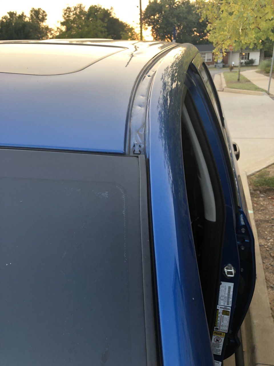

    Anyone know what to search for to replace this strip missing? @Roman ?

    Idk the part number but my wife had a highlander that would loose those in a car wash everytime eventually the dealer put some silicone where the meet up at the clips then it never came off again.

    I began to lose mine on the driver's side a few months ago on my 2015. Applied some 3M spray adhesive, taped it down for the night and it has stayed put for months now.
    Sorry you lost yours!

    Pretty sure it was the drive through car wash or low branches while off roading. I’ll definitely slap some adhesive when replacing

    No problem. Make sure to look and see if you also need the clip - I believe those are sold separately for a couple dollars, not sure if you lost that also.

    Known issue. Your local Toyota dealer should just hand one over. I’m on my third.

    Happened to me on my Tacoma 2012
    Dealer gave me one and it was out of warranty

    I purchased my truck new in July and the dealer was a 5 hour drive from my home. I had one pop up on me on my ride back. I was able to apply some good pressure on it to make sure it grabbed the clip. Additional adhesive would be advised.

    These are known to come off quite a bit. I had one come loose while going 80 miles an hour on the freeway once. It started slapping the cab of the truck and scared the hell out of me. I didn’t lose it, so I just got some automotive glue and stuck it back down.
    Since you lost yours, I’d see if the dealer will just give you one.

    It is definitely an issue. We sell the crap out of these, and on different models besides the Tundra too.

    Picked one up from y’all yesterday while getting oils changed, good to go again!
