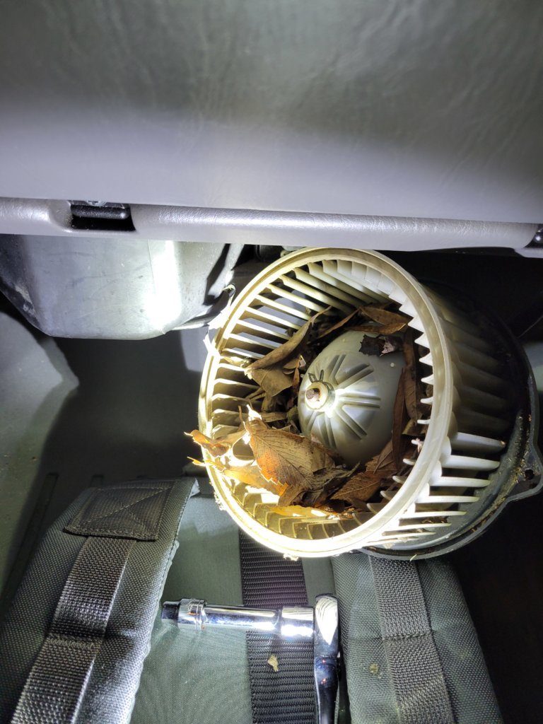

    I think I found the culprit...

    Wow. That's gonna flow so much better once you put it back together. This is probably something everyone should do if they park outside under trees.
    If that's what your blower looks like, I wonder how bad the evap coil and its housing are packed up?

    I can already tell the difference in airflow. And all I did was dump it out and make a few scoops with my finger to get what I could out. I think this weekend I'll give it a more proper cleaning. I'm no expert, but I don't think it was a nest of any sort. The leaves were just loosely in there, nothing was packed down or burrowed into.

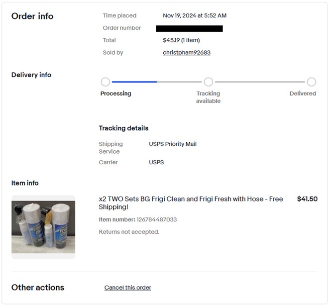

    I absolutely love BG's Frigi-Clean product for eating buildup off the coil, then draining it out of the evap housing's nipple drain on the firewall. I don't love that nipple drains onto the swaybar mount, but ...
    You can get the Frigi-Clean kits on fleabay cheapest from resellers that shouldn't be reselling, but still do. DO NOT buy it on scAmazon, you'll pay 2x-6x as much. Like, on fleaBay right now I see one seller doing 2 full sets for $41.50! In fact, I just ordered it b/c that's too good of a deal to pass up :rofl:
    Guess I'll be doing the truck and our SUV again this month...
