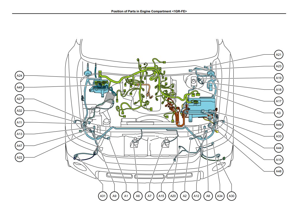

    This is next to the AC high pressure port on the liquid refrigerant line. Is it the high pressure switch or a refrigerant temp sensor (if there is such a thing)?

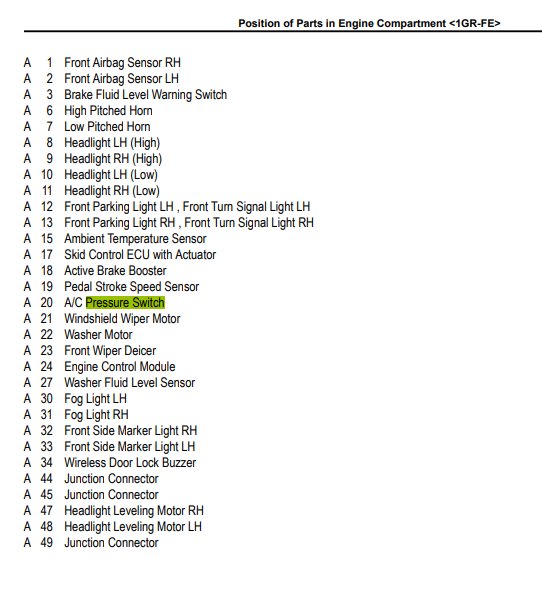

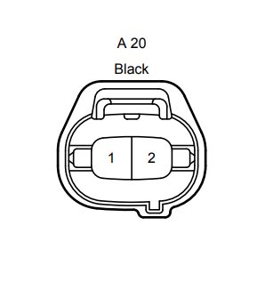

    It's the A/C pressure switch
    Welcome to the forum.
    You might want to post your year model..
