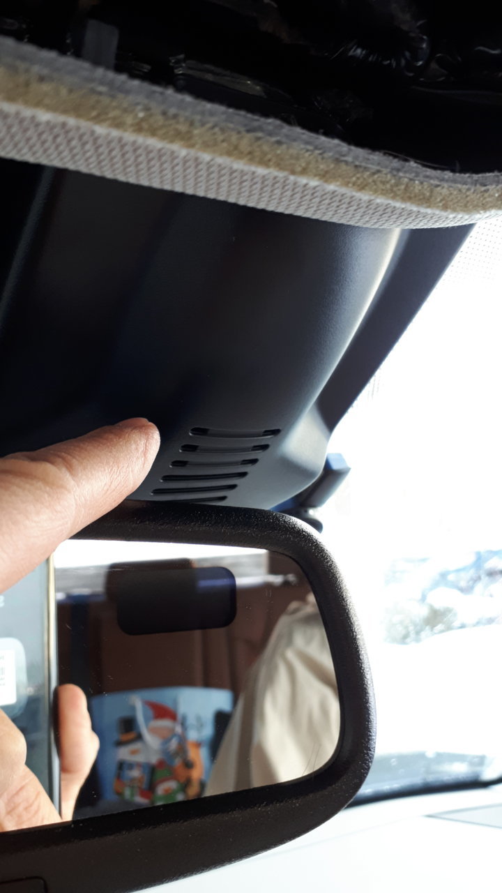

    What is this behind the rear view mirror? is that the phone speaker, i want to know if it comes off. I am looking to stop a snapping noise coming from that area. I see a cable going in it and would not mind wrapping some noise rubber on it.

    It's the camera for the Toyota Safety Sense system. There is that one and then a sensor behind your logo on your grill.

    Safety sense camera housing. Not sure if the slots are for ventilation or what. Maybe someone with online access to the FSM can see about removal if i had to guess just held on with clips of some type. A windshield shop would know for sure.

    No, the camera up there and the radar in your grill work together to identify objects in front of your vehicle.
    They allow your adaptive cruise and pre-collision systems to work.
    You can reposition the radar apparently, as folks have done to use different grills, but the camera I wouldn’t mess with.

    The camera if moved must be re-calibrated. I would make the dealer fix the noise.

    ventilation for the camera, it gets hot

    I wouldn’t be surprised that along with ventilation for the camera there is a microphone. These vehicles uses multiple microphones to do beam forming and backrgound noise filtering using DSP algorithms. So I wouldn’t cover it up in case it messes with your BT Hands Free calling and the other person might have a hard time hearing you.

    Yes it's just a cover life mentioned, revival is easy Just slide it forward at the angle of the windshield
