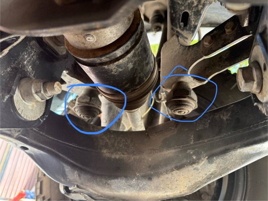

What is this part called ? Toyota Tundra 2019

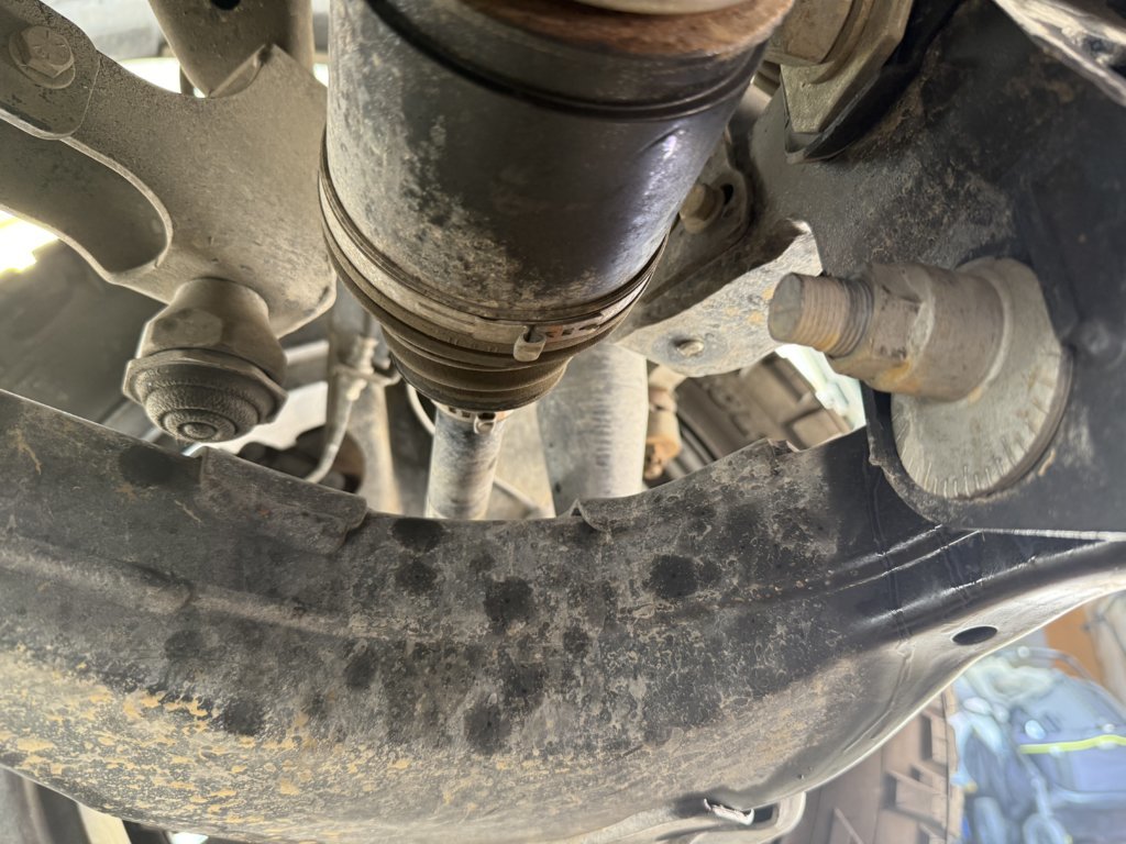

    IMG_0578.jpg I got a Toyota Tundra 2019 1794 edition with a 6” lift . Anyone know what these are called as I was checking the suspension and noticed one was missing and looks like it snapped off.

    Those are your front bumpstops. You can buy better aftermarket ones. A few to choose from. Sumo and Timbren to name a couple.

    I appreciate the quick response ! I’ll do some research on those . Are they fairly easy to replace ? Looks like it’s just a bolt holding on to them

    Haven't done em myself but I'm a certified YouTube mechanic :rofl:and can confirm it's just a simple bolt that screws them in. I've seen that only 1 of the bumpstops per side for the front need to be replaced so you may be better off just getting upgraded ones but if your on a tight budget, I'd look at the junkyards or OfferUp n Marketplace for Tundra parts outs.
