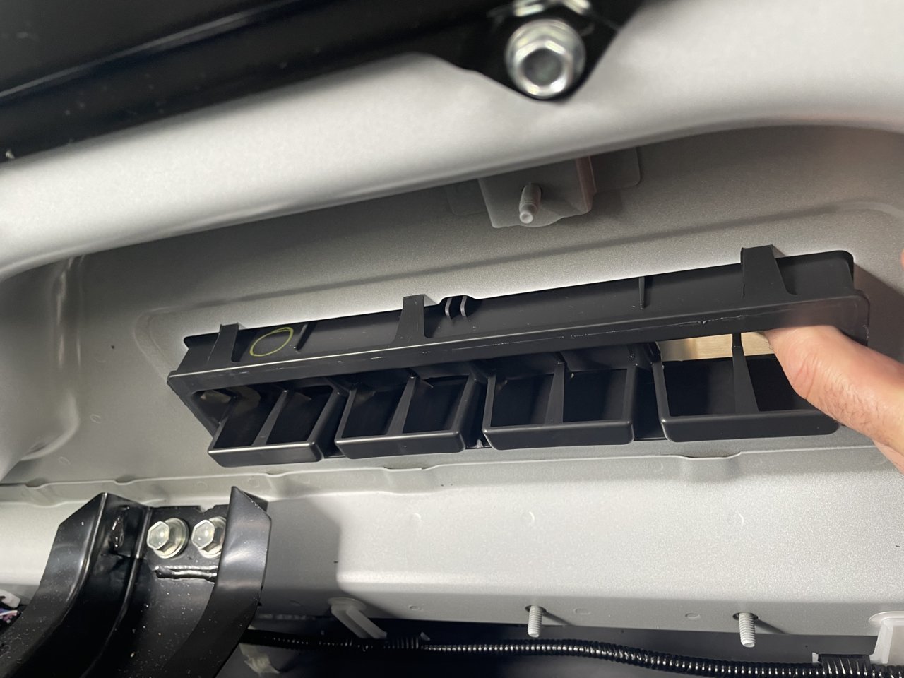

    #80668
    42
    I pulled out the plastic bins behind rear seats of Crewmax for a subwoofer box build. I noticed this piece that has holes to outside covered by thin plastic flaps. It seems like this might be a big source of outside noise while driving.

    #34378
    2,045
    I am guessing its to let air out of the hermetically sealed cabin when you have the HVAC system set to pull air from outside. How else would the HVAC be able to push fresh air in, it would pressurize the cabin otherwise.

    #77186
    503
    Perry
    Indiana
    Blk on Blk 22 Ltd 4x4
    TRD wheels, skid plate, black fender flares, mud flaps and running boards. Pirelli Scorpion 275/70/20 Allterrain Plus tires
    I was told by a Toyota mechanic it is for air circulation and pressure relief when you close the doors so it doesn’t pop the front windshield seal. My 2002 Ford had them so not a new technology.

    Virginia
    2016 Crewmax 4WD, TRD Offroad
    There is always some type of venting for the cab, normal stuff.

    #22085
    22
    2023 CMLB Lim TRD / 03 Tundra Lim AC
    Dual Battery
    Yep, I worked in a Toyota factory - all vehicles have them to prevent over-pressure when closing doors and stuff. If you didn't have that and slammed a door, the people inside would feel like their ears were punched in.

    #72785
    119
    2022 Limited 4x4
    I figured my door seals would have been enough to let the pressure escape.

    #80668
    42
    Same. I understand the logic, however in custom car audio installations it is standard practice to seal up holes like that with CDL / butyl rope. If the pressure were a real world issue that blew seals, caused ear pops, etc - it would have surfaced already. I will be removing that part and sealing that hole in mine.

    If you close it and develop a water drip on your front grab handle you might need to reseal the front windshield and we will all learn something valuable. The thought of it makes me nervous with others reporting front windshield leaks without mods.
