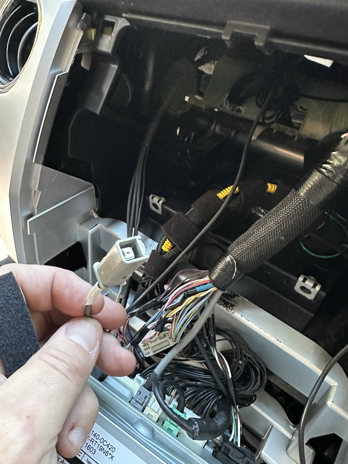

    Installing my Anytime Front Camera harness and as I was reinstalling the Headunit I came across this cable. I'm assuming it was not connected because I can't find any socket that matches this plug.

    Maybe a GPS antenna.

    Do you have built in navigation? Looks like a coax to me.

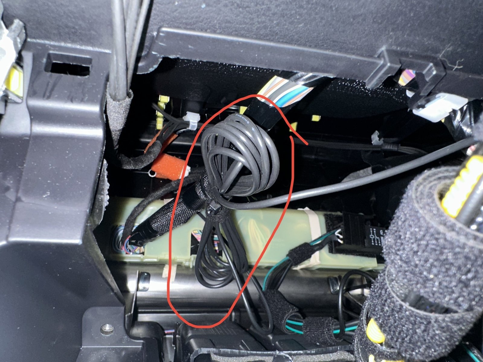

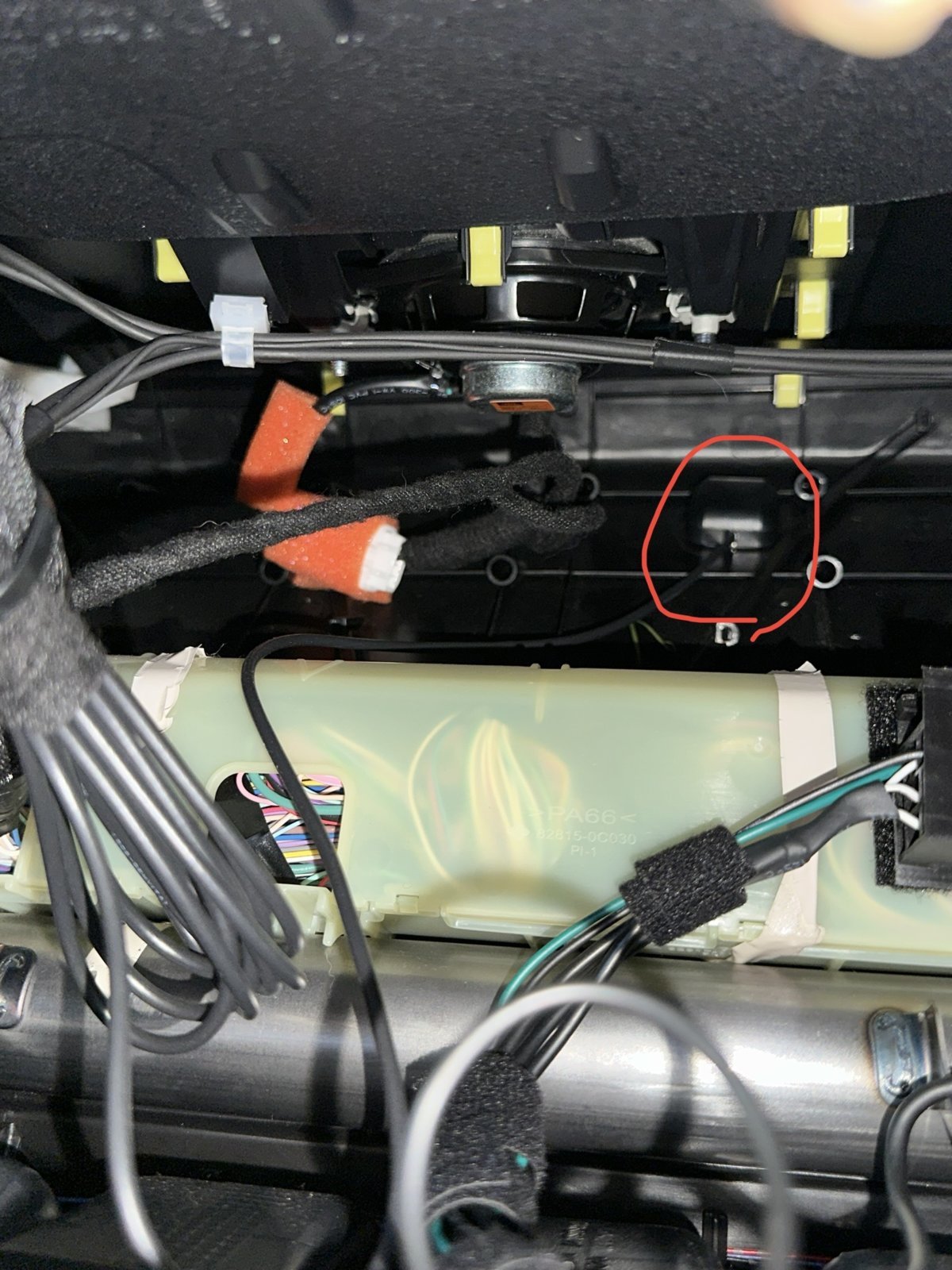

    There is a lot of extra length of this cable bundled up under the dash behind headunit and the goes into the back/center of the dash. Tried to get a good picture of where it goes. Below pics show all bundled up behind the head unit and where it's going to the back center of dash.

    Looks like a GPS antenna

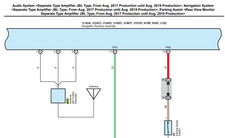

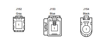

    I'm guessing your Pro has JBL.
    J152 is the antenna
    J153 is satalite radio
    J154 I think is the navigation
    But your connector has rounded bottom corners.
    Must be for an accessory your Pro doesn't have??
    I agree with @Retired...finally that is does look like a shielded coax.

    That is aftermarket
    Factory doesn’t use zip ties or have extra lengths of cable looped up like that
    It is likely for aftermarket GPS or SiriusXM associated with a previous non factory HU. Your TRD Pro CrewMax will have factory JBL stereo, and the factory GPS antenna is white with a half-circle bottom, while factory XM antenna is black but the same shape (J154 is the XM).
    J152 isn’t used on the 2020/21 trucks any more.

    Yeah, I knew that Don hadn't done any work o. The headunit or dash. Must just be a gift from the plant. I later noticed a strip of tape on the top of the head unit. I'm thinking it had been taped down there. No clue what is was for, but definitely from the manufacturer based on where it went into a molded plastic pod at the very back of the dash. I was thinking maybe rain sensor but someone else mention glass break detection???? Oh well, I never found anything it could plug into, so I carried on. Spent most of day working on the truck today and didn't really finish anything I started, lol.
