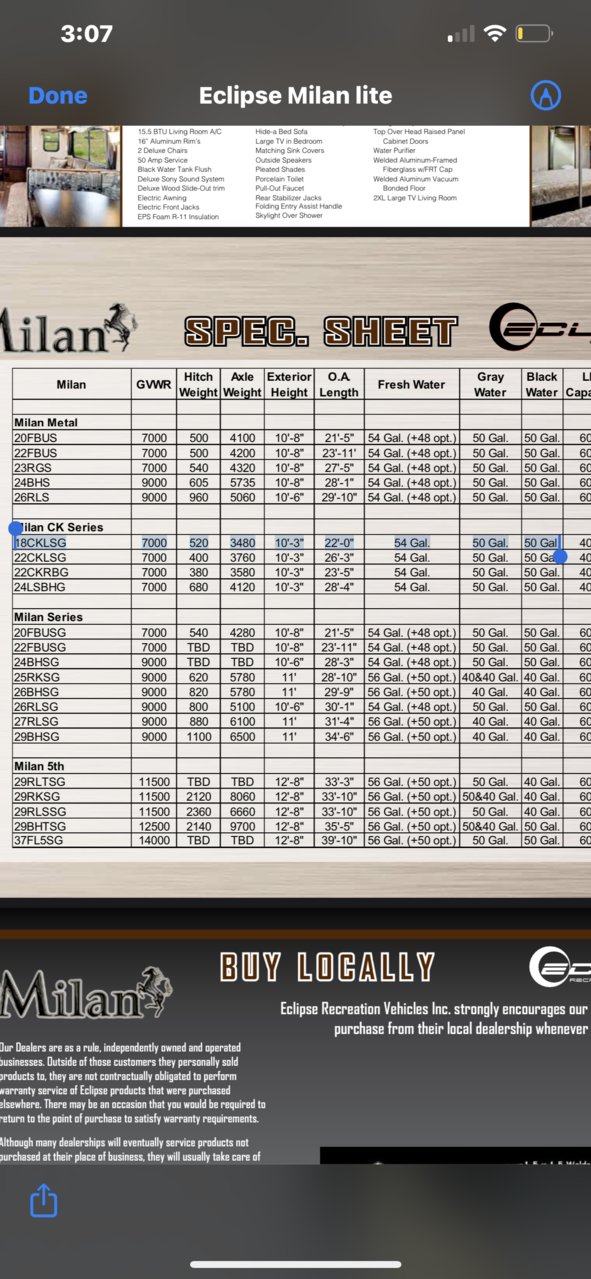

    So I’m selling my Tacoma because I bought a travel trailer and my Tacoma cargo is only at 1050lbs... well with 4 people a dog and tongue weight of trailer we are at 100lbs over cargo weight smh. What’s is the tundra 4x4 crew max 5.7L years 2014-2018 payload or cargo weights in these trucks?

    Which trailer do you have? I'm impressed you found one that's close to being within your payload capacity. Is that based on literature or did you actually weigh the hitch when it's loaded?

    I found the brochure online about my trailer and used the sticker on my truck door jam to do the math. What the brochure doesn’t say if that’s a dry weight or loaded with 2 propane tanks and 2 or 1 batteries

    That will be dry weight without battery, propane or anything else. I've also heard the manufacturers tend to underestimate the dry weight so you may want to weigh it yourself both empty and loaded. You're asking all the right questions but just be aware that Tundra payload is low compared to the competition so you may want to look at other brands or even at heavy duty trucks.
