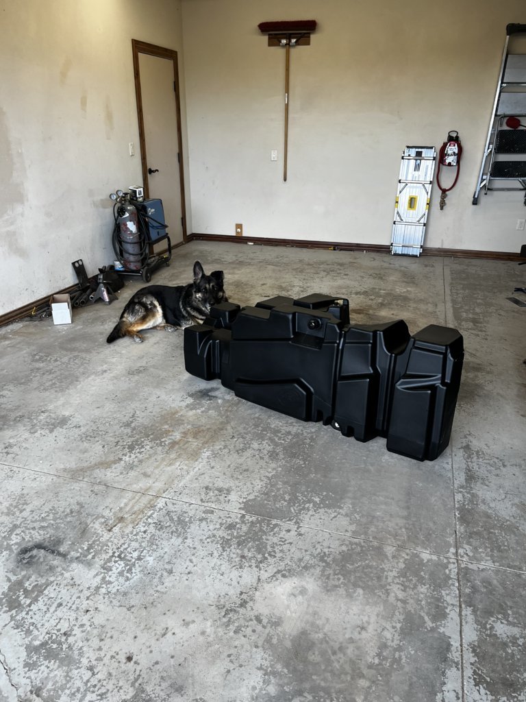

    I remember those days of 120 miles max. I would even keep a couple Jerry Cans in the bed in case I came up short.
    You could always look into a 38 gallon tank or go aftermarket. Like you, I went the opposite way and went back to diesel. Still a 36 gallon tank sucked ass. I finally went with a 62 gallon tank and haven't looked back. Late last week I did 600 miles and still had 12 gallons left in high wind fuel sucking situations. Cruise control on 75 mph...let it rip.

    Do believe that one of the first mods I did to the Tundra was one of the most valuable. Replacing the oem 28gal tank with a transfer flow 46gal tank. 600 miles per fill is easy. If I were hauling heavy, I’d definitely go diesel, but my trailers and boat are fairly light.

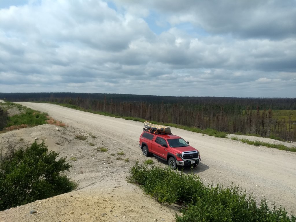

    I did 708 miles on 38 gal tank this summer, wasn't even dry. Had a 60 lbs canoe on top and couple of hundreds lbs of gear in bed. About 500-550 lbs of permanently mounted steel stuff and heavier 33" LT AT tires. Of course, speed wasn't very high. Anything over 65 MPH kills MPG.

    Same here. No way I would own a diesel if my weights were under 8-9k.
    Best mod so far and has paid for itself already. I choose where to fill up at the better priced locations. Some fill ups I can save up to 45.00. That adds up rather quickly.

    What are y’all paying for the tank and installation?

    I also tow in 5th when conditions allow for it. As mentioned by @Johnsonman the torque converter will unlock and allow extra heat to build in the transmission. You can usually tell it is unlocked as the RPM will climb by about 300 rpm and feel like a half shift. If my converter is unlocking constantly or wants to stay unlocked, I will drop down to 4th. Else, the truck will handle towing in 5th. As to RPM, you are just fine running in 4th at highway speeds towing. But the truck will run through the 26 gallon tank pretty fast..
    Transfer flow is a good option. If you are handy or can convince another shop to do the work, you can install a factory 38 gallon tank in place of the 26 gallon tank without too much hassle. Or so I'm told. It's on my to do list.
