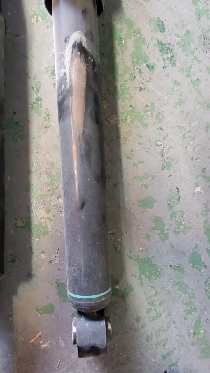

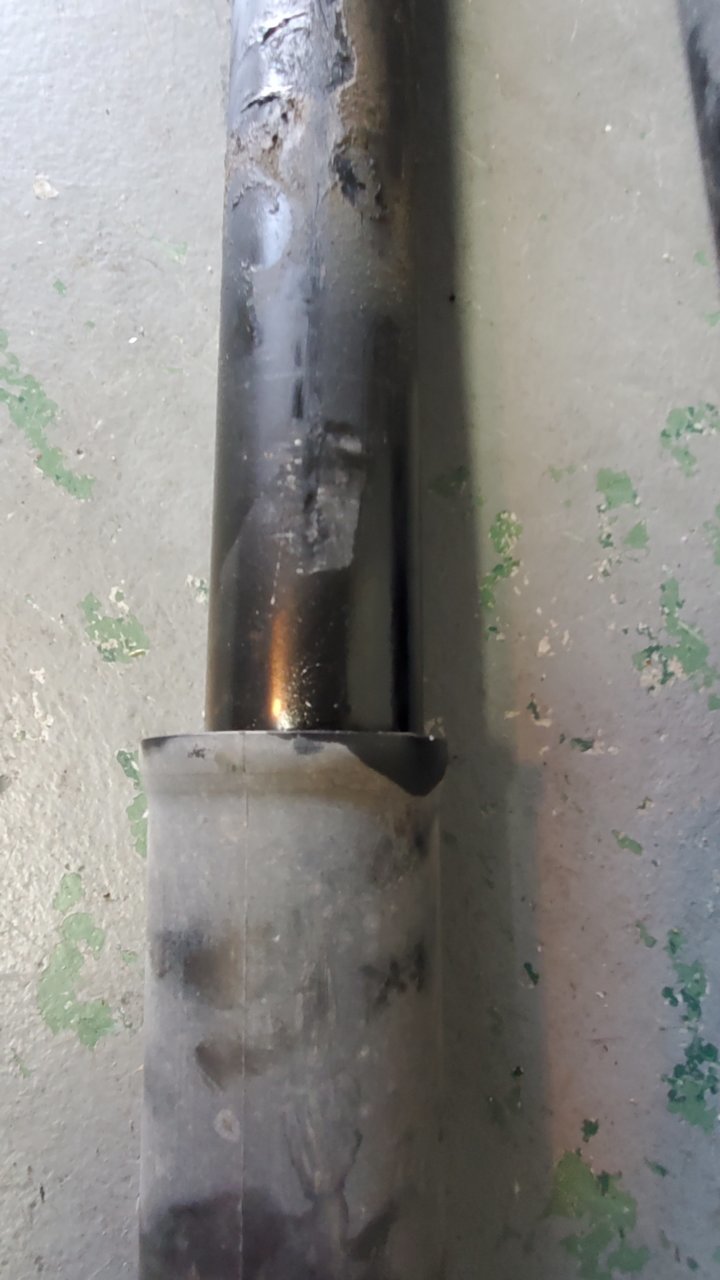

    So, at 18,500 miles my right rear shock decided to puke out most of the fluid that was inside it. After replacing both rear shocks, I noticed some significant rub marks on both sides. Actually, the driver's side was worse so far as the rub goes. What would cause this? The roughest terrain it's been on is maybe a total of 10 miles on rutted (dry) gravel road at low speed (below 25 mph). Otherwise it's been a street queen/highway cruiser. Pulled a 6x10 utility trailer with brush on it a total of 40 miles (20 miles empty, 20 loaded). Once I did drive it 900 miles with maybe 4 or 500 lbs in the bed plus me, the wife, and luggage up front. What I'm trying to say is, as trucks go, this one has been very lightly used, so I'm not sure why I'm seeing this, or if it's even something to be concerned with?
    Driver side:
    Leaking Pass. side:
    Leaking Pass Side 2nd mark:

    The rubbing is from that plastic sleeve. That sleeve flexes and moves.

    I hadn't thought about that sleeve making the marks. But I can't think of anything else that would be making contact either.

    The sleeve marking is fairly normal. As for leaks, the black shocks are the cheapest ones that Toyota uses. Their average life is about 35K miles.
