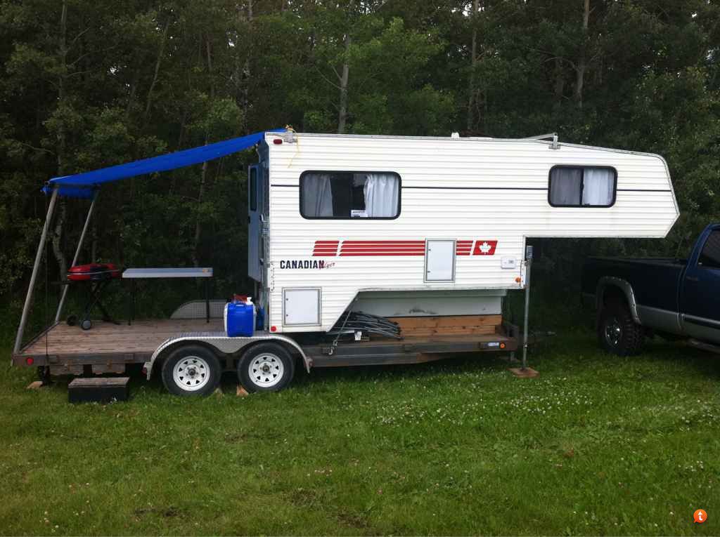

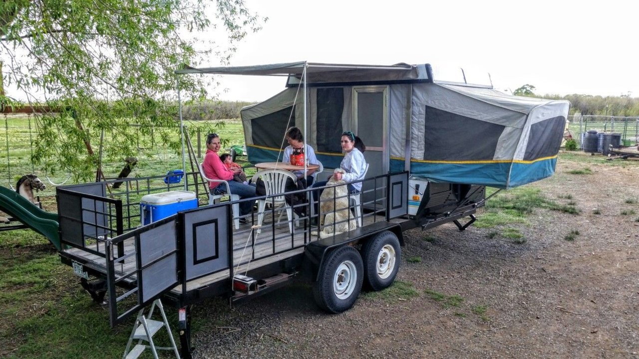

    Man I love this setup! They sell these as toy haulers — usually with the storage part fore and the popup camper aft — and they’re pretty expensive. This could be a great compromise. How did you get the camper on there? Jack it up and slide the trailer under or what?

    just an internet pic. But yea, i'd imagine that would be a way to do it. A rooftop tent might be a good option for mounting to a trailer, but i'd bet an old popup could be had cheaper.

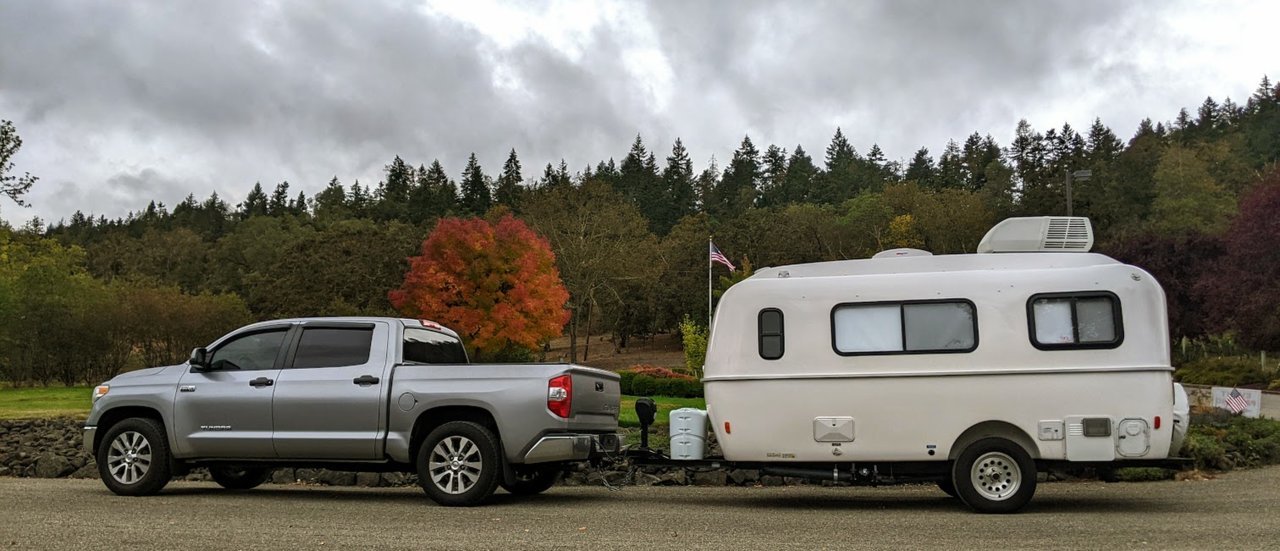

    We have a 17' Casita which weights about 3100lbs loaded. It has trailer brakes and we also use an anti-sway bar, no WDH. The highest tongue weight we've scaled was 440lbs. We've towed cross country and multiple 2-3k mile trips. This trailer behind the Tundra is barely noticeable, stopping for gas, food, etc is very easy. I agree a double axle will track and handle a blowout better. We've gone through the trial and error of proper loading to get the best experience, honestly this is something I've gone through with any trailer. I wouldn't consider towing this without trailer brakes, especially on city streets with lots of stop and go.

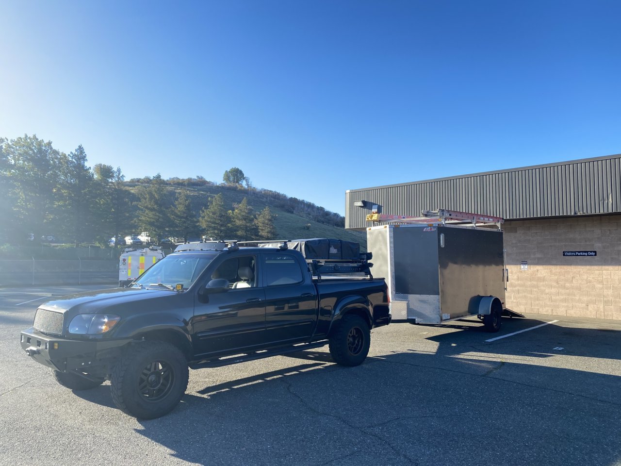

    Pulled it with my 2005 AC prior to moving to this truck. I honestly preferred the 05 as it was slimmer and shorter, but families.
