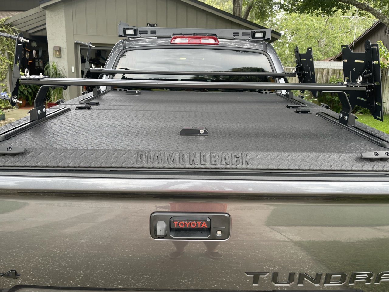

    Installed LED "Porch Lights" on my roof rack. My intention was to connect four lights that could be controlled by the OEM cargo light switch on my dash. I also wanted to be able to independently control the lights for each side, since I use my CVT canopy on either side of the truck depending upon my camping site. Most importantly I wanted to avoid drilling any holes in the roof to run the wires if at all possible. Thanks go out to @junior and his "My DIY Roof Rack" thread which gave me some ideas as to how to accomplish this.
    These lights sell for $99 a pair for this rack from the manufacturer of the rack.
    https://www.victory4x4.com/product/VRKLED.html
    I found the exact same lights (check the specifications on both sites) for $14.95 each so I purchased four of them.
    https://www.superbrightleds.com/mor...ch-and-utility-light-700-lumen-12v/5568/9848/
    The light kit from from the rack manufacturer comes with CNC cut backing plates. I bought a Harbor Freight 48" aluminum ruler for $4.99. To make my backing plates I cut them to length and drilled holes for the bolts, it was the perfect width for the cut outs in the rack.
    I spray painted the backing plates with black enamel. These are the parts I used to make my wiring harness for the lights.
    2 - waterproof boxes from Amazon.
    https://www.amazon.com/gp/product/B08N6P4HPH?ie=UTF8
    2 - pigtails to fit my cargo light bulb receptacles.
    https://www.amazon.com/gp/product/B0837SZ1NJ?ie=UTF8
    2 - small waterproof switches
    https://www.amazon.com/gp/product/B07LCH1N3B?ie=UTF8
    I didn't end up using the 2 pictured male and female Deutsch connectors for this install, I soldered my connections instead. I also used marine grade adhesive lined shrink wrap on all the connections.
    I removed my cargo light LED bulbs and installed the pig tails. I drilled two small holes through the plastic top of my cargo/third brake light receptacle. I used rubber grommets and black silicone sealant on both sides of the holes (not shown).
    I ran the wires along the inner side of the rack and mounted the waterproof box behind the Victory logo using that cutout for the bolts for the box.
    I mounted a waterproof switch on top of each box to keep it dry and I can reach up and click the switch to turn on/off the lights on either side (it rained on me).
    The lights work great, give out a lot of light and the two rear facing ones replace the cargo lights where I tapped the connection from. It's more useful for them to be further outboard on the rack when I use my RTT anyway.
    Overall a cost effective, secure and watertight method of installing lights on my cab rack without drilling the roof.

    I also attached Rhino Rack Pioneer MaxTrax Small Side Mount Brackets to my Front Runner x Diamondback Rack System, so that I can carry my Maxtrax MKII's out of the bed area and still carry my kayaks on my roof rack at the same time.
    https://www.amazon.com/gp/product/B01966CLUA?ie=UTF8
    https://diamondbackcovers.com/colle...oducts/front-runner-x-diamondback-rack-system
    I used another set of the Rhino Rack Pioneer MaxTrax Small Side Mount Brackets to attach a pair of Victory Roof Rack Accessory Mounts on the other side of the bed to allow mounting of RotopaX or shovel/axe, etc.
    I used eye bolts as part of the mounting assembly to add mounting options for the bars.

    Nice. I bet they look good at night.
    TampaRD Pro[QUOTED] likes this.

    Yeah, they light it up pretty good. Gives me some options when setting things up in the woods.
