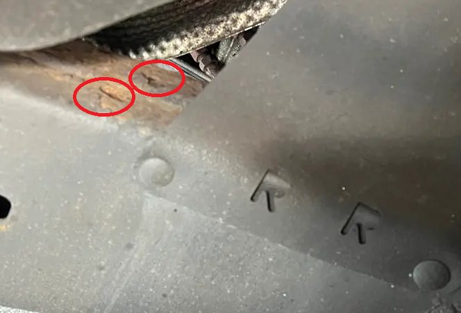

    It's got potential to be a polished turd. Lot's of cover-up on the frame with what looks like a bedliner substance. Caveat emptor.

    I see holes. Looks like they sprayed the bottom and sides of the frame but not the top. Also looks like the bottom edges of some of the body work is delaminating.

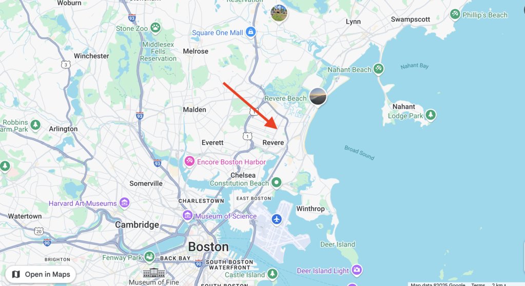

    Spent it's life in road salt winters in MA?

    This is the spot where we have been seeing frames cracking in half. 80% of the time it's on the driver's side. The other 20% is like that pic, on the passenger side.
    That frame is about to snap in half. Good eye!
    At least two spots are cleanly rotted through, to the point you could drop a dime in the slot.

    In addition to salted roads during winter, Revere MA is on the ocean. Beware of rust.

    Looks sharp but to the trained eye it looks very suspicious - good eye.

    Not my eye. But yeah, that frame is furkin' rotten
