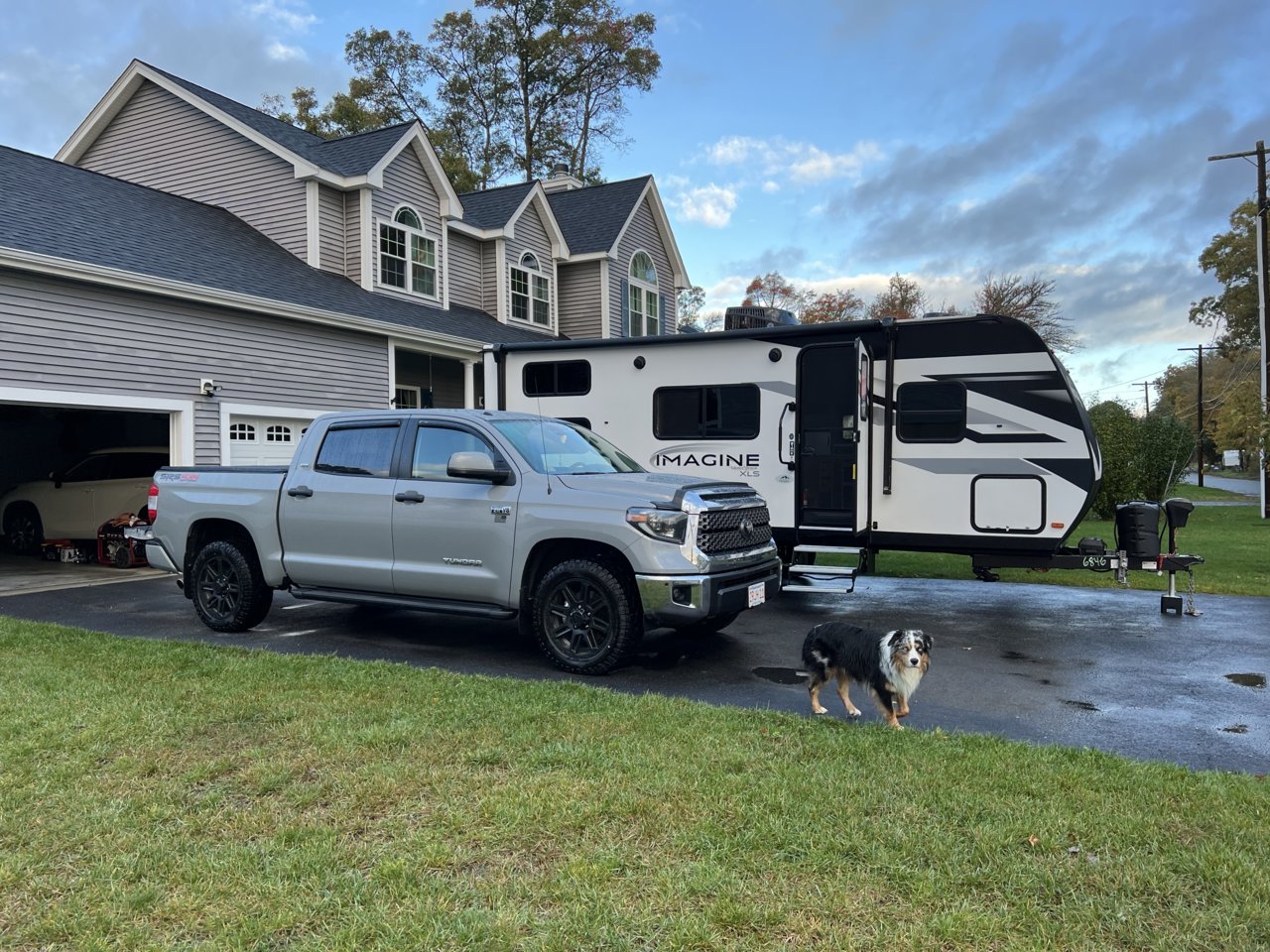

    The OP’s trailer is very similar to the specs of my Grand Design Imagine 2500RLS. I tow it with our 2018 Platinum CrewMax, with no issues. As mentioned in other responses, get a proper WDH and learn how to set it up correctly! The Equalizer is great, as is the Fast-Away. Same tech, using the flat ends of the bars’ friction to control sway.
    The dealer did not set my hitch up correctly! Read the directions and put the effort into making it right. Day and night difference…
    Recommend upgrading the tires on your trailer. They (almost) all come with junk to cut cost. I pulled the originals off my 2021 trailer and replaced with Goodyear Endurance, and went up one size (+3/4” diameter) to get into an “E” range tire instead of a “D”. This also made a huge stability difference!
    My Tundra hauls our last trailer with no issues. Wind isn’t a huge factor here in western Oregon, but we have a ton of hills. I tow in S4, and will downshift as needed on descents. Make sure your brake controller is adjusted properly, and it’ll stop quite nicely.
    Our last tow rig was a 2005 GMC Yukon XL 2500 with a 6.0L gas motor. Same chassis and drivetrain as the 3/4-ton Chevy and GMC gas trucks. Everything related to towing is better with this half-ton Toyota than our last rig.
    I can’t even imagine how poor the 1500 GM rigs would be…
    Truth be told, all of our towing with the Tundra was with stock suspension. We are headed for a 300 mile trip this weekend, and I just installed a new suspension with ADS shocks and Deaver leaf springs. Ive already readjusted my hitch system for the new truck height, and it seems to be extremely stable on the short test drive after setup. I foresee no issues, and only good things from this new arrangement.
