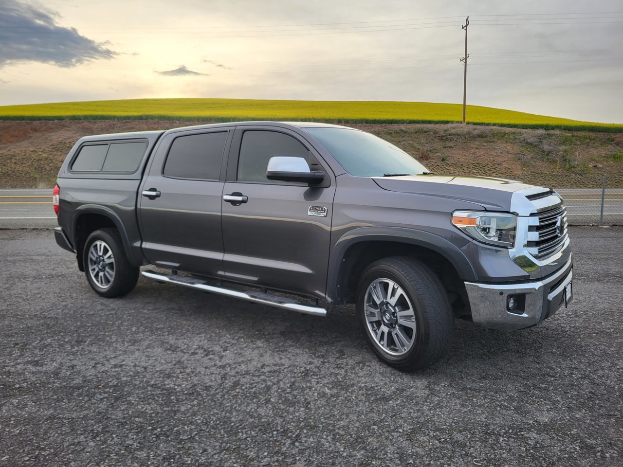

    I brought home a clean 2021 1794 Edition that spent its life in Texas. 45k miles.
    I've already got Bilstein 5100 shocks, 17x8.5 rims, and 285/70R17 tires ready to install next week.
    Curious about what maintenance or mods are crucial for keeping this truck happy and reliable.
    I am planning on tons of mods to make it more capable in the woods, but want to address any known weaknesses.

    OP your truck looks great. what kind of a bed cap is that?
